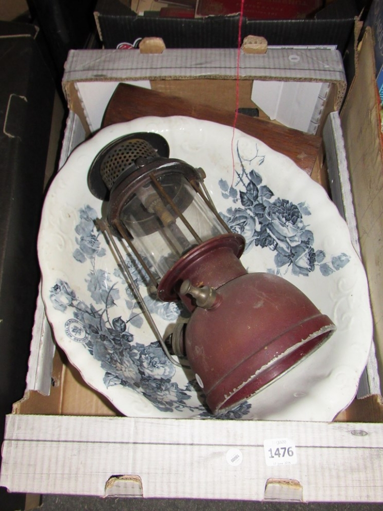

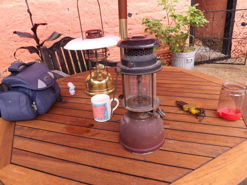

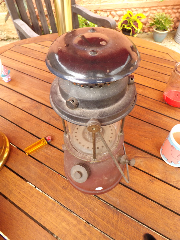

    I'm thinking about buying this, can anybody Id it please? Also, what am I looking at to restore and get it running? Is that an alloy tank?
  2. Scouter Bill
    Scouter Bill Subscriber
    Apr 30, 2015
    173
    Looks to me to be a Bialaddin 300x
  3. robgil
    Apr 9, 2016
    34
    I was thinking it might be, did they have alloy tanks?
  4. David Shouksmith
    Yes, a Bialaddin 300X from the late 40s or early 50s, judging by the colour - burgundy tank and red hat.
    Without actually dismantling it, it's impossible to say what it needs to get it running. Budget on having to buy a new vapouriser and set of seals. It looks to be complete but all parts are easily available if anything's missing. They're just about the easiest of lanterns to get up and running - nothing difficult, fiddly or easily broken in there, just good, solid, British (over-)engineering. :thumbup:
    It will have a brass tank. What you see around the base is typical and is some sort of tinning.
    If I was just starting out, I'd buy it as long as the price was right. Hope that helps...

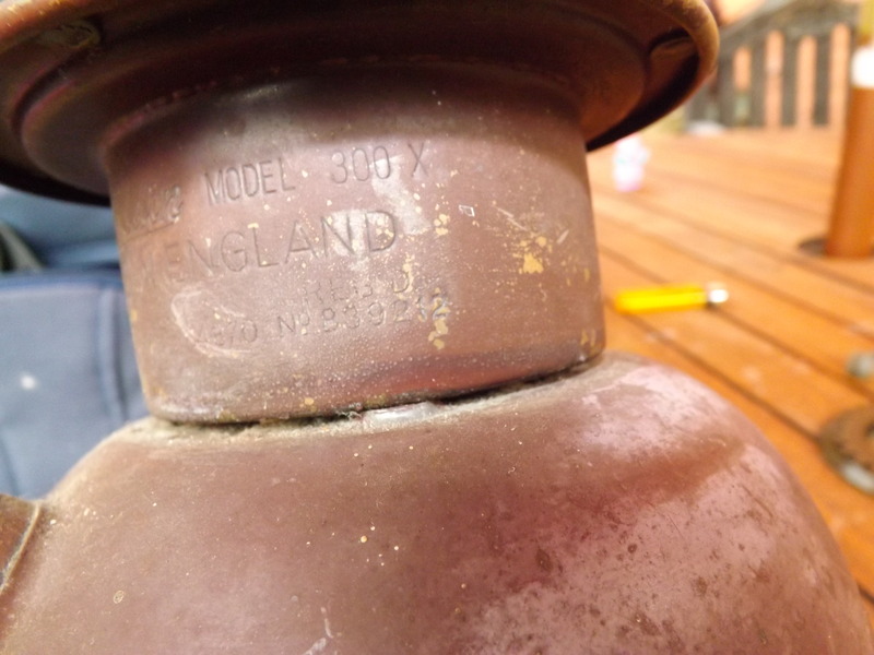

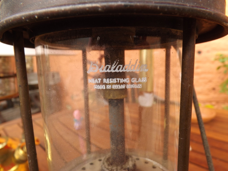

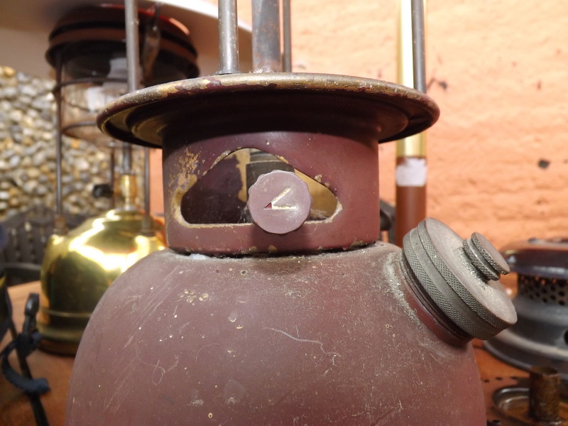

    Just a thought, is this a Vapalux 300x rather than a bialaddin 300x?
  16. David Shouksmith
    Bialaddin between 1946 and 1968...
  17. robgil
    Apr 9, 2016
    34

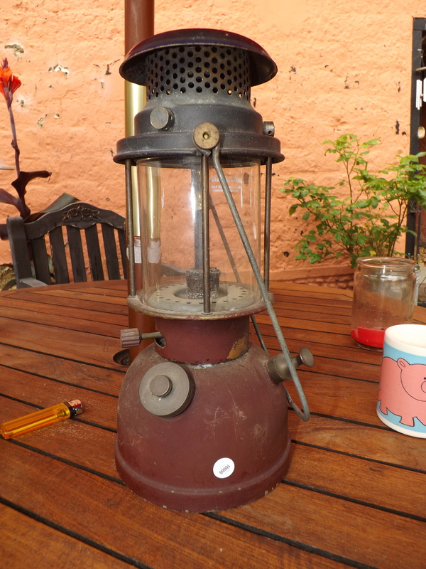

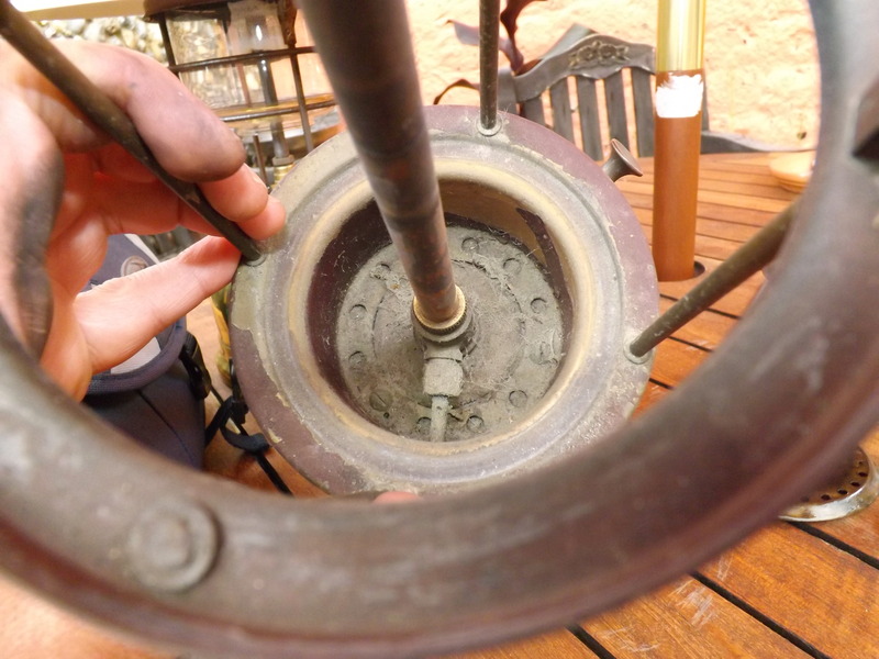

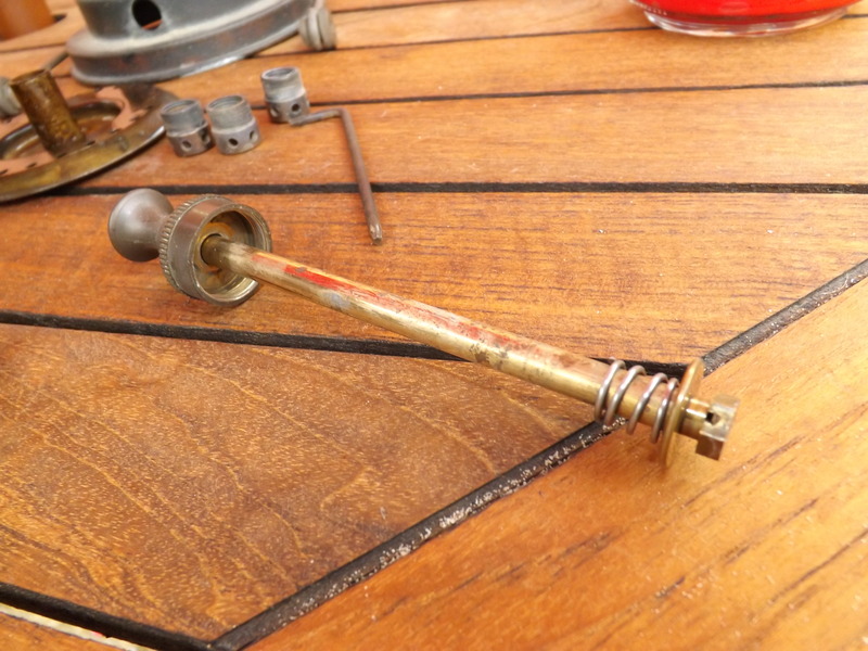

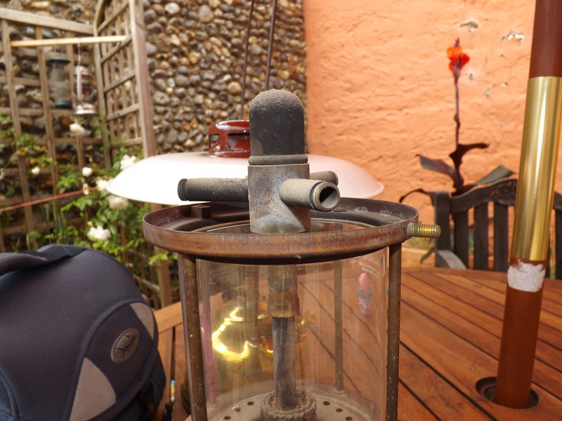

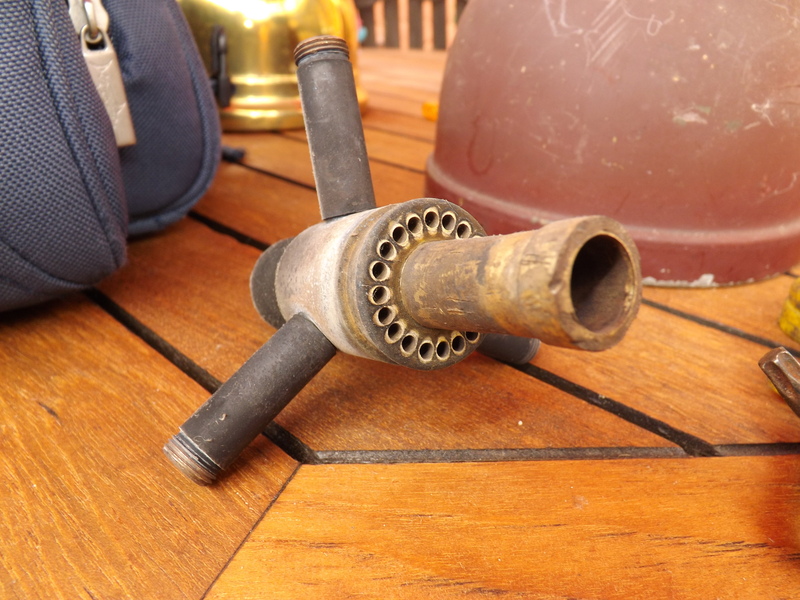

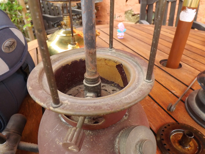

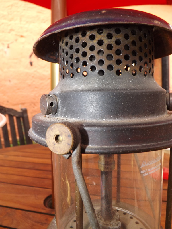

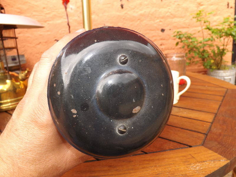

    Cool, its home.
    It looks to be in great shape, the top is in really good condition, vaporiser looks good, I can see the pricking needle popping up when I turn the cock, no dents anywhere, it hasn't been used for quite some time.
    Inside the tank is a mess, the pump leather cup fell apart when I touched it, I quickly disposed of the pre heater wick, the burner looks Ok but some parts were loose so I tightened them back up.
    Glass is all Ok, control cock is stiff.
    So, I'll strip it down completely and give it a good clean to get a better idea of what it needs, but so far I'm looking at a new wick, seals, pump cup (will a tilley fit?) and a mantel, with a bit of luck the vaporiser will be Ok.
    The paint might be saved if I'm lucky, I'll try some car polish, if not it shouldn't be too hard to repaint it. The brass should clean up nicely.
    Any tips on cleaning out the tank?
    I'll post some pics up when they load up to photobucket.
    Oh, and the bowl is indeed from the hotel mentioned above, its also in pretty good shape.
  18. robgil
    Apr 9, 2016
    34
  19. David Shouksmith
    That red hat is awfully black! Still, no matter if it's in good order. The lantern looks pretty good all round - well done! :thumbup:
    Ooh, Photobucket... :-$ [-X

    Nice original patina. A repaint? It's your lamp.

    I'd start by giving that tank a good T-cut. It's fairly quick and you may be pleased with the results. If not you can then repaint.
  22. robgil
    Apr 9, 2016
    34
    I have some Autoglym Super Resin Polish so I'll give that a whirl, it is very badly oxidised, after washing in soapy water it came out pink.

    One thing I did notice in an online book was the pump and filler cap left unpainted, which is why I thought it might be a Vapalux.

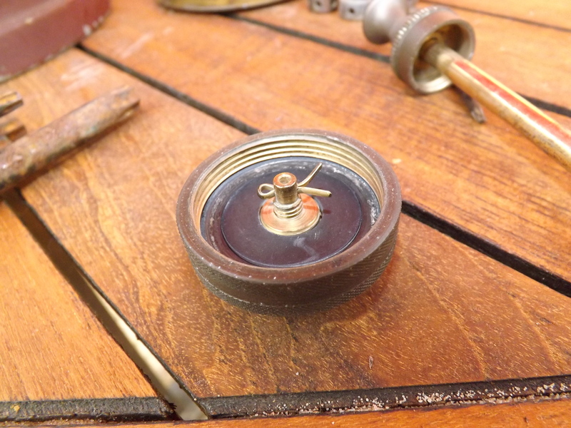

    Does this have a large or small filler cap?
  28. David Shouksmith
    That's a large one (inch and a quarter) as opposed to a small one (1")...

    Cool , thank you. I'm still cleaning it up but it will need a rebuild kit.
    The paint is badly worn , but its staying, its an old lamp and I quite like it looking like an old lamp. The brass cleaned up Ok but its going to be an outdoor lamp for the garden so that will soon dull down again, I have to say it is starting to look rather nice. :D/
