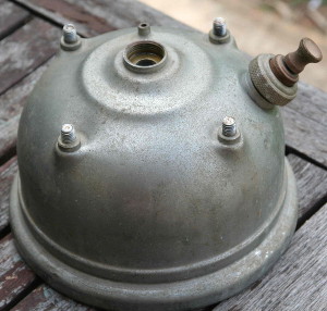

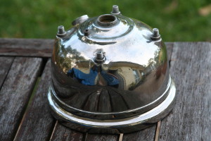

G'day all, On this site, I have seen many fine examples of members breathing new life into their old brass and chrome lamp bits and pieces. For me it's very therapeutic - I know many find it tedious. This fount has just finished stage one of polishing. I washed the fount in warm soapy water. I then used a small amount of paint thinners in conjunction with a large steel wool ball to remove the lacquer. I then used a brown buffing compound with a sisal wheel for the first stage of polishing. You have to be careful with the brown compound and sisal wheel as the two combined will 'cut'. I use this combination as it helps to remove scratches etc. The wheels are used on tapered spindles attached to a bench grinder/polisher. I find variable speed bench polishers to be very useful. For the 2nd stage of polishing I will be using a stitched cloth wheel and green compound. Whilst this combination will cut I can polish an apple without removing the skin so it's very minimal, if done well. For the third stage (doubtful it will be needed) I will be using a white compound with an unstiched cloth wheel. There is no cut involved in this stage, it's just a matter of how brilliant you wish the end result. The white compound, if used, is useful for removing any fine films of compound left over from the previous polishing. The white compound is non greasy and wont remain on the object polished. Usually I just use metho to wipe the polished object over to remove any film that even the eye can't see. There is a black compound that is like using emery sandpaper. It will cut much harsher and is very useful for getting deeper scratches out. Using a combination of a bench polisher and a non woven nylon wheel makes cleaning rusty bits so much easier. If done correctly, there is little evidence left on the exposed metal, of a nylon wheel being used. In fact, it makes the perfect surface for undercoat to adhere to. Using the nylon wheel makes it very easy to removed baked enamel as well as rust. No toxic chemicals like paint stripper needed. Further, there is no need to manually use harsh wire brushing or sandpapering. Lacquer removal remains problematic as it gums up about anything. I much prefer to use thinners and remove it with stainless steel wool and a rag.
Hi Jeff. I have been taking so much from this site and asking a lot of questions and hoped by posting about the polishing it would be of some use to some others. This topic isn't meant to show off 'my' shiny fount. It's more to highlight how good a job can be done at virtually no risk to the fount. I started polishing brass by hand. After needing several finger transplants followed by a couple of entire hand transplants I had to find a better way. (Obviously, tongue in cheek) Reading through topics I get the distinct feeling that quite a few members believe that polishing brass founts may somehow weaken them. I would hope that perhaps I can help ease fears that you are removing layers of brass that then weakens the fount. Obviously being a pressurised vessel any weakening would of course be a bad idea. It would best be thought of that, rather than polishing the brass itself, 99% of it is actually buffing the layers above the brass and that buffing removes those layers of grime/oxidation exposing the brass. Technique comes into it too. Like when using most power tools, you let the tool do the work. If you use too much pressure, sure you are going to remove the layers of grime and then be buffing away at the brass or whatever surface you are working on. Still, if you left cloth constantly spinning against brass, I wouldn't stand around hoping to see what the result is - I'd suggest come back in monthly intervals and have a look. Of course with this fount I wasn't exposing brass, I was exposing the chrome plate. I don't know how long it would have taken by hand to buff the fount but using the bench polisher took 10 minutes - if that.
