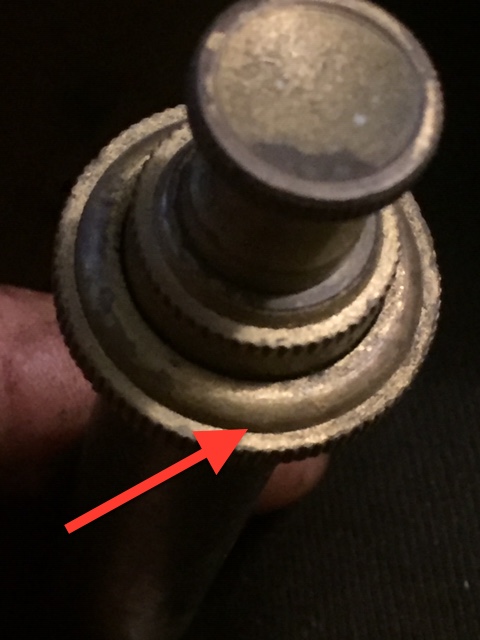

    I recently brought a Porkpie Table Lamp and noticed that the pump where your fingers hold to screw the pump into the tank had an unusual pattern/knurling compared to my other porkpie table lamps.
    I have had 15 plus porkpie table lamps and have never ever seen this type of pump before in a porkpie. Can anyone shed some light about this pump and if you have ever seen one before.
    I also noticed that the burner had square nuts with the springs on the inside of the gallery, but I’m more interested if the porks come out with this pump or is it a Frankie....
    Regards
    Darren

    I've not seen that pattern of knurling before. Could it have been re-machined after being damaged by pliers or the like?

    Vic said its an original on the very early Tilley porkpie table lamps. The pattern looks to perfect to be a home job and quite an unusual pattern.
    Thought I would check in to see who else has seen one of these.

    I have not seen that knurling before either.
    It looks to have a more gradual curve here too.
    I wouldn't call it a frankie.
    It is a pork pie pump no matter what.
    I too will be eager to see if there are others out there.

    What I can see is uneven spacing/angle and shape of grooves which lead me to think it has been worn or damaged and grooves have been filed by hand to restore some grip.

    It looks original, though there does appear to be some unevenness to the slots. That said, could still perhaps be a very early incarnation. It’ll be interesting to see where this thread goes.

    My guess would be that it's a Tilley innovation that didn't last long. Knowing them, the benefits (easier to grip and turn) would have found to have been out-weighed by the cost. Just my two penn'orth...

    I wasn't suggesting this type of knurling was to be found on an early version only - Tilley were always trying new things at various times during production. I imagine someone came up with the idea, they tried it for a short while and found it wasn't economically worthwhile so reverted to the tried and tested knurling.
    In any case, catalogues often used earlier artwork and pumps can be changed about. It's probably one of those Tilley mysteries we'll never get to the bottom of...

    Its not a Frankie. I'm with @Graham P .
    The original knurling had been worn or damaged by pliers or vice grips.. Someone just conveniently filed some grooves on it.

    Just from a practical view, by hand, I tried to cut a knurling into a damaged pump rim, after skimming it in a lathe, and I couldn’t get anywhere near the accuracy or the look that this example has. Again I must point out I’m a novice and my skills aren’t great. A more skilled artisan could do it, no worries, but all that expert work for a lantern pump?
    So I’m leaning towards it’s an original little used Tilley style of knurling.

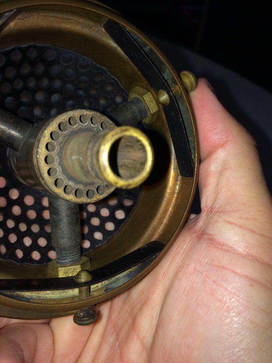

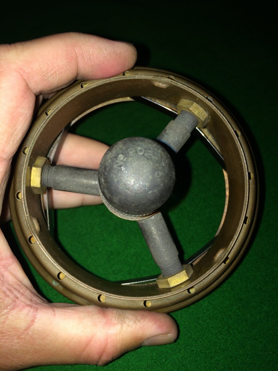

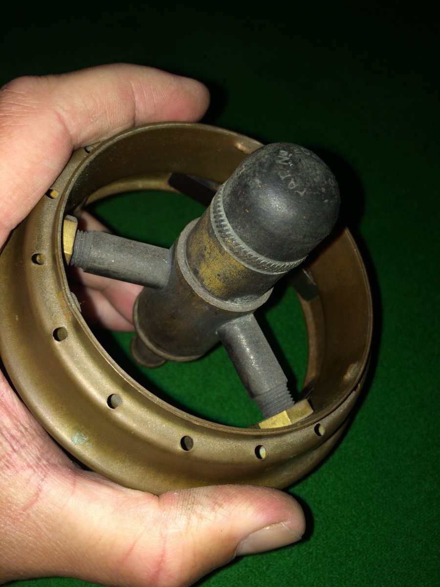

  18. Kiwiboy00
    Jun 23, 2018
    255
    Gold Coast, Australia

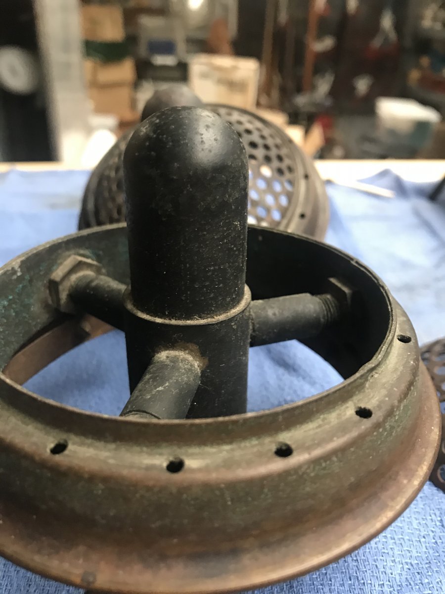

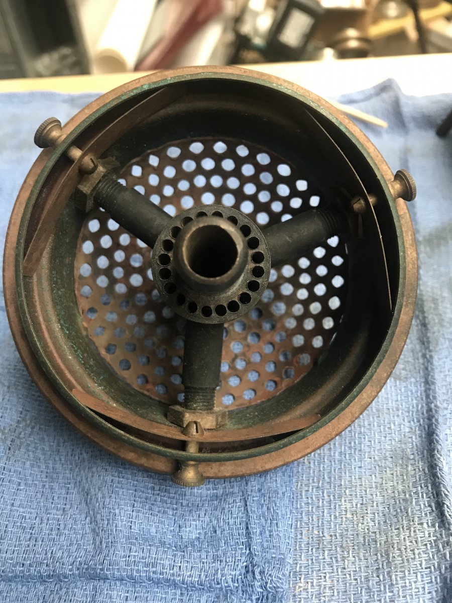

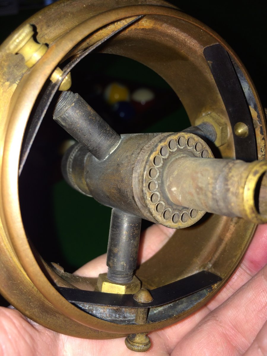

    AC75A87A-BE27-4F64-8092-D1D6F3FCA364.jpeg 8B93C7FC-278E-4D59-878C-78C07F04F372.jpeg ECBBF4CF-F6AC-4A46-95C1-A63594CB292C.jpeg 70A77DEF-1824-4087-9FE3-1F3910C97AA6.jpeg This is the burner that come with this pump on the porkpie. Looks like this was a really early model of pork. Might explain the pump maybe ?
  19. Tony Press
    11,056
    Darren
    I’ve checked all my Kayen and Tilley pumps and none like that one of yours. But now I want one...
    I think your Gallery might be the same as these:
    Note the mixing tube without a knurled ring:
    @Kiwiboy00

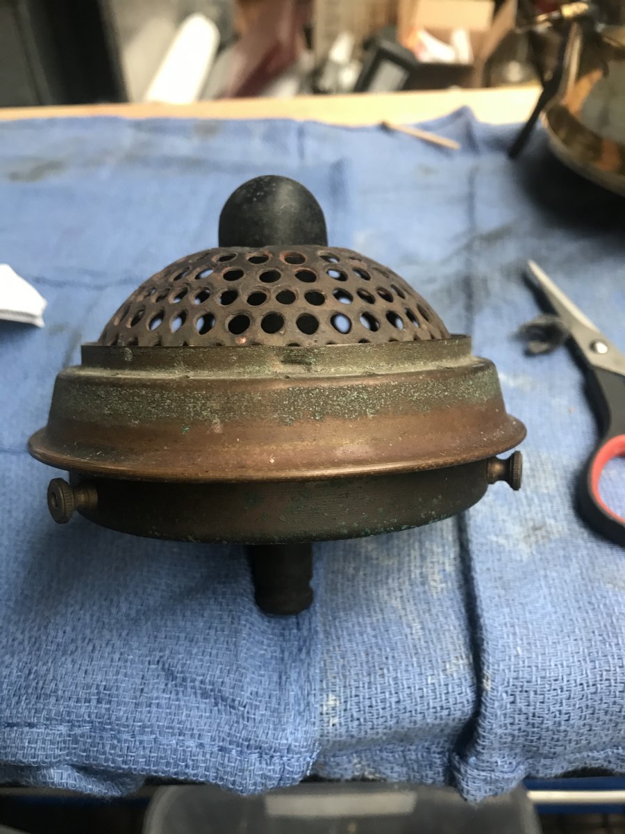

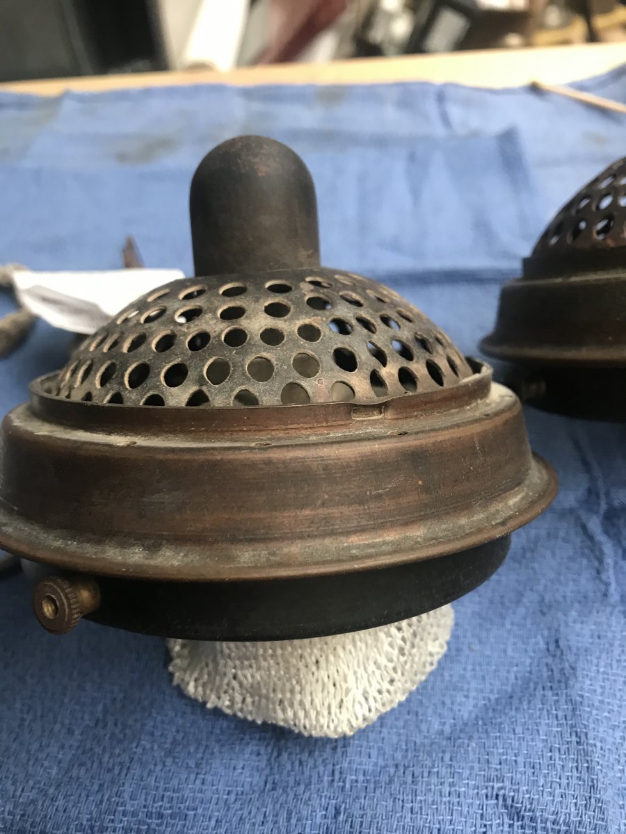

  20. Kiwiboy00
    Jun 23, 2018
    255

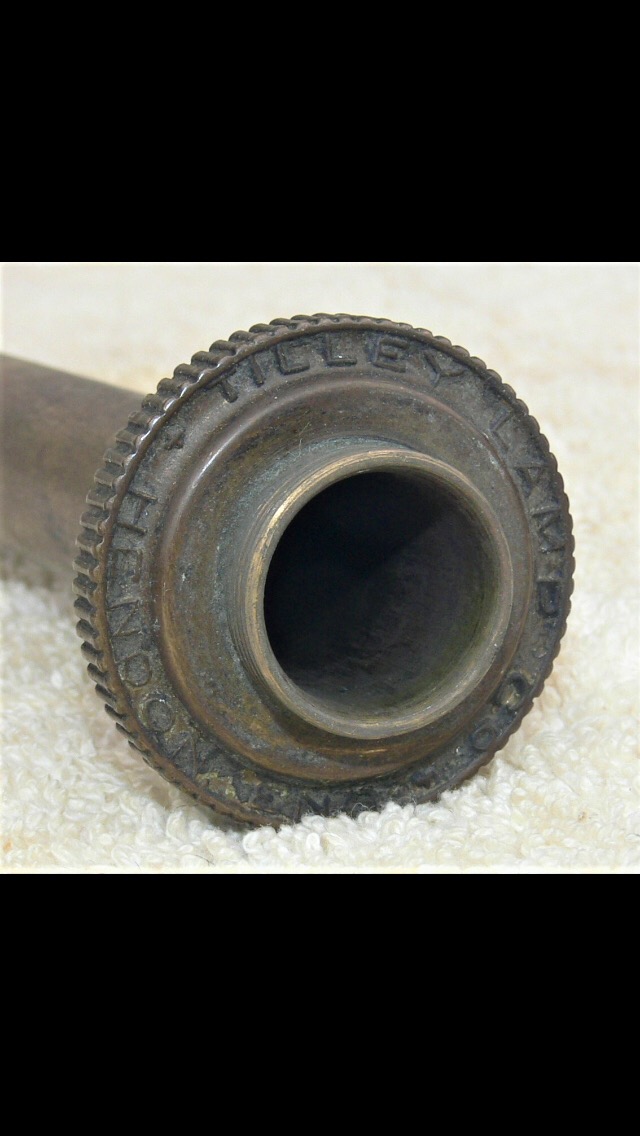

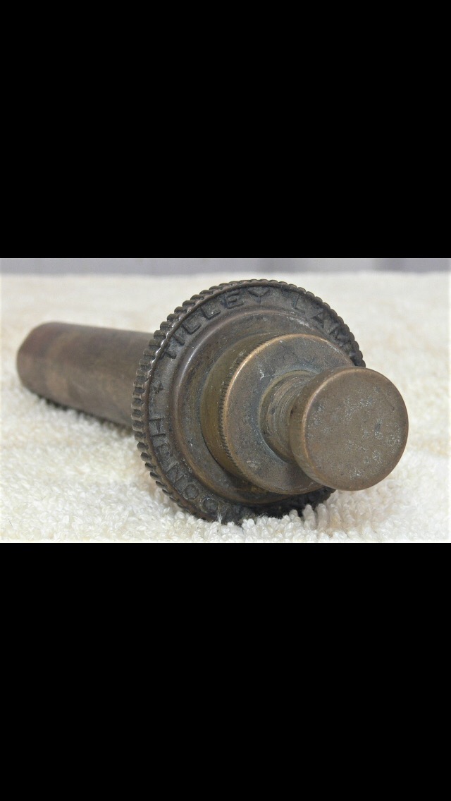

    Thanks Tony have you seen pumps like these before ?
    Also Vic was saying that this burner is a Tilley Burner not Kayen. Still im very interested what Tilley Pump i have on my above first post or what Tilley Lamp it belongs to.
    Darren

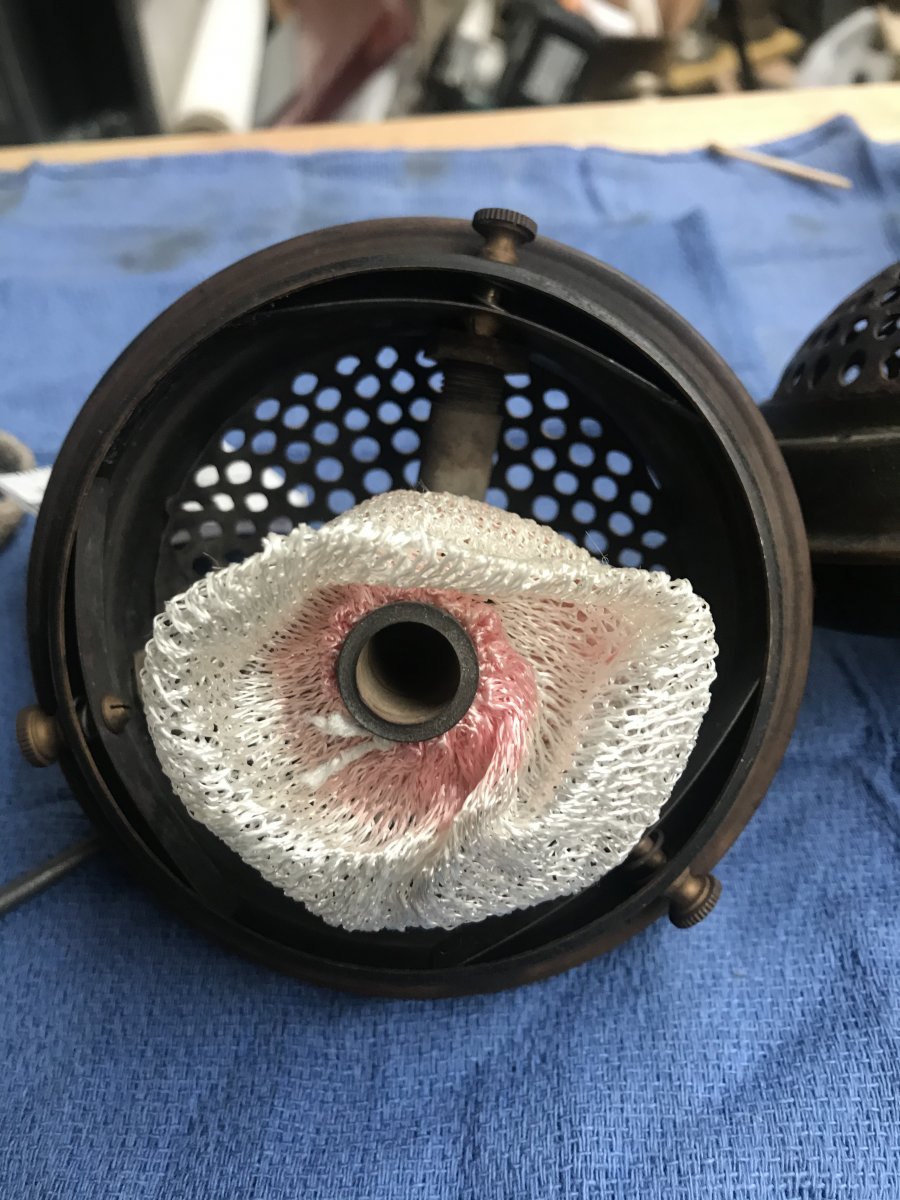

  21. Kiwiboy00
    Jun 23, 2018
    255

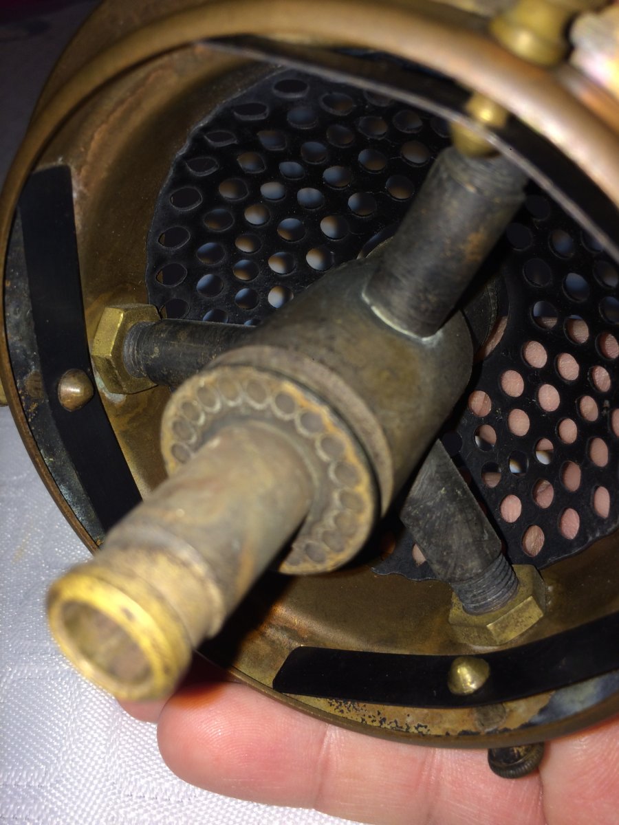

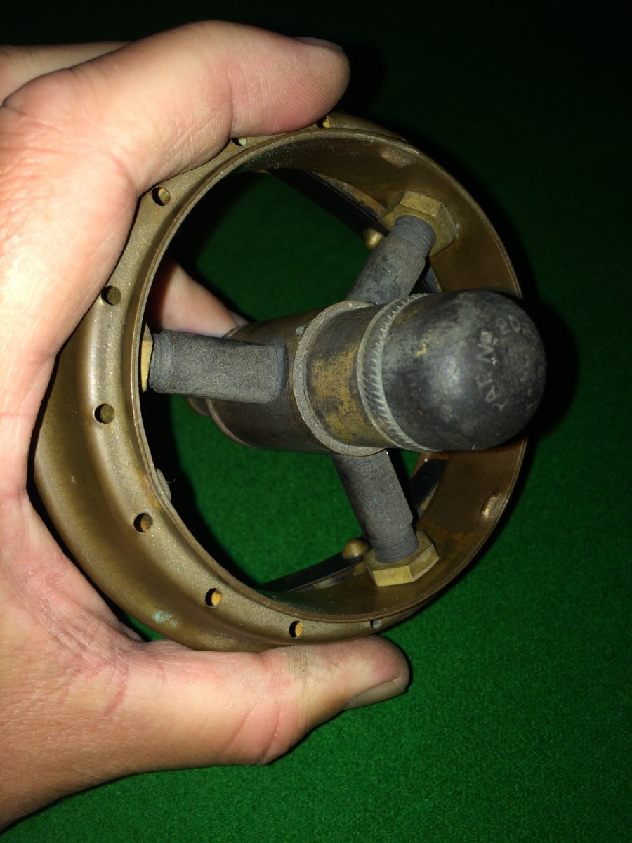

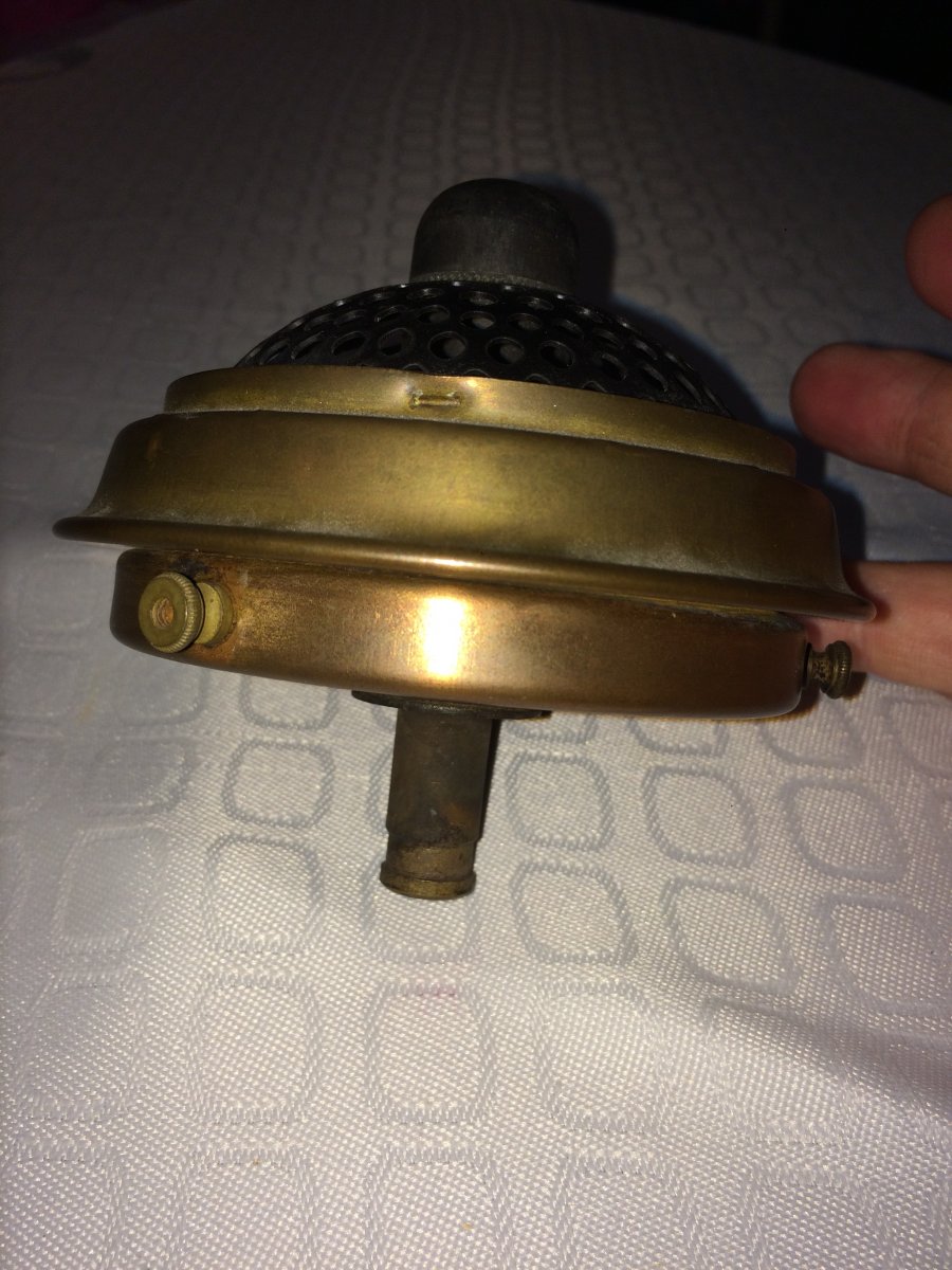

    This is my Tilley burner with the dome removed. This was with the pump in question. Surely someone has a pump like the one i have.
    It must be off a particular model of Tilley just not that common.
    Darren

  22. Kiwiboy00
    Jun 23, 2018
    255
    Tony if you notice the pins on this gallery are not split like the Kayen pins are. And the nuts have never been changed.
  23. Tony Press
    11,056
    That’s a Tilley burner. Given the discussion above, I would think that, if as seems likely, it is a short-lived Tilley pump, it’s off an early X246, so probably original to your pork pie model.

    That bug screen dome shaped thing is nice !
  25. Tony Press
    11,056
    @WimVe
    The Tilley gallery insect shields* came as both flat and dome shaped. The domed ones are aesthetically pleasing.
    Kayen also made domed insect shields. There’s probably a bit of investigating to do about manufacturing and models etc. but here in Australia we can find plenty of examples on Kayen and Tilley products.
    * “Insect shield” is the term used in parts lists for these devices.
