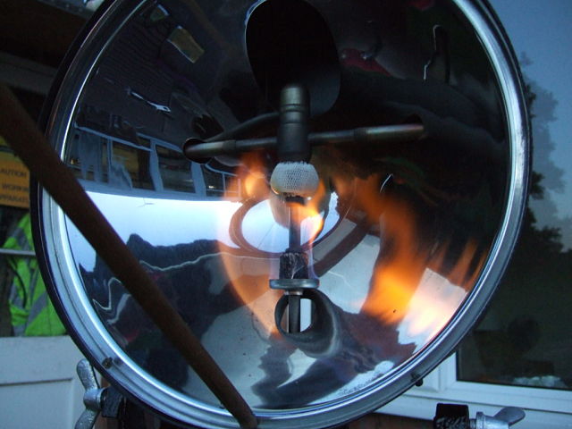

    Hi
    I make my own like the Bialaddin ones , don't get lost either cos they fit over the vapouriser :D :thumbup: have a look here :D :thumbup:
    http://0flo.com/index.php?threads/3569
    Heres one fitted to my FL-6 :D
    Stu :D
