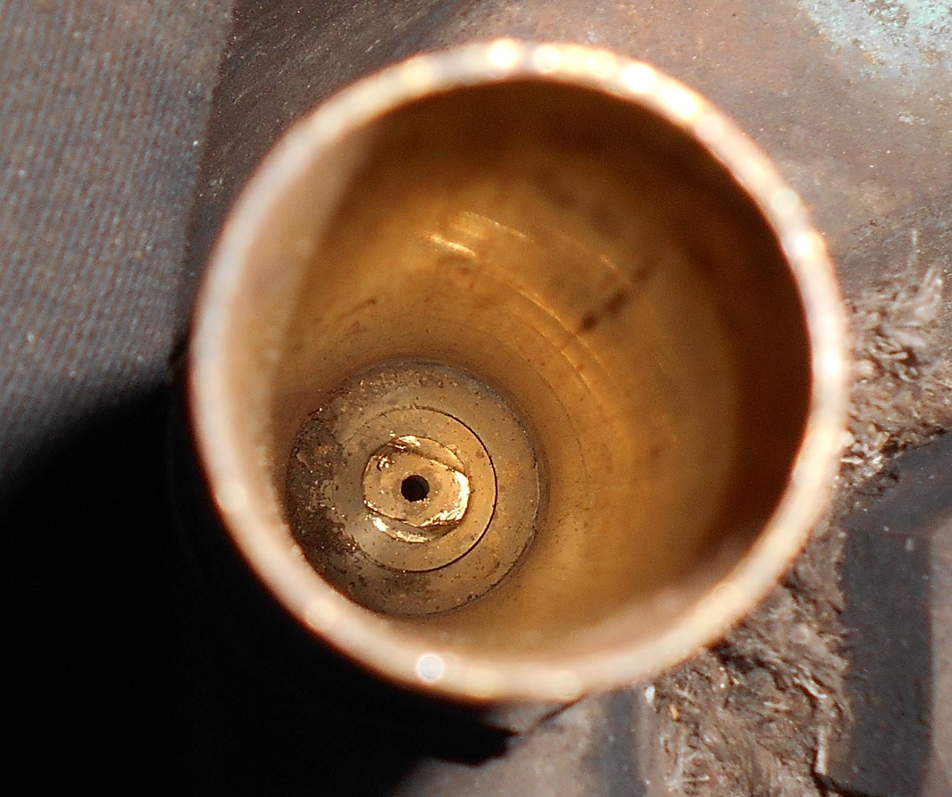

    about 30 years ago I bought several paraffin lamps /irons / stoves / blow lamps / and heaters.
    And now have decided to bring them out the attic and get them working. I am hoping someone can answer my query although it does relate to a Bladin blow lamp.
    If I pressure it there is no shut off valve so the pressure will just release through the nozzle even if not ignited, so I have to pre heat and then pressure before igniting the vapour.
    With specific regard to the `pump`when I pump it it puts pressure into the blow lamp but is the pump tube airtight or should it be, in other words is the leather washer airtight OR is the pump unit as a whole itself airtight as it does have a washer where it screws in.
    Hoping I have made this clear enough to understand.

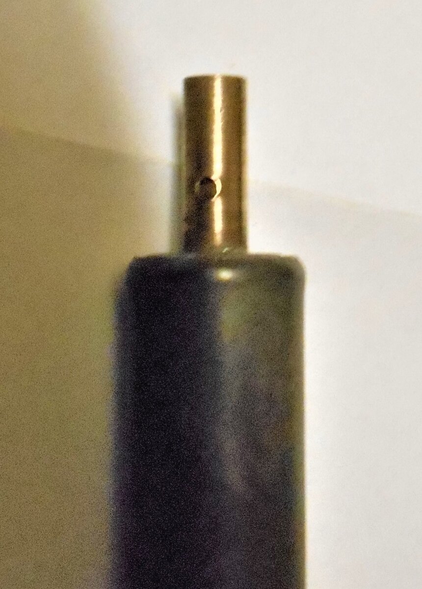

    Tested with bubbles, I would say a little leakage, I have now taken the tube out (see image) where do I go from here how do I dismantle the return valve, it appears there is a thin cap on the end, does this screw off?

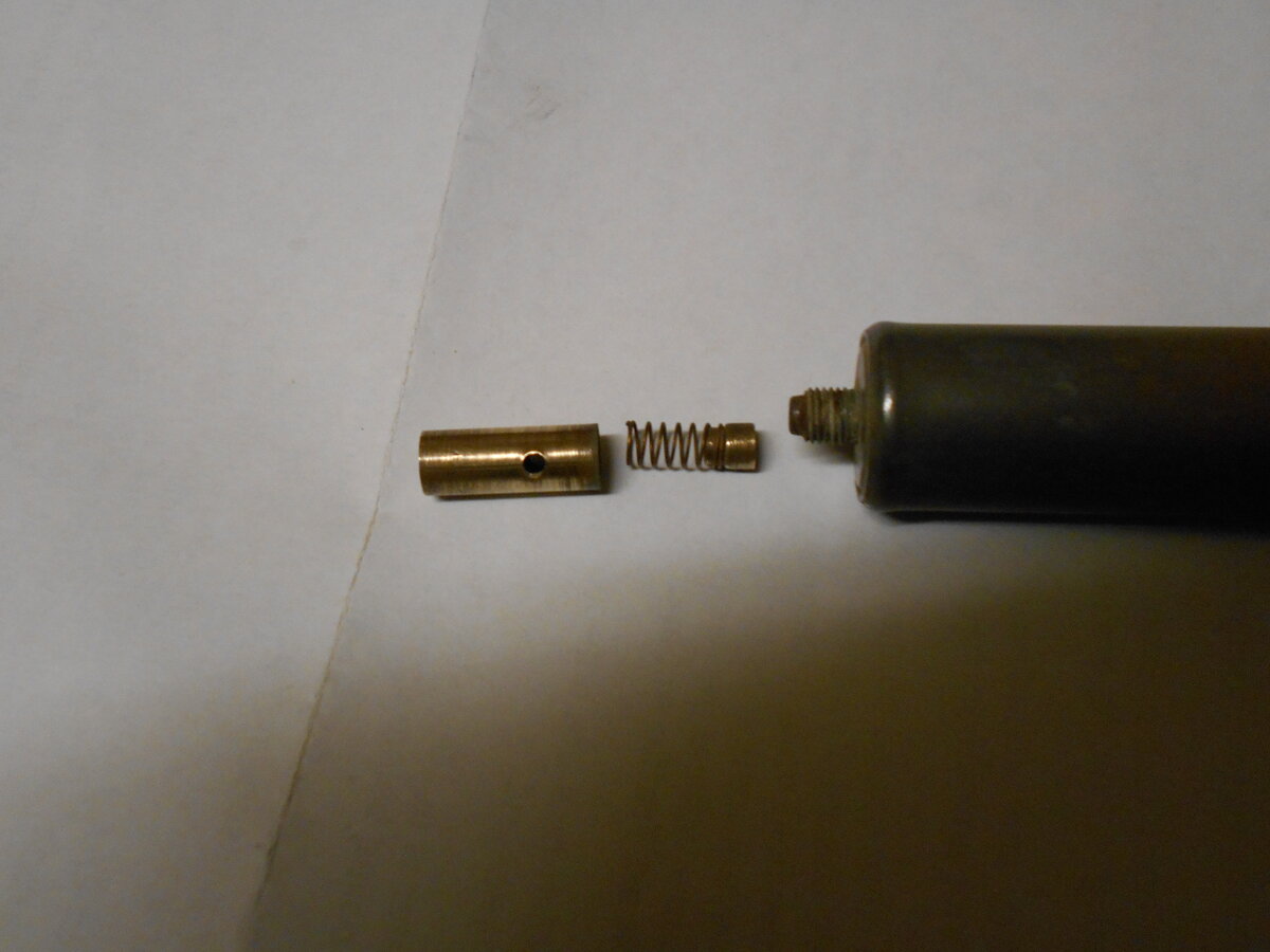

  9. Henry Plews
    3,053
    I've not seen a NRV like that before, they usually look like one or the other of these two
    Either way, they come apart and look like this, there will be a cork or rubber pip in the small brass cup on the end of the spring.
    With your example, I'd see if the end cap unscrews - it may be a bayonet fixing

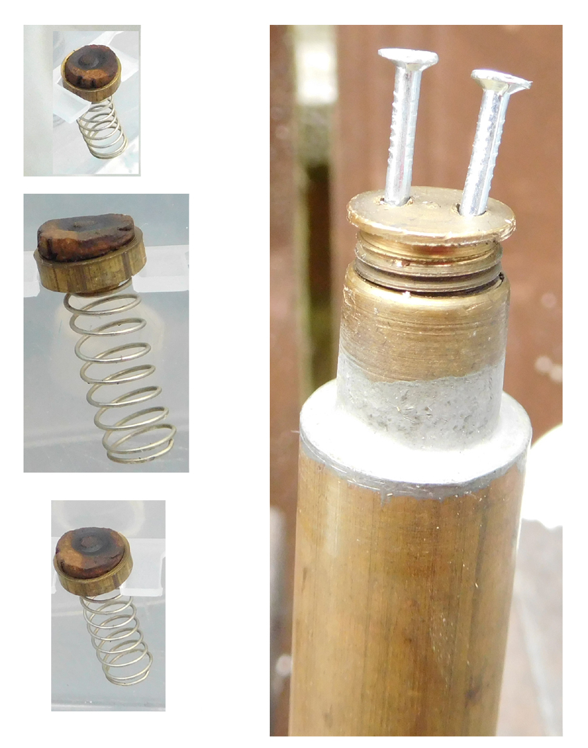

    I managed to unscrew the end cap, using a couple of nails and pliers which thankfully worked as per image.
  12. Henry Plews
    3,053
    You can either reverse the pip or smooth the existing face with fine sandpaper. The important part is to make sure that it's "square-on" in the cup. You could also stretch the spring but only a little.
