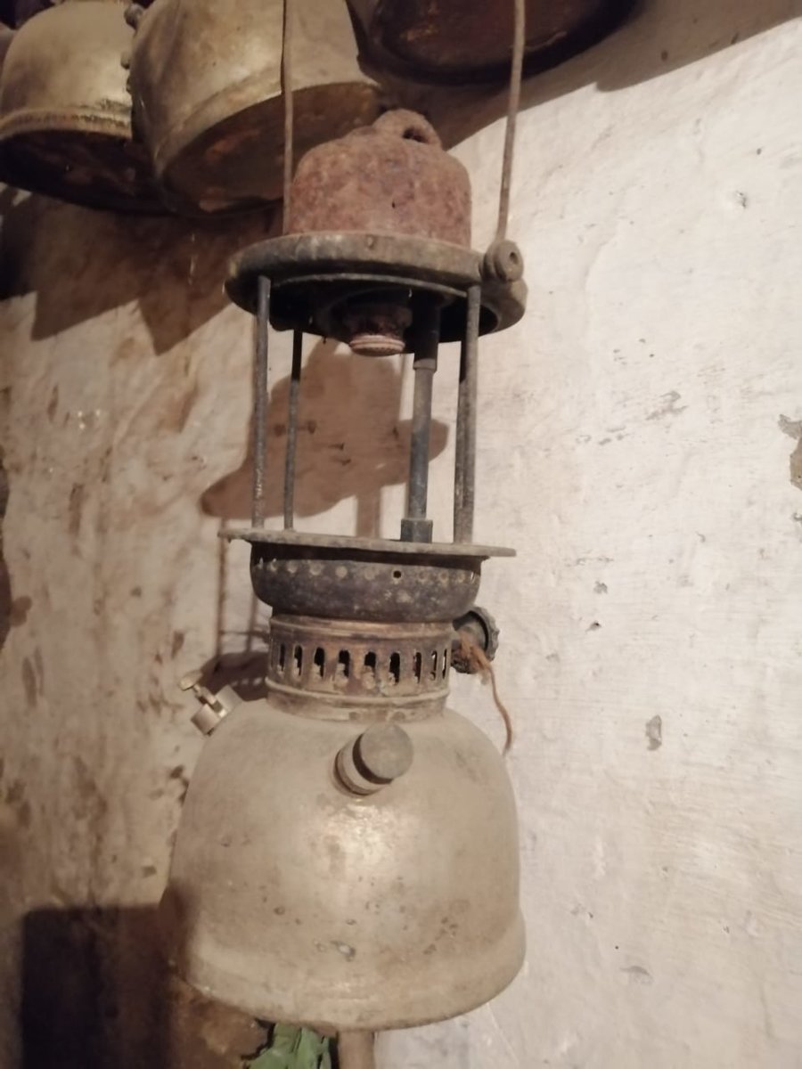

    May be my Question is very basic , Please excuse
    Pressure Tank Made out of Which material ?
    Brass / Stainless Steel / Iron Tank
    1. So for I saw Pressure Lamp ( Petromax ) made out of full Brass material, ( including Hood)
    2. Recently purchased Primus 1082 Tank made out of Brass but Hood with Tin sheet.
    Any pressure lamp is coming with Iron Tank
    Please excuse with my chilly question
