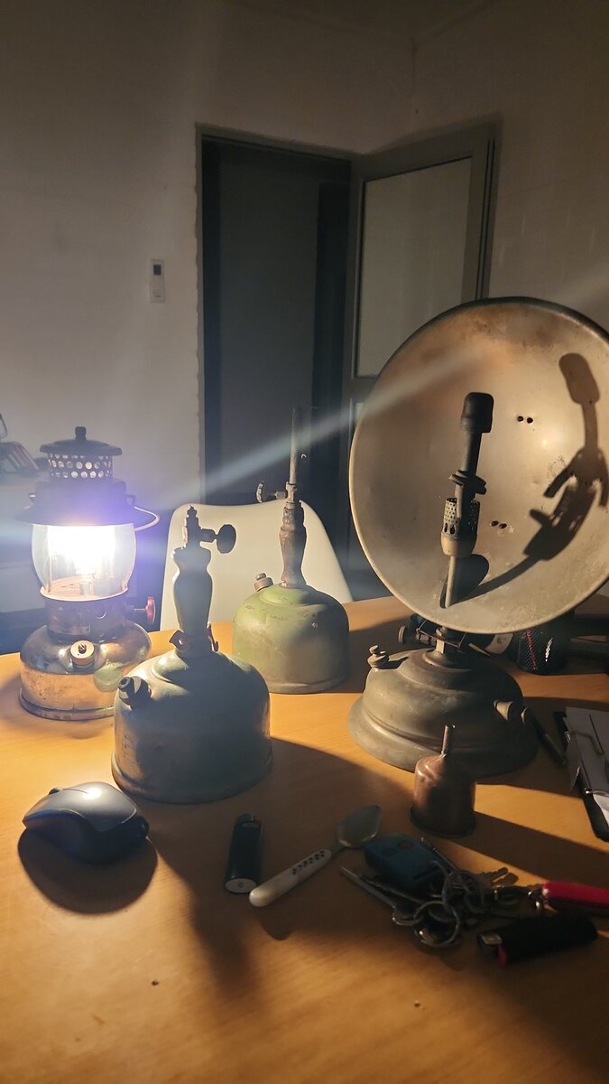

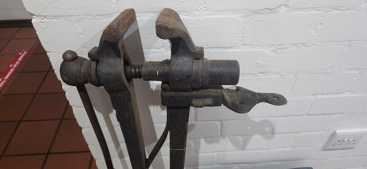

    Here A little gem found yesterday
    Was collecting the Post vice
    when this jumped out of the darkness

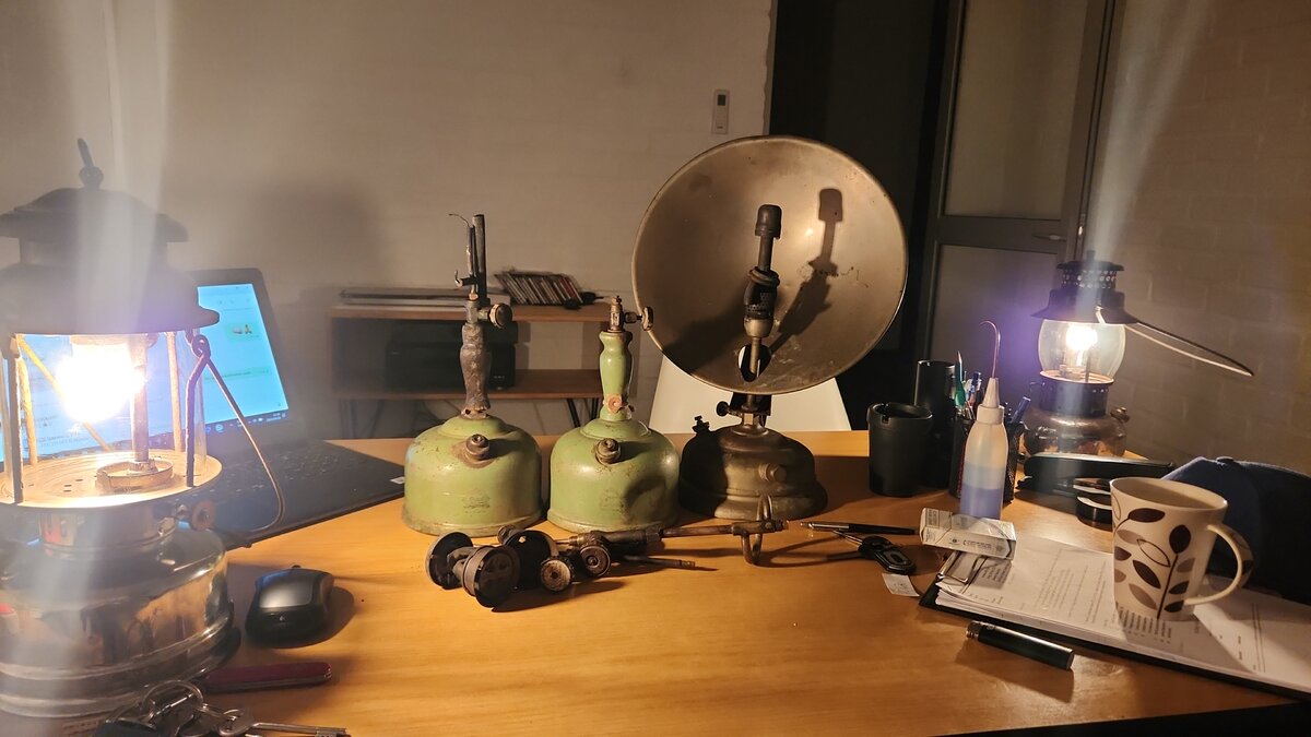

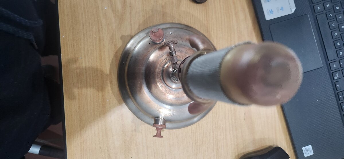

    Correct reflector orientation
    I take it the controls are behind the reflector - It seems that would keep heat on the 70 % of the fount - Saving seals etc - Breathers Parralel to the Reflector --

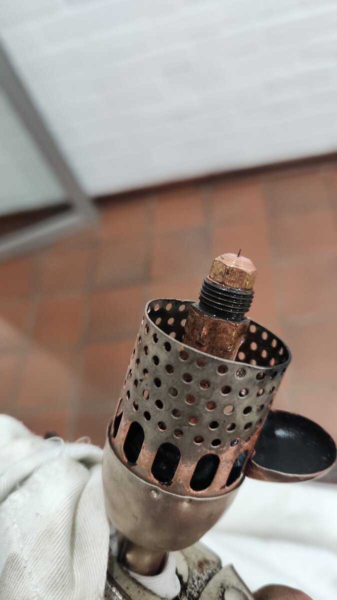

    I did some lite stripping - seems pricker is either missing or might have turned out and is stick upstairs
    Will get this in a soak this weekend

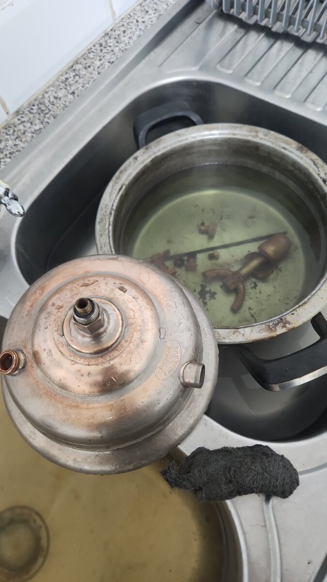

    Well a little progress

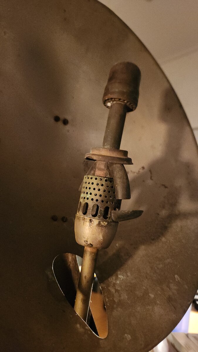

    Managed to gently remove the Burner
    This revealed a beaut of a find
    Lessons learnt from a previous Primus restore
    Go slow and use penetrating fluid - DO not force anything

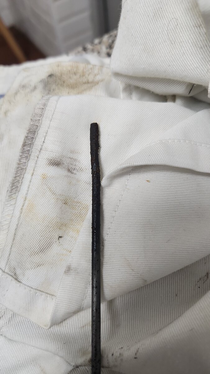

    Thankfully when I removed the Whole burner raiser stem the Pricker turned out of its raiser - I was a bit bummed when I saw no Pricker - Twas only after a good soak in citric and removing the top section of the burner that I noticed it was still stuck in the up position
    Luckily no forced movements - This would have definitely broken some of the gear down below or snapped off the seized pricker in the nozzle / jet
    So I proceeded with care

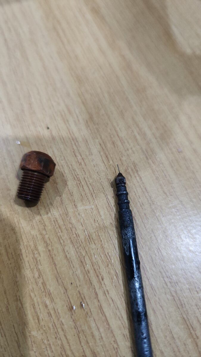

    Removed the jet with pricker in
    - More soak / a few heat and quench plus more WD40
    After what seemed a fiddly eternity shed came free
    Here a very Rusty Pricker rod - Should this not be Brass ?
    I have a spare from a 991 - Brass but to short
    I take it this lead seal should be replaced -I also want to check on thickness to position the burner tubes correctly.
    Seems the bottom is soldered to the fount - so I will leave as is

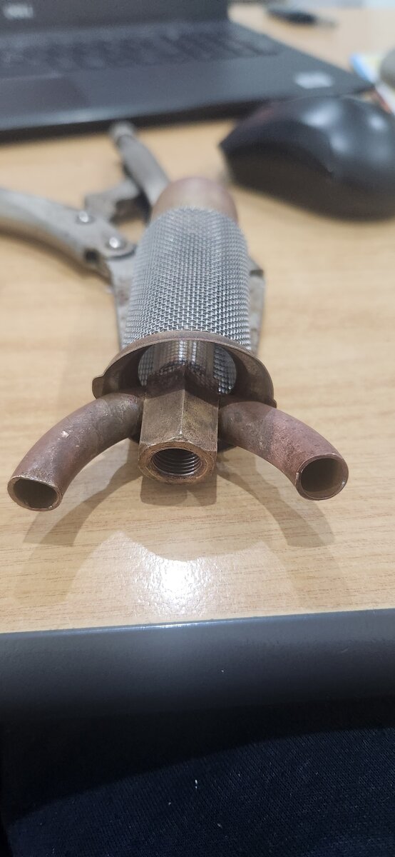

    I take it this is the correct positioning - Ie we are looking from the rear of the heater reflector - The heat projected away from filler and pump - Also being Right handed - Pump on the right
    Here I found some mesh on site - seems 1mm squares - Used some of the mesh wire for a little sewing job - Fairly happy with the result
    The right hand breather has been overnighted so flairs a little more past straight
    Must be a Male heater that bends right - No offence to and ladies
    Here the basic tight with the current lead seal at the base - - Almost a 1/4 turn to far imo
    Would like to get him sitting as such

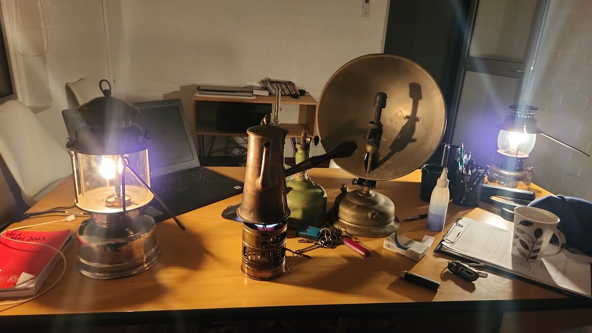

    Well
    The Fire gods made me do it
    Found the seal and Leather
    Tested the NRV after some wd40 - Seems all is good
    So here we go
    Tightened down as best as my hands would allow - Got about 10 degrees to go on the Breather tubes on alignment.
    Basic buff hand job on the reflector
    Hit with some Meths to pre heat
    And would you believe it - We have life and HEAT
    She has been hisssing away now for nearly 20 minutes
    JUST LOVE IT
    Its damn cold out here on the WEST Coast of Africa
