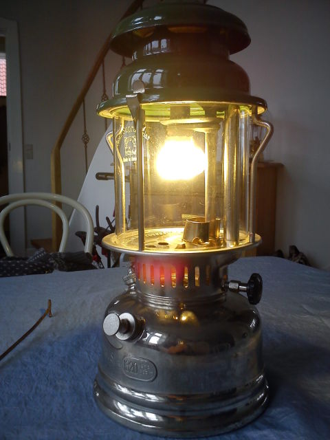

    I have a problem with my new "working"-lamp, a Primus 1320 for alkohol.
    I have never used it for longer time before (hours) but now I started.
    It burns bright and white as the sun from the start for about 15 minutes - then the mantle starts turning yellow and just glow.
    The jet and needle looks fine. The pressure is OK.
    I use 97% ethanol, butanon as fuel.
    Anyone using alkohol (for lamps) with any ideas :?:
    Claus C
    16,881
    From your description, I reckon that the vapouriser is not staying hot enough.
    Sometimes tying the mantle so that it's almost touching the vapouriser cures that problem, Jeff.
  3. Claus C
    Dec 18, 2012
    1,787
    Thanks Jeff and Doug (pt)
    I put on a new mantle while the other did point away from the vapourizer Jeff, and I didnt pump the lamp as hard as usual Doug.
    It worked and the lamp has been burning fine for app. 1,5 hour now with no problems. :thumbup:
    Thanks for insight.
    :D/

    Why is it that there apears to be a red glow around the collar between the tank and bottom of the cage is that just a reflection or.............
    Graham.
  5. Claus C
    Dec 18, 2012
    1,787
    Hi Graham
    Yes its just a reflection - looks scary :lol:
