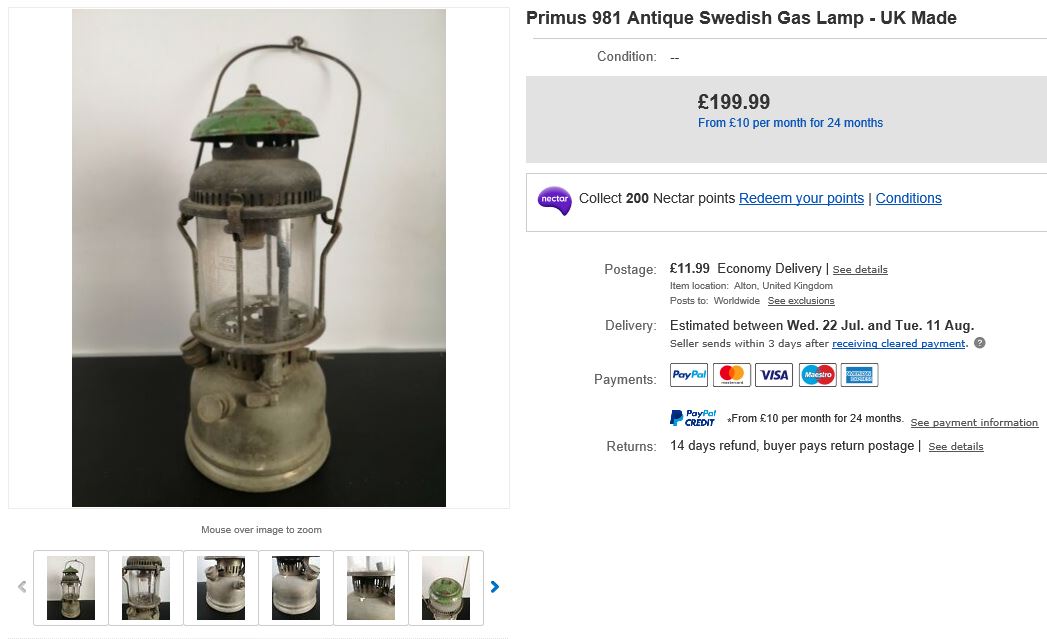

    I’m writing to report a serious case of acute Primusitis Nevralgica. A few months ago I really got fixed on getting a Primus 981 to fettle after watching a YouTube video showing a very quiet lantern, lit by a roaring torch preheater. Fell in love with it. For 6 months I’ve been watching auctions on Tradera and put bids on 3 X 981 lanterns which I’ve lost, one by one. The second I saw (pristine and unused) went for approx. £600, another around £300. In the end I Had an offer accepted for one I saw on eBay that seemed in relative good nick save a damaged middle collar and a missing Control cock wheel. Primus 981 Antique Swedish Gas Lamp - UK Made | eBay :
    Still pricey by my standards but I recently sold a few lanterns I fettled, and I don’t mind as long as the hobby (almost) pays for itself! After doing some more reading on here, I realised I could scavenge a replacement collar and a control wheel from an old 1081 and guess what I also found for sale (from Romania!)....Primus 1081 and Petromax 200 cp pressure lanterns | eBay :
    These purchases should satisfy my quest for a half decent Primus 981 in the collection, but I’ll let you know when these lamps arrive and I’ll post some photos.

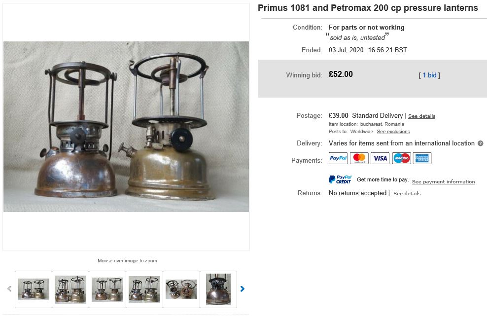

    That's pricey. I don't know whether or not, old Primus(s) are rare in general, but I could hardly find one around my area.
    Meanwhile, the Petromax is not just missing the outer hood but the inner one with the mixer tube, preheat torch and burner as well. That's an old 827 I think, and parts are not as easily found as those on 350 or 500cp units.

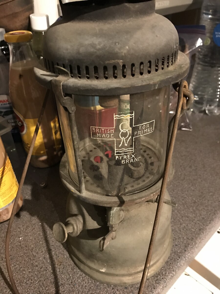

  12. Alex74
    Oct 13, 2019
    516
    Faringdon, Oxon

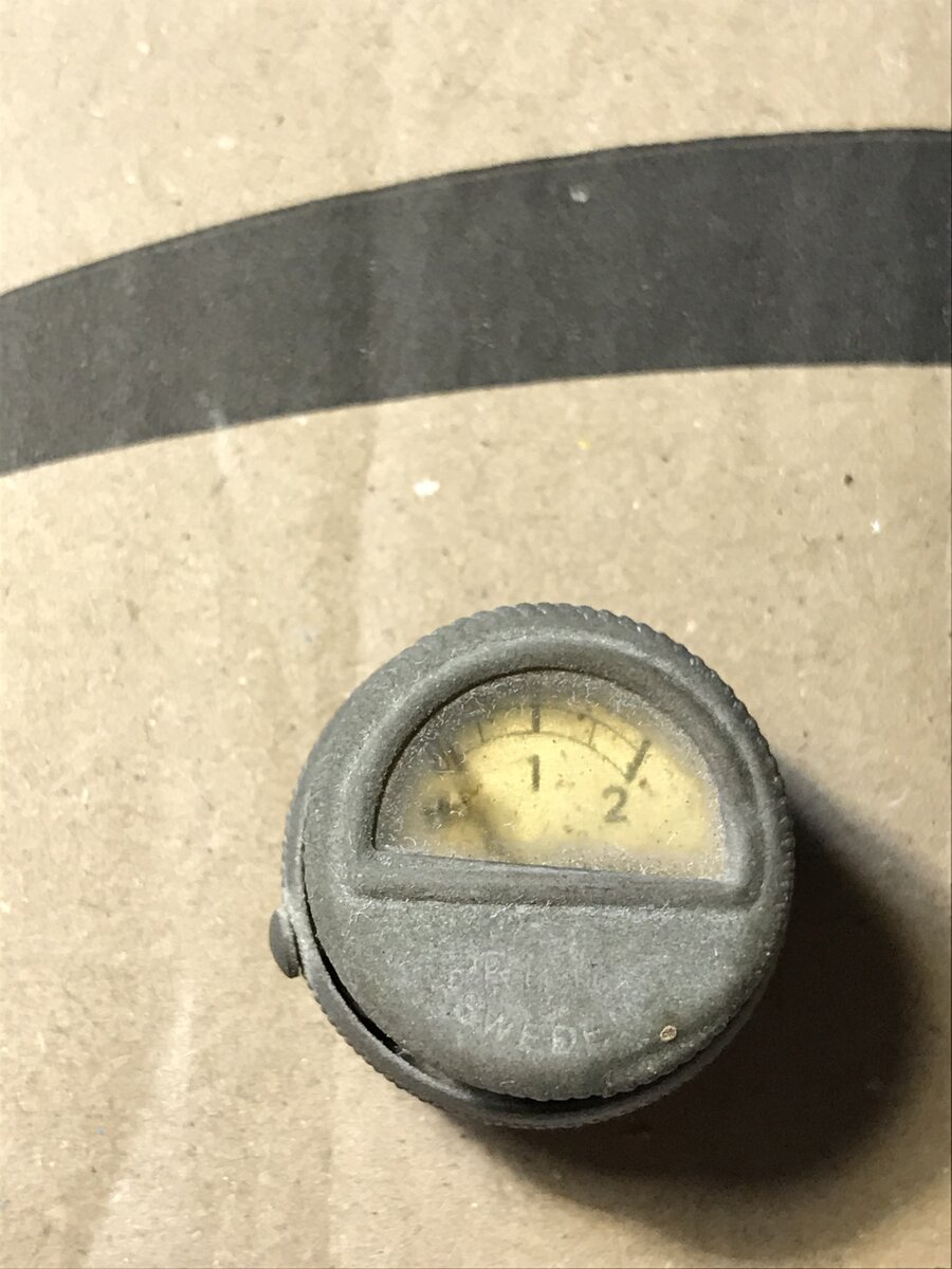

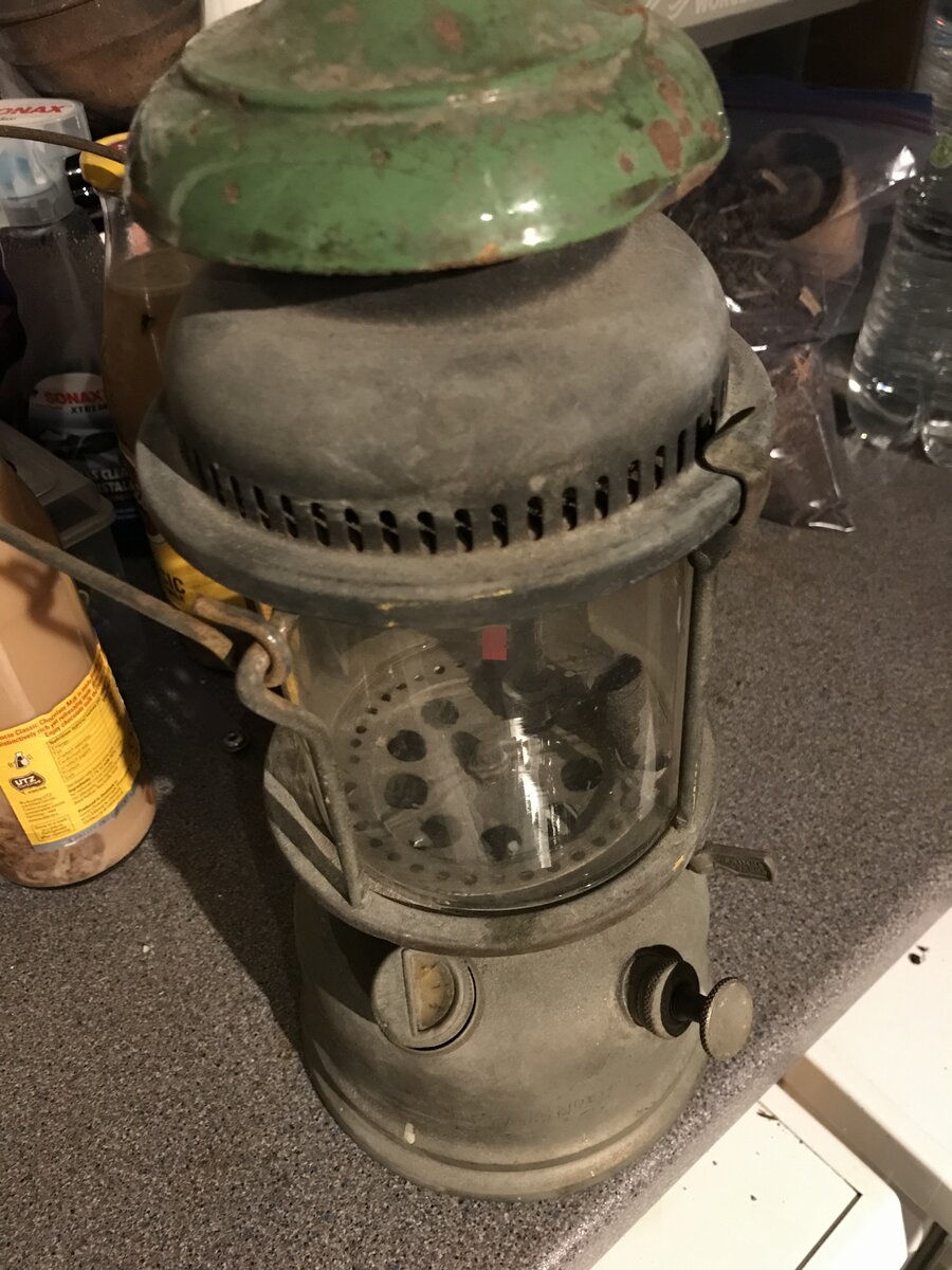

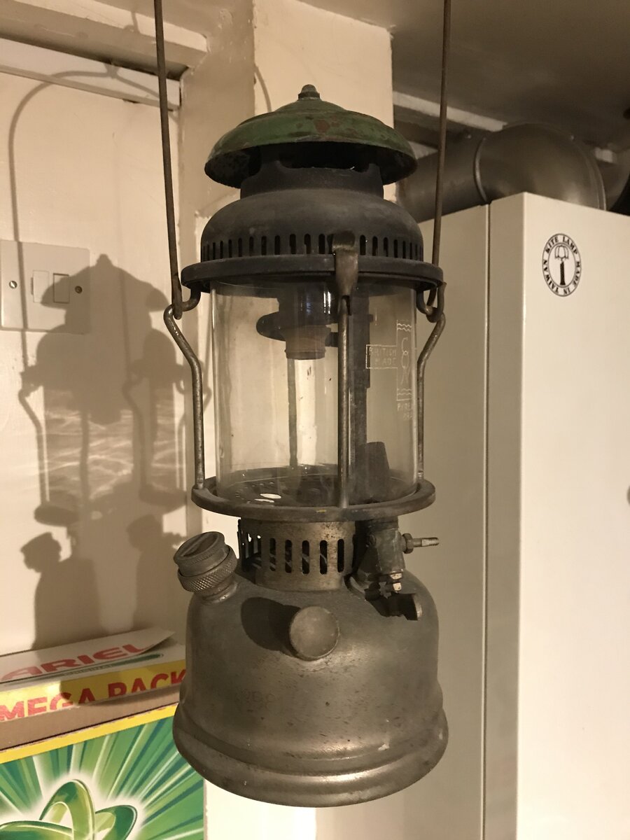

    It’s arrived....everything feels a bit seized up. The torch handle only closes/shuts halfway. The pump seems to work but it’s very stiff. After 4-5 pumps the tank pressurises a little bit...where shall I start?

  15. Nils Stephenson
    3,409
    Well the first thing is to remove the top and then the globe cage. That should be pretty straight forward. Now that I have mentioned the top, be very careful when cleaning the nickel plated part. The nickel plating on these is very thin for some reason. Just staring at it too long wears it off.
    The pump should be pretty straight forward as well. The NRV needs the right tool to get it out. It's the same as most other Swedish lamps and stoves.
    Another thing to be careful with is the lever for the quick starter. It is fitted onto a tapered shaft, so can be stuck on. I use a flat bladed screwdriver between the lever and the gland nut as a sort of wedge to get them off.
    Most things are self explanatory but if in doubt, ask.

  17. Tony Press
    Be very careful of that glass...
    That’s a great find.
  18. Tony Press
    On the issue of that glass:
    Does anyone recognise the branding on the glass? Is the “CON” for “Condrup” who were British agents for Primus?

  23. Nils Stephenson
    3,409
    If I remember correctly, the glass is the same size as most Px style lamps (i.e. 110 x 115 mm). It should be fairly easy to find a 'user' glass.

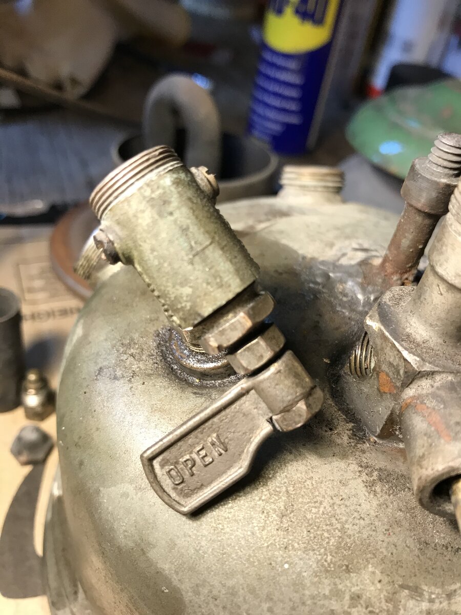

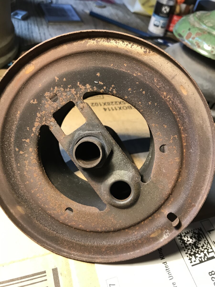

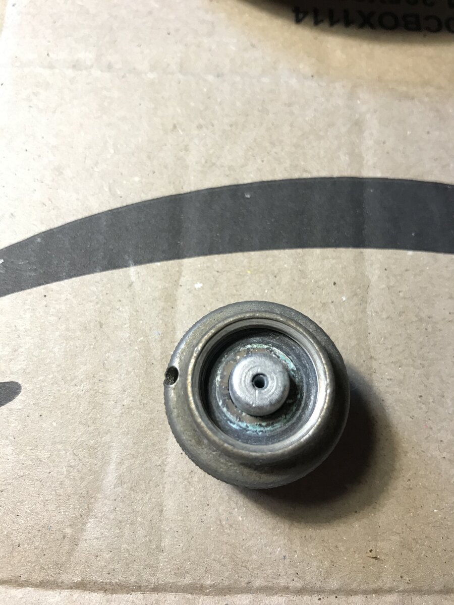

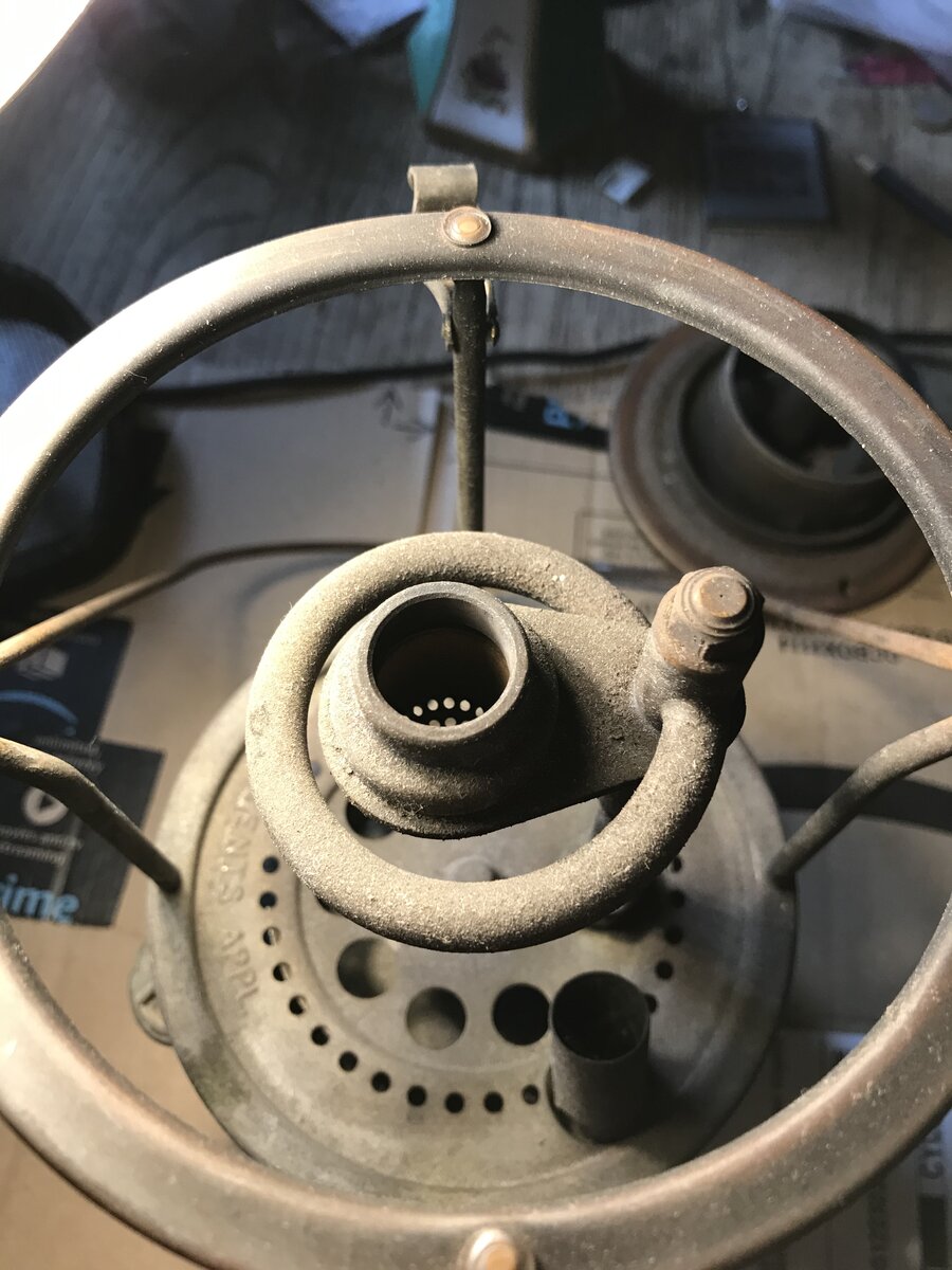

  27. Alex74
    Oct 13, 2019
    516
    Faringdon, Oxon

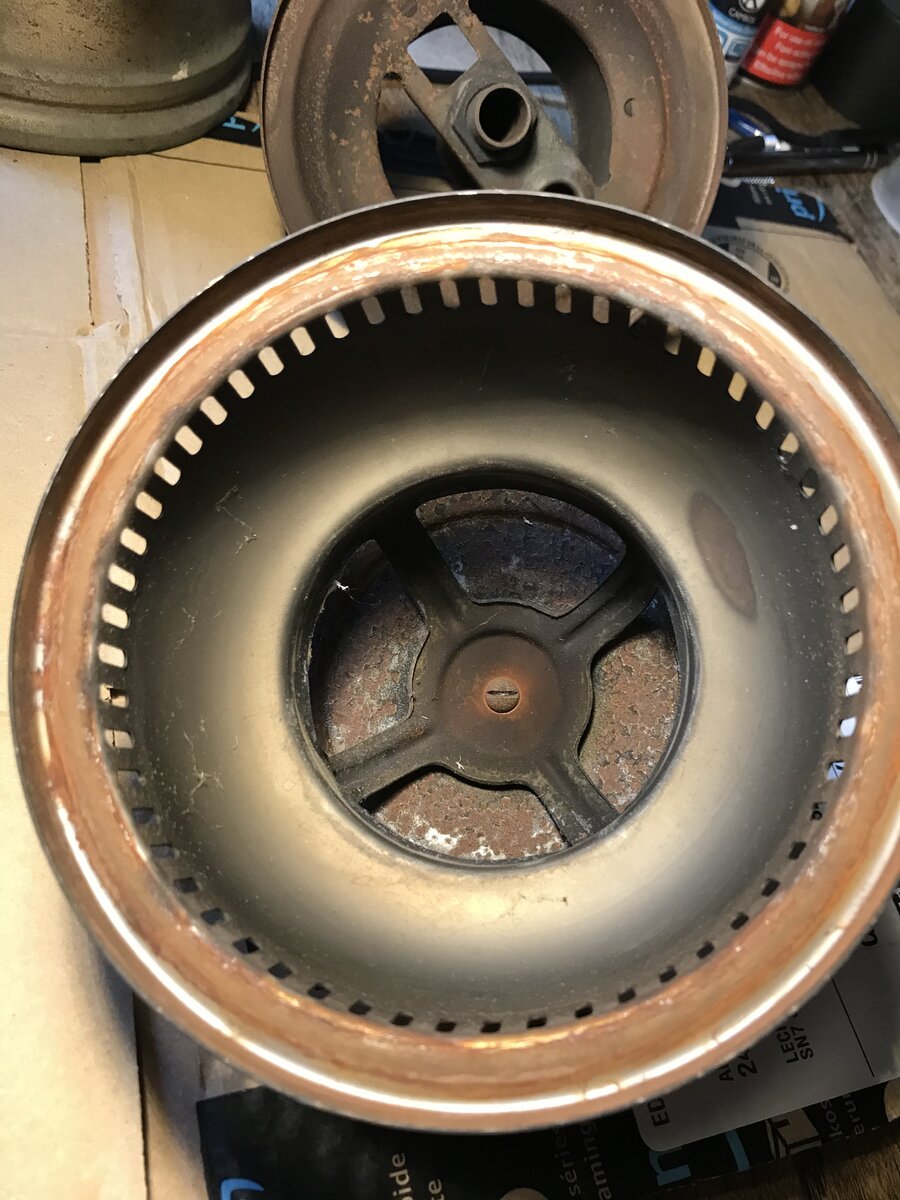

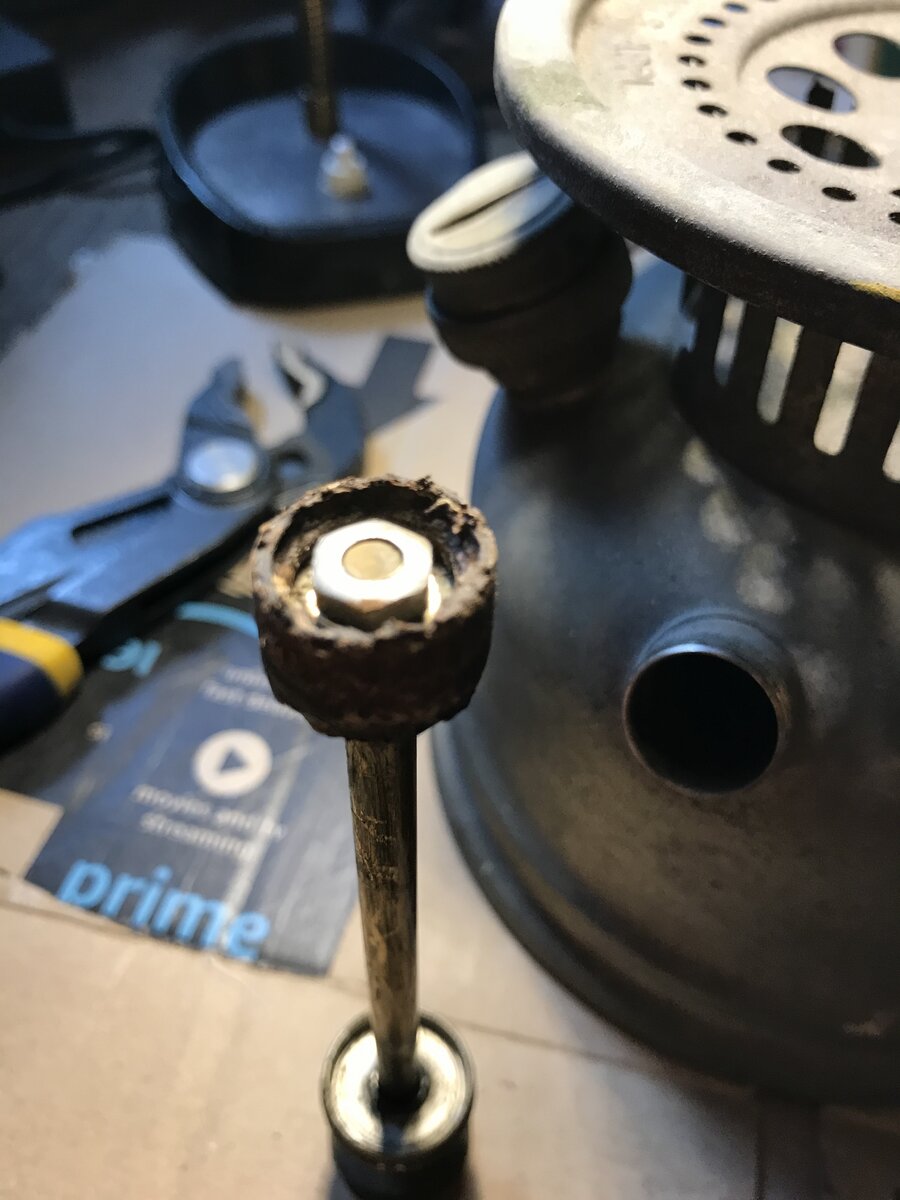

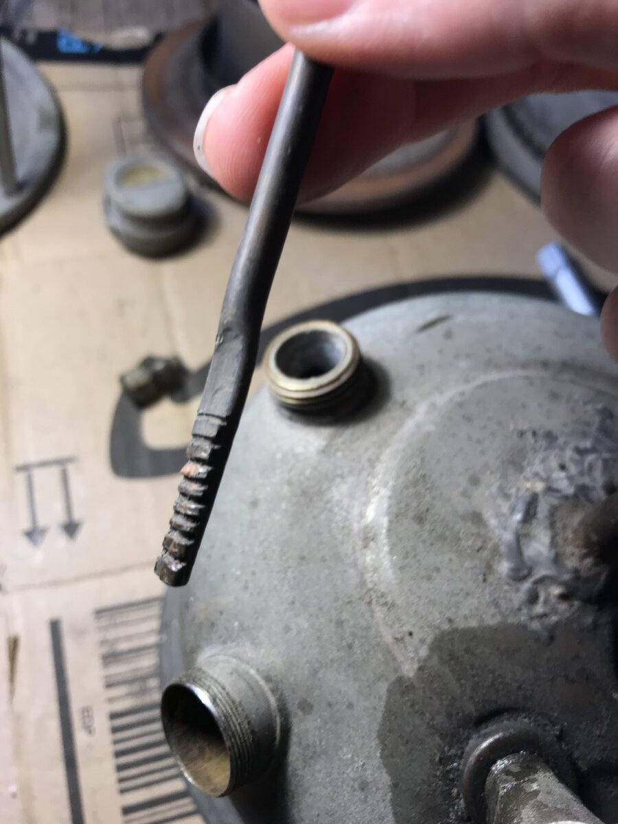

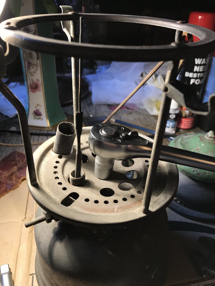

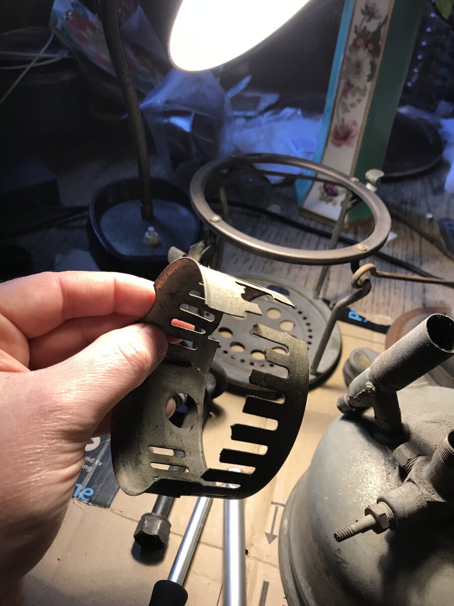

    Here we go. A few photos of the disassembly in progress. The pump leather is as stiff as old boots. Someone has soldered the top of the tank it seems. Would you melt it Away to see what’s underneath or not? Maybe at some point the tank was losing pressure through the top support? The rack and pinion needle still work but the rack teeth look a bit worn. And I’m struggling to get the torch off. Should I remove the lever first, by loosening the tiny bit at its base? Any help, greatly appreciated!
    [ 55870D65-A0A8-4D53-B308-B2E37B316E6E.jpeg 8CCA2441-7097-4052-B58C-B82968C98D06.jpeg E538E69A-499C-4453-914A-1FD15B42865E.jpeg 4B342A17-3A20-4C43-81F3-8D5D682E64E5.jpeg 8FE12D7F-D6C2-475B-9144-B3A9B783570D.jpeg 6B056AD5-99DB-4228-9A5C-7A64858F1A9E.jpeg 0959434F-5A8D-4FBD-B2E6-D4279CABFDA0.jpeg 392130BE-981B-49BF-A5EB-3239D7FE97DB.jpeg F7174A95-BB4E-46E0-B92C-231EDC24E39E.jpeg C725F69B-62BC-4FCA-923B-96BD29565259.jpeg
  28. MYN
    It was certainly meant to seal off a leak from around the central screw/stem. The area of concern might have broken off earlier as well.
    If the solder is doing its job well, I'd choose to leave it as is, no matter how unsightly it might appear to the eye. (It won't be seen anyway, since its hidden by the collar and frame rest).
    Unless of course, if you happen to be a perfectionist and is particularly skilfull in soldering work.:)
  29. Nils Stephenson
    3,409
    Thanks for the photos. You have an interesting project. :) Lets look at your questions.
    The pump leather could surprise you and come back to life with a good soak in oil.
    I assume there was a leak (or suspected leak) at the tank fitting. It is hidden by the collar, so I would be inclined to leave it as it is.
    The cleaning needle rod is not original. Someone has been rather ingenious and made something that must have worked. It could be difficult to get a cleaning rod the correct length. The original part number is 6404 and I can see they are not mentioned on the Fogas website. With a bit of skill, it might be possible to shorten a 1020 cleaning rod.
    Yes, you have to remove the lever from the quick starter to be able to remove it. The end of the shaft it is on is tapered so it fits very tightly. Remove the screw at the end of the shaft then slip some thin flat metal between the top of the lever and the packing nut above it. Then while holding the lever, unscrew the packing nut. This should hopefully push off the lever without bending anything.
    Just to mention, the filler cap washer is 18mm OD and 8mm ID, 2mm thick.
    The collar could be made more serviceable by soldering a wire around the top and bottom rims. Inside would be best where it is not visible.
    So far, from what I see, the biggest challenge will be the cleaning needle rod.
