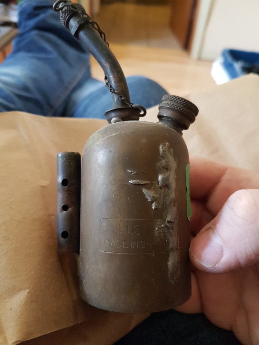

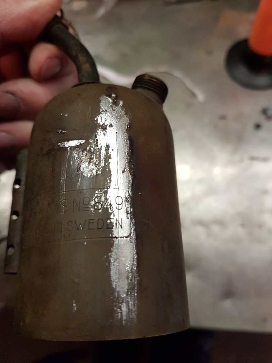

    Picked this little blow lamp up at a antique shop this morning and was curious if anyone had any information about it. Would the fuel be alcohol or petrol?
    11,092
    @Thomas
    It is a gasoline (naphtha) lamp.

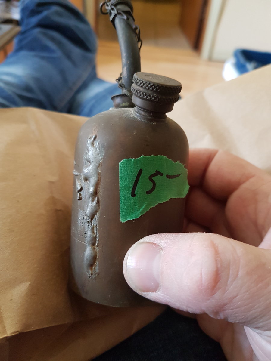

    Finally made it out to the shop, the solder blob on the side turned out to be a bad repair of stress crack. Might try tig welding it if I can find some 1/16" tungsten if not i will hard solder it.

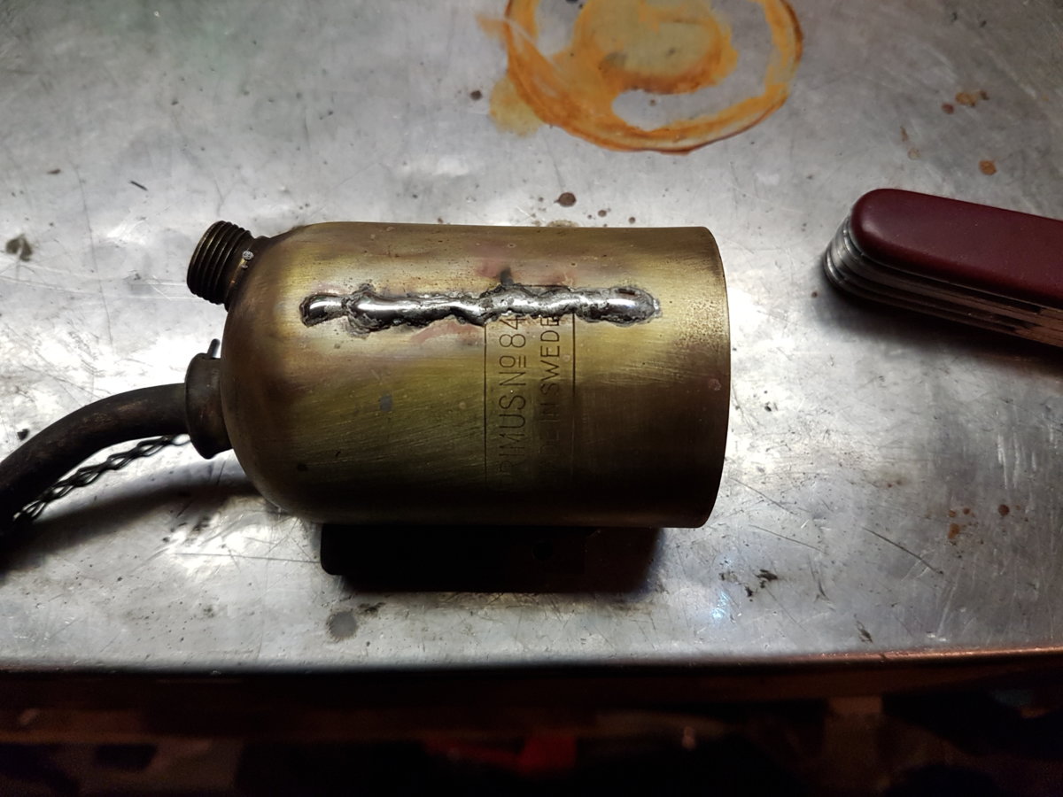

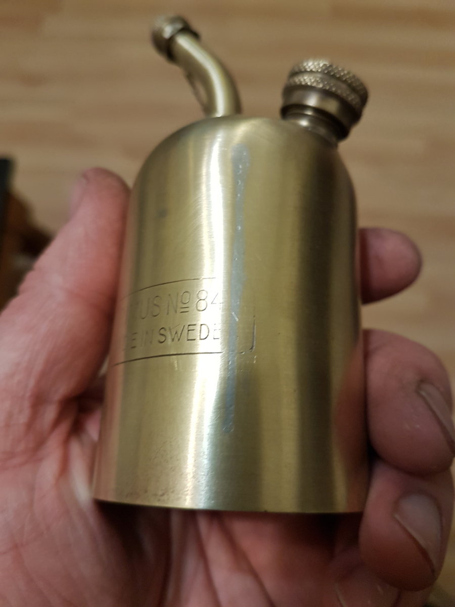

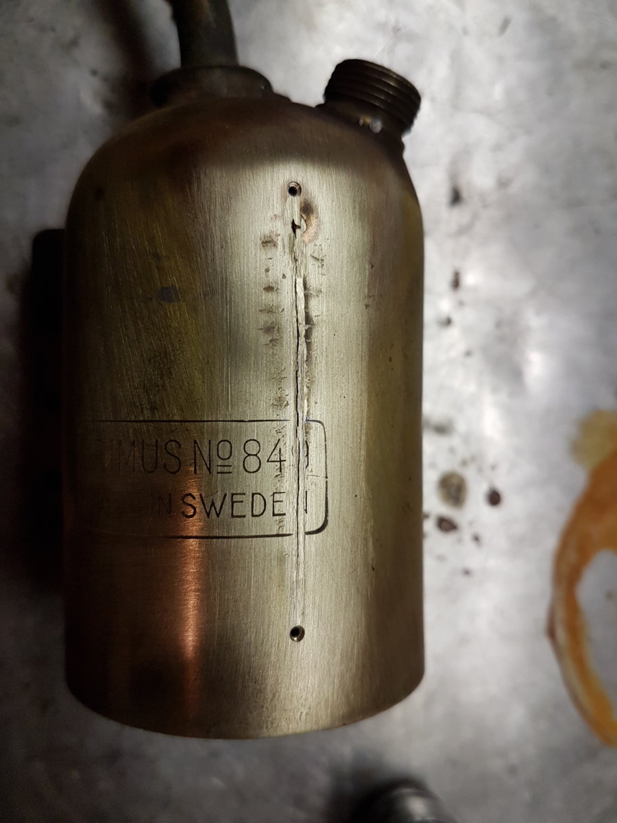

    Soldered and cleaned up, I will test fire after it's polished.
  7. X246A
    1,240
    Norfolk, England
    @Thomas
    Nice neat solder work, just wish my work came out so good!

  8. TocsinEd
    Aug 10, 2017
    25
    How do you finish the solder that neatly? File/sandpaper etc or some other trick?
  9. Thomas
    Thomas Subscriber
    Jun 24, 2017
    209
    I file the high point of the solder until I'm starting to break through at the edges then wrap 400 emery cloth around the fine and finish with that.

  10. TocsinEd
    Aug 10, 2017
    25
    Great, gives a really neat end result, nice one!

    Nice repair Thomas :clap:

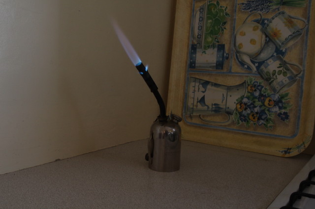

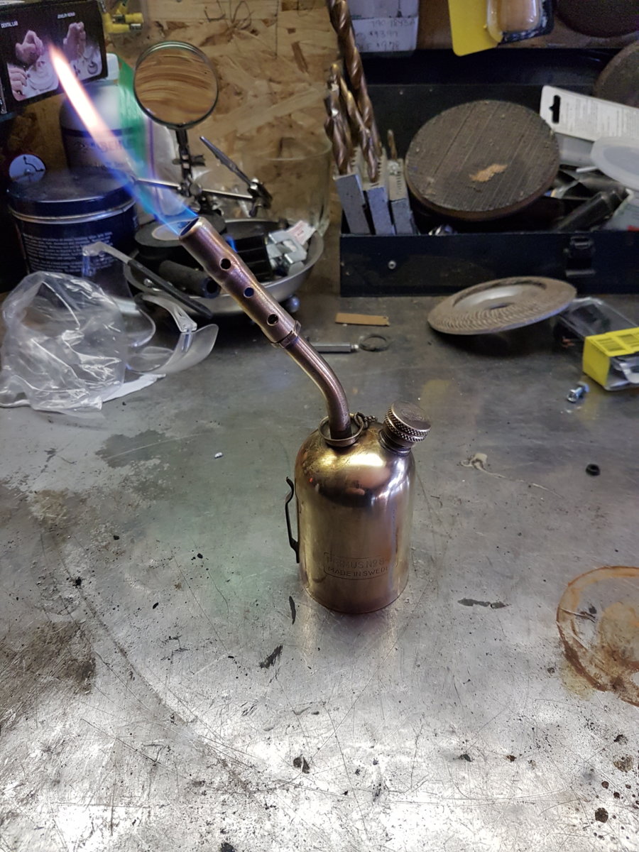

    20190201_104343.jpg It works

    I have one of these. It isn’t very powerful, but useful for some small jobs.
    I had to make the flame shroud for mine.

    Great to see it works especially after such a fine soldering job.
    Regards Jeremy

    It must be a great feeling of satisfaction when you got the blowlamp back in working condition.
    Very neat soldering and finishing.

  17. WimVe
    3,542
    Nice and well doe job.
    Nice to see that you drilled the ends of the crack to stop the crack.

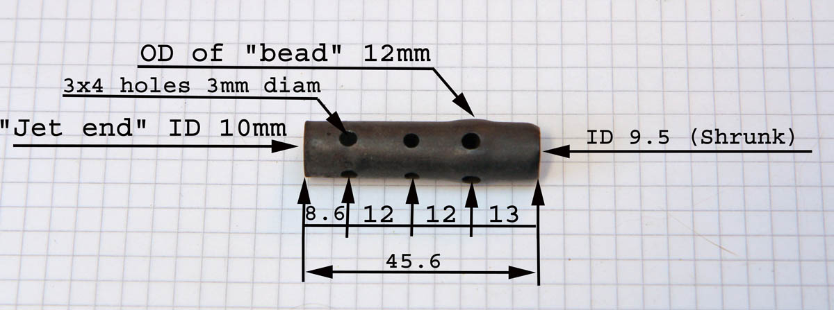

    Hello Tony!
    Please help me! I bought such a soldering lamp this weekend. You don't have a flame tube. You wrote that you have already made a flame tube. Please describe its dimensions.
    Have a nice day! Thanks.
    Csaba from Hungary

  20. Carlsson
    3,966
    I posted the dimensions of this little torch back at CCS many years ago.
    I'll attach the same picture below, and the entire topic is found here.

    1,295
    Victoria, Australia
    Is it common for a fount to pick up just one major stress crack?

    2
    Thank you very much Carlsson!
  23. Carlsson
    3,966
    A pleasure!
