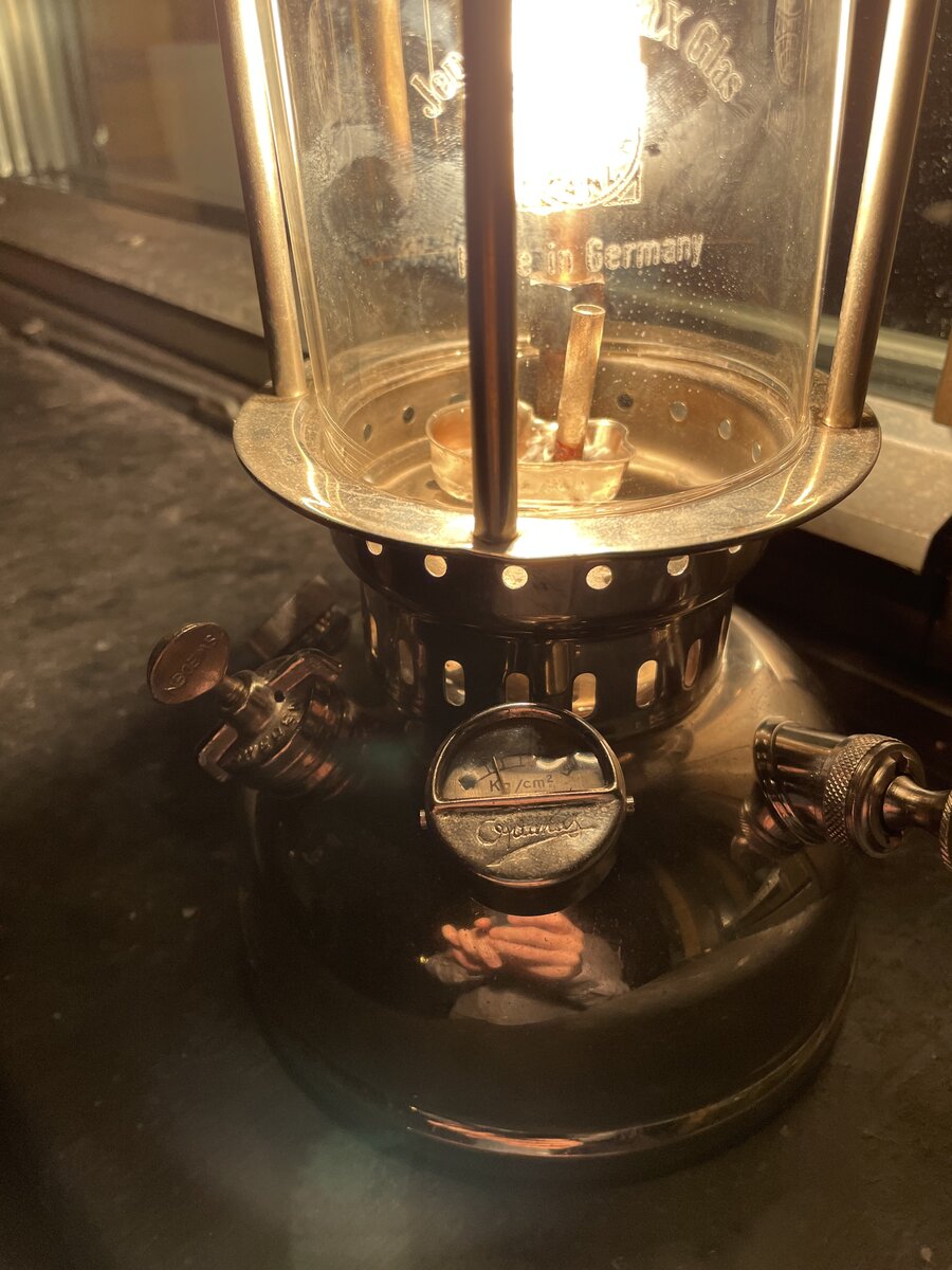

Hi all! Forgot to get back with the result. There was no problem getting it in place regarding threads. It works but after some 70 pumpstrokes on a Optimus 200P it only reaches no1 on the scale, it should reach the red line with that pressure. Tank filled around 70%. I simply used a Dremel cut-off disc to lower the Butterfly housing and placed it in the Optimus house and carefully soldered it in place with low temperature solder. Regards Matti
Well Matti, it does look nice, and looks are what you were after for, were you not? And who really needs a (correct reading) pressure gauge? So congratulations with this result! Mike
