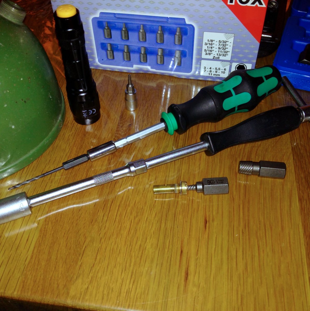

    I asked because I have the same problem with a MEWA 351L and I recently ordered a set of screw extractors. A fellow collector told me that MEWA used aluminium washers instead of lead washers or they left the washer completely away and tightened the valve brass on steel, I hope I will get it out and my further hope is that a Petromax valve will fit.

    My extractors arrived today and I was able to remove the NRV. As I broke my sole long 3mm drill off I had to hammer a small torx into the valve to enlarge the hole to give the extractor a good grip.
    I plan to reuse the valve because it stayed fully functional thanks to the height of its head. I will have to fill the rounded slot with JB WELD and when cured I will cut a new slot in the undamaged brass.
    Sorry for hijacking your thread but I considered the information as maybe useful.

    Refurbished MEWA NRV. Rounded slot closed with JB WELD to prevent tools to get in the wrong place. New slot filed a bit deeper as the original one.

    My idea for the next step, that luckily was not nexessary, was to glue a hex nut on the NRV and use a ratchet/socket to try to remove it. That's why I had JB WELD ready to close the ruined slot :lol:.

    What type of screw extractor did you use? There are different types available. The extractor that I used is for screws with cylindrical hexagon heads. There are other types for cross slit countersunk head screws. They differ in the shape and pitch of the cone.
