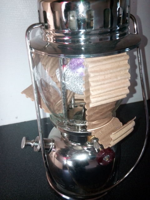

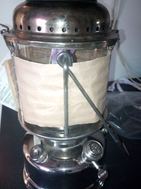

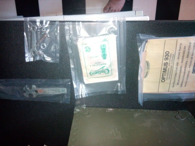

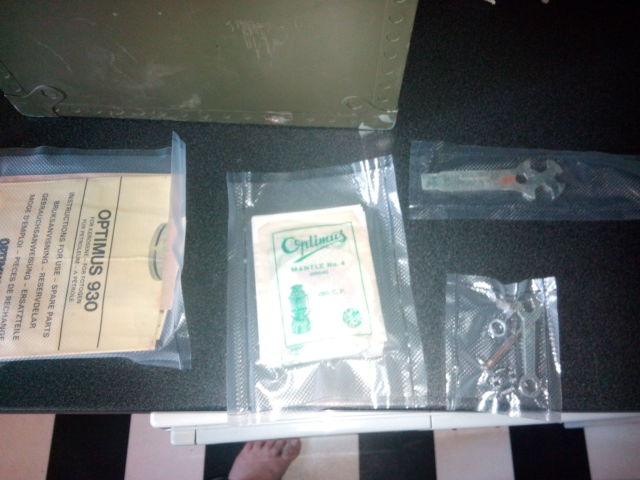

Hi all. I put the food vaccum sealer to good use, preserving my investments for the future. I guess oxidation will be a bit more tricky without air. Didnt compress the mantels and documents to max as i think they would take damage. Here is how the 930 is packed to protect the glas. And here is a 119 packed to protect the glass. A long term storage solution i got is to also put the lantern in a plastic bag with a silica gel bag inside.

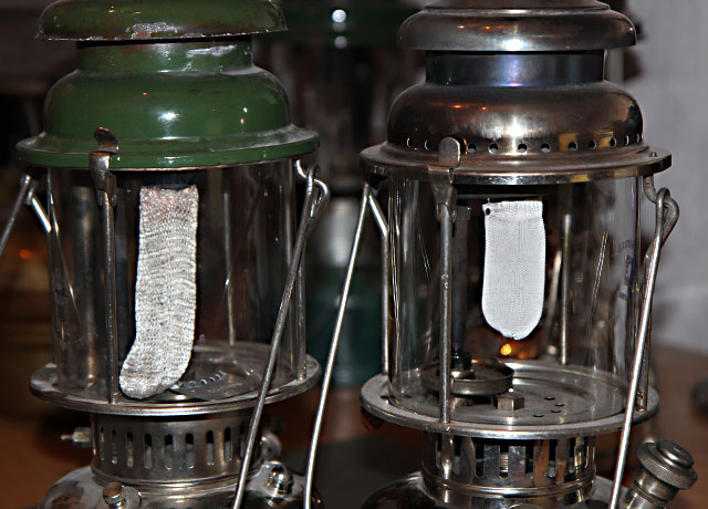

I'm not sure why they should be useless over time. I have had many lanterns where previous owners since long ago have left un-burned mantles on them, and they have worked as usual despite perhaps 20-30 years of being left hung on the mantle holder. They tend to get very long over time, of course. Generally they will reach the bottom of the globe rest with margins, but that doesn't matter. They will get free during the pre-burning shrinkage.
It probably depends on a number of factors but they sag under their own weight and then don't form properly when lit... It's best to keep them in the packets until just before you intend to use them.
Yes, I fully agree. But as I also said, they just get long. It's in reality most a matter of looks, not function. They generally still work even if they are more cylindrical than bulbous. Unless you have a very picky lantern where the mantle must be extremely close to the vapouriser. Two quick examples! The Primus to the left show what a mantle look after many, many years of "hanging free". This is a very common sight here nowadays on used lanterns, since people seems to often have stored their lanterns in this ready state. Many remained like this until e.g. a son or grandson eventually put the old scruffy lantern out for sale. That's probably what Fjellot's mantles will look in many years from now. The Radius to the right looked exactly the same before I took it in service, and it still work just as well as a more roundly shaped mantle, and I have many examples of this.

Be careful when wrapping the globe. Some paper qualities will contain some nasty acids which - over the years! - also will affect (?) borosilicate glass and cause damage to the glass surface. Erik
