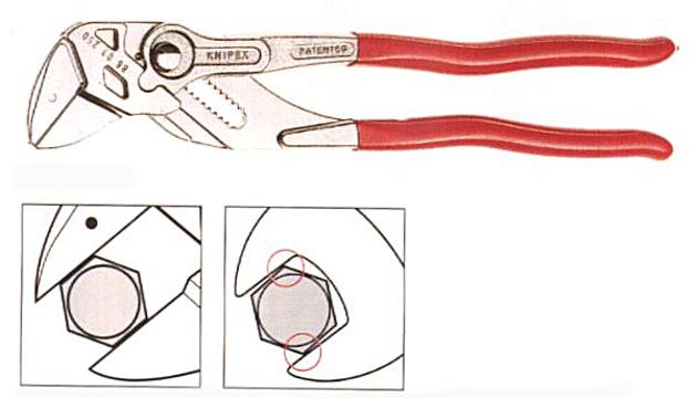

    This is ONE way out of a thousand to remove the nut :lol:

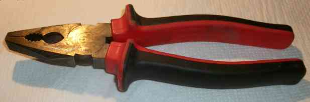

    I'm not sure what point you're making Stephan, but what you illustrate isn't a pair of "pliers"

    How would you call it? Nut pliers? In Germany it is a "Zangenschlüssel".
    I prefer this one because I don't have imperial sized spanners :D/

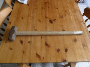

    At work I don't use pliers or spanners. Just the biggest hammer I can get my hands on :lol:

    I've seen these Knipex pliers before and I like the way the jaws stay parallel when opening and closing. Expensive though.

    That's exact the way they are working, you can use them to replace a set of spanners and they don't damage surfaces because they have no teeth. You can get them in different sizes, the small one is very handy to have it in the lamp tool box :content:

    Yes, that's because they are an adjustable spanner (or wrench), not "pliers".
    These are typically what are referred to as pliers:-
    -not to be used for removing nuts and bolts, particularly tight ones.
    With all due respect, Jeff, the Knipex tool isn't a pair of water pump pliers, although they superficially resemble them. Water pump pliers don't have parallel jaws - they wouldn't do the job they're designed for if they did...

    And if all your corrective surgery fails, then there's always plan B. Its not so corrective but can often make you feel better.......

    Ah yes, the 10 lb precision alignment tool :lol:

    Yes, he's up and running now, so i take it he didn't use the internationally recognised 10lb precision alignment tool :lol: :lol:
