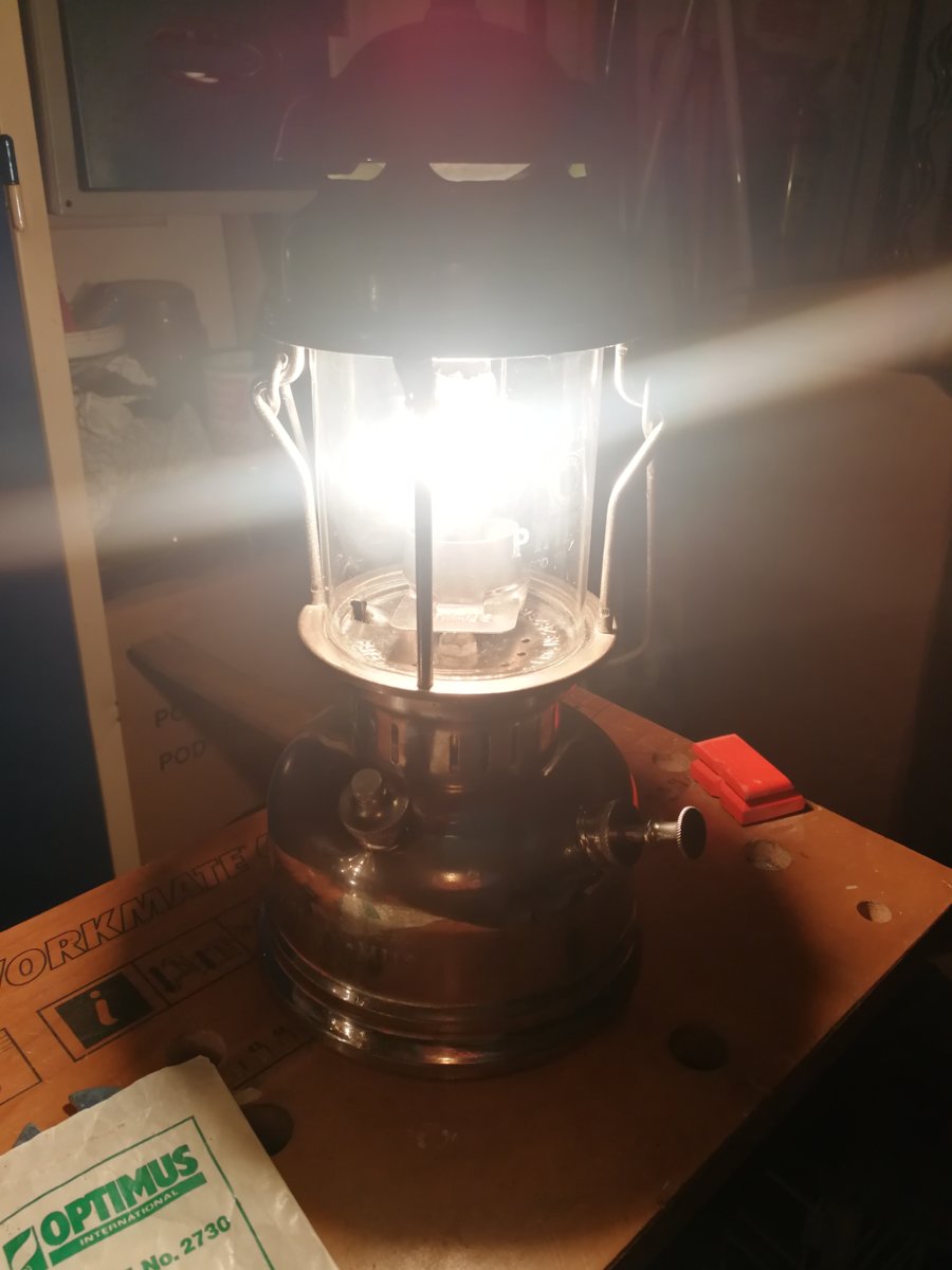

    So, the whole country has shut down here. What to do but sort out s few of my problem lanterns.
    Here is my Primus 1320 with the dodgy pricker shaft. Burning nicely on some bioethanol. It has a cheap Chinese Butterfly mantle, as I damaged my vintage Optimus 300cp one unfortunately.

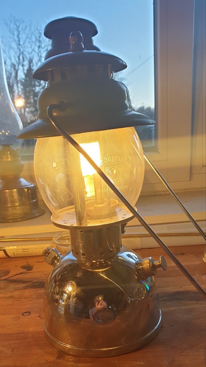

    Up next, the a broad-arrow Austramax. A bit of teflon and new lead gasket sorted out the pressure drop.
    Needs to have the globe cleaned once it cools off.

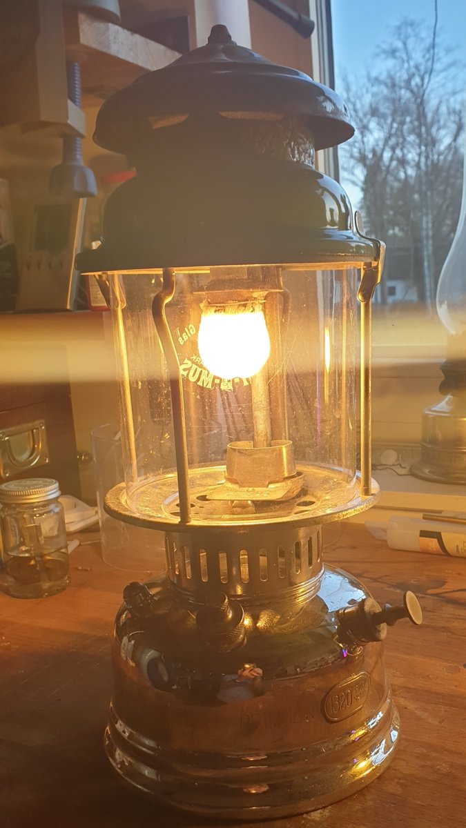

    Finally my Christmas present. The Optimus 258. Needed to cut a new thread in the generator and get a new jet installed. A new cork also fixed the slow leak. Looking good in the garage. Will have to adjust the cleaning rod length tomorrow. Pricker isn't really working as it should.
    Tomorrow will be getting my Hasag lanterns sorted out. (If my wife doesn't catch me for DIY in the bathroom)
