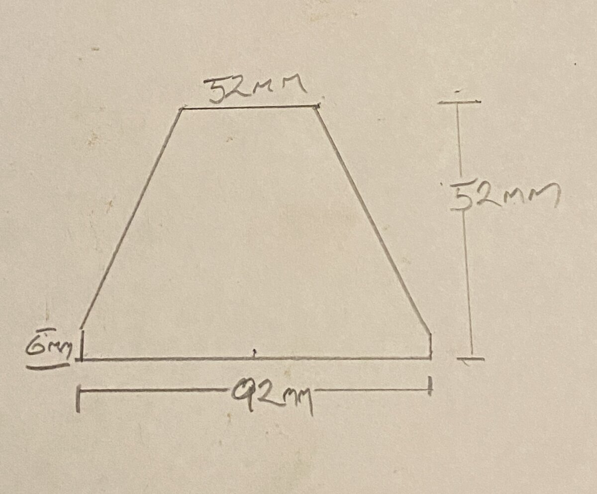

    Could you please tell me the following sizes of a cone to be attached to the gallery of 300cp donut lamps such as IL33 and IL47.
    Top diameter
    Bottom diameter
    Bottom edge height
    Total height
    I think it would be very difficult to find this as an original part, so I would like to make it from a thin brass plate.
    Best regards,
    Shinzo

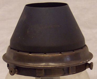

    The attached picture is from Neil's IL47.
    @Mackburner
  2. Anthony
    Anthony Australia Subscriber
    May 7, 2013
    1,649

    @Anthony
    Thank you so much!!
    I'll try.
