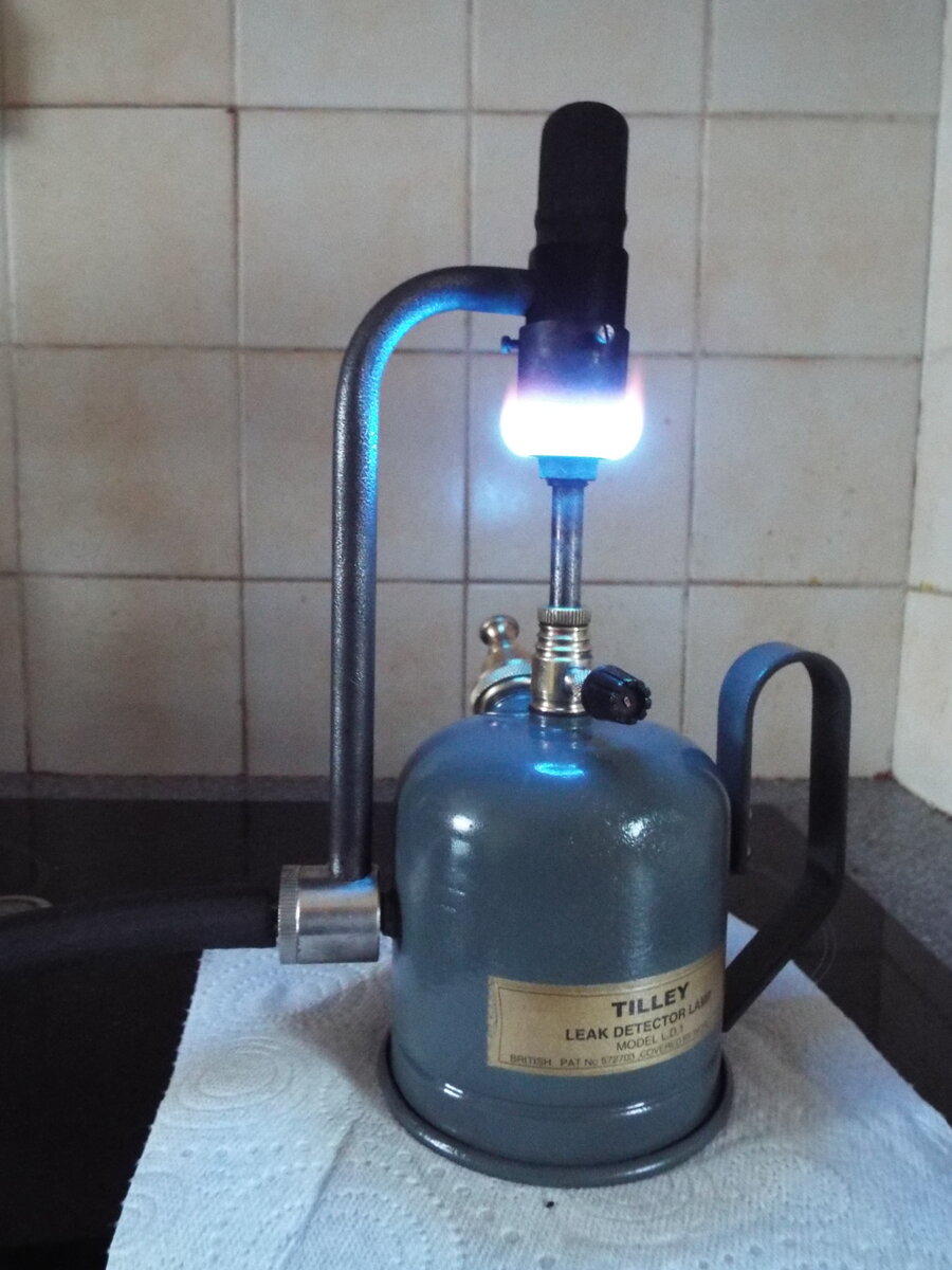

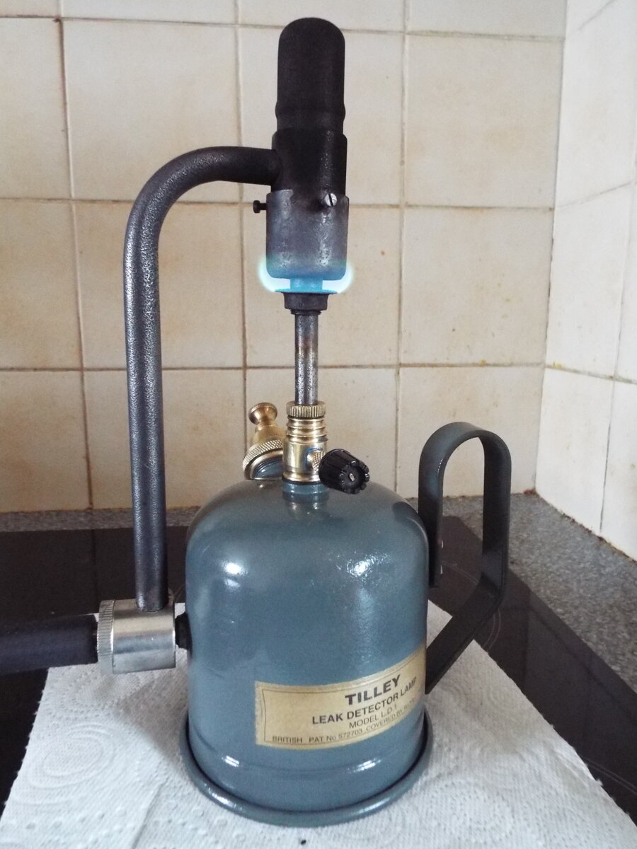

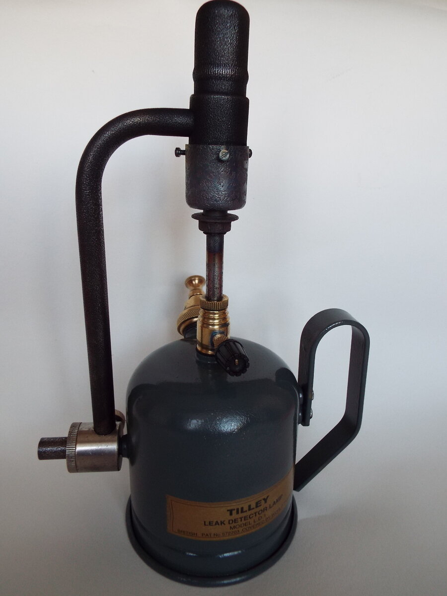

  9. Yano United Kingdom
    Feb 11, 2023
    8
    UK
    Hi Anthony,
    Please find pictures below of the LD1. 2nd picture just burning, third picture detecting Ethyl Chloride. Difficult to see the vivid blue on the picture. However you can see better colour reflected on to the air intake tube.
    Regards.

  10. Anthony
    Anthony Australia Subscriber
    May 7, 2013
    1,657
    Thanks for posting the results @Yano.
    I have had a few leak detectors going but never been lucky enough/unlucky enough to test a detector.
    Was your test Ethyl Chloride or Ethyl Bromide?
    The chart I posted above says you should have got an intense green.

  11. Yano United Kingdom
    Feb 11, 2023
    8
    UK
    Hi Anthony, It is Ethyl Chloride B.P. In the picture it tends to look more blue. However in normal viewing it is a very intense Green /blue.
    Test lamp responds very quickly to the test.
    The decals are home made. A copy from the damaged original. What I did was make a water slide transfer the correct size. I then masked off the size of the transfer on the tank and sprayed with metalic gold spray. Then applied the transfer and finished with clear laquer.
  12. Sedgman
    1,294
    Victoria, Australia
    @Yano
    The pictures are very nice and congratulations on getting it running. Just a query on the decal. It looks like the patent on your decal is 572703. I note the correct patent number appears to be 577703 as per the Operations Guide for the LD2 mentioned in another post by @Anthony. I am presuming only one patent exists for the LD1 and LD2 though.
  13. Carlsson
    3,966
    Indeed. GB572703 is a totally different patent.
    I assume this decal is a replication where someone has mistaken a bit worn out text from an original one. A '7' can in some cases be mistaken for a '2'.
    In anthony's post here, you can see that it is 577703, but it's not totally clear.
    A more worn out decal could perhaps fool the one making a reproduction.

  15. Yano United Kingdom
    Feb 11, 2023
    8
    UK
    Hi all, Yes, I think it should have been a 7 and not a 2. Another grey moment. I will need to produce a 7 for it.
