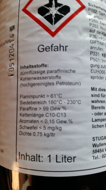

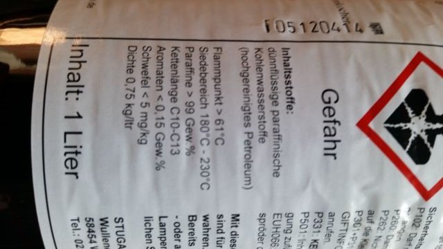

  7. davecapps
    Jun 13, 2014
    44
    Thanks Maurice
    I finden it difficult to find Suitable fuel here in Germany. I Use this stuff.
    I get it from stuga Cabana.
    Dave
  8. Maurice Snowdon
    Maurice Snowdon Subscriber
    Jan 10, 2011
    45
    Hello Dave,
    It looks like you are using the best top grade fuel. Over in Ireland & U/K top grade fuels in large quantities is no longer available. This was from "Aladdin Plnk Paraffin" and "Esso Blue Paraffin" These have disappeared since the 1970's. If my memory served me right it used to be grade C1. Now we have to use grade C3. C1 is required for wick lamps. This can still be got in small expensive amounts (which is probably what you are using). C3, not so refined is what we now have to use (central heating fuel). It is o/k as pressure lamps run at a much higher temperature. Most impurities are burnt off.
    You need to ask other collectors in Germany what they use. It looks that at the moment you are going down an expensive route.
    I hope this helps.
    Yours,
    Maurice.
