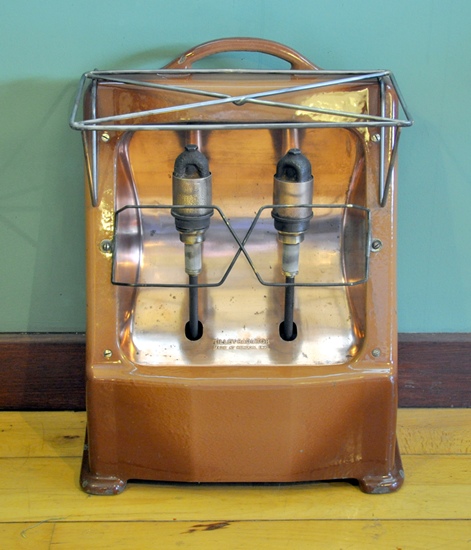

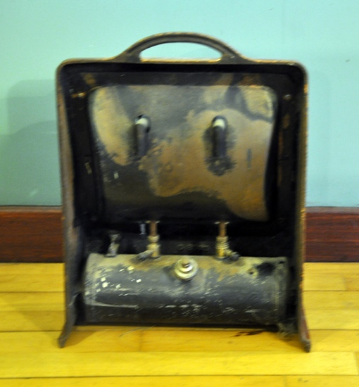

    I've had this R22 for a few years now and decided to tart it up a bit.

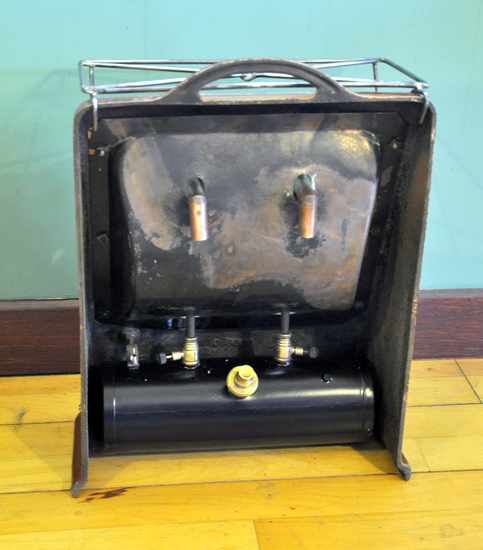

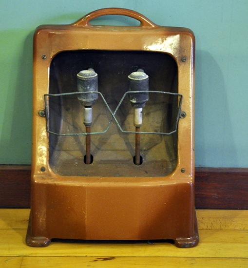

    I replaced the burners with cast ones,cleaned up brass and copper and painted the tank. Stu made the pan rest which is a pretty nice addition.
  2. David
    154
    The North
    Very nice Jean, and the pan rest look just the job, fantastic work Stu.
  3. David Shouksmith
    Aye, much improved without going over the top with it :thumbup:
    Did they always have those burners? I think mine may have the flat-tops as well. I don't recall mine having the air intake extensions either :cry: Still a few lengths of copper tubing silver soldered together looks like they'd be the part.
    Finally, the pan rest looks great but I'm wondering how secure it is. It occurs to me that a couple of loops on either side would enable it to be fixed to the cast iron using the top pair of reflector screws - just a thought...

    Well that seems to fit alright 8) :thumbup: , i'm glad you tweaked it to fit :D :thumbup: & as David says a couple of thin steel strips folded around the the front supports & secured using the reflector screws would work unless it's stable enough already :D :thumbup:

    Stu, will put a pan of water on tomorrow and see if there's any give but I doubt it.
    Jeff, I have one spare if you'd like it.
    David, you haven't read your 'Bible' recently - see p.74 Jim Dick's Tilley book.

    My R22 came with flat top burners. As I have seen a few with flat top burners I am wondering if they started in 1939. Has anyone else seen them ? I know they can be swapped but would you have two to swap at the same time ?
