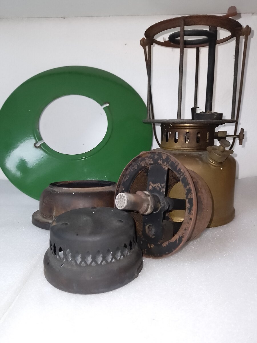

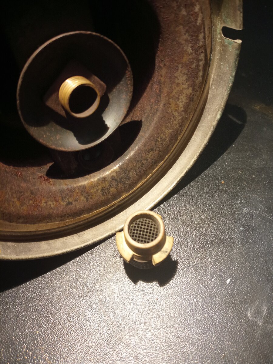

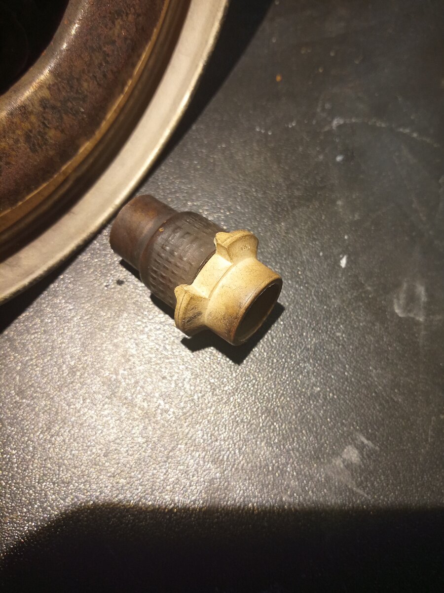

    It was mounted on a Ditmar Maxim 501 , manufactured in 1941.
    The lamp otherwise showed no structural modifications that might suggest the use of a fuel other than kerosene.

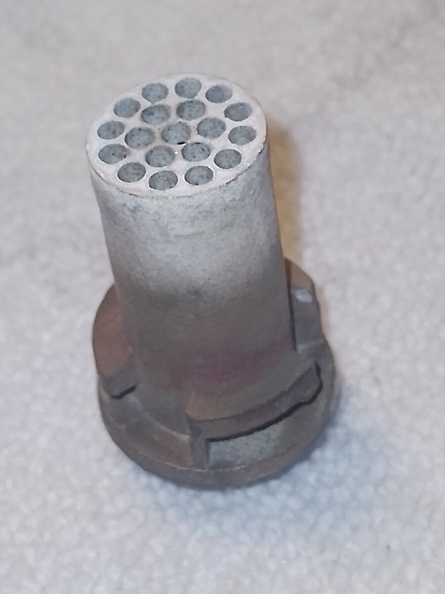

  2. Michel
    Michel Subscriber
    Jan 26, 2011
    1,429
    56 France

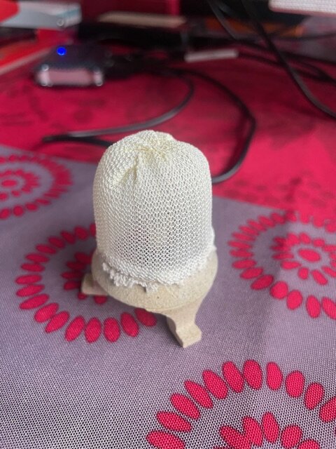

    Hi all

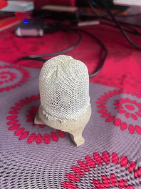

    I think this ceramic is not original, it is designed to receive the type of mantle you see in the photo.
    They were also mounted on natural gas lamps
    this one is a Mariva

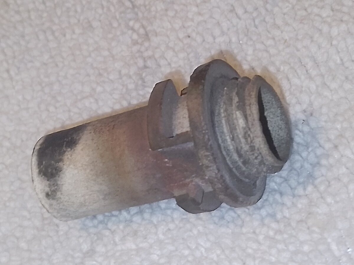

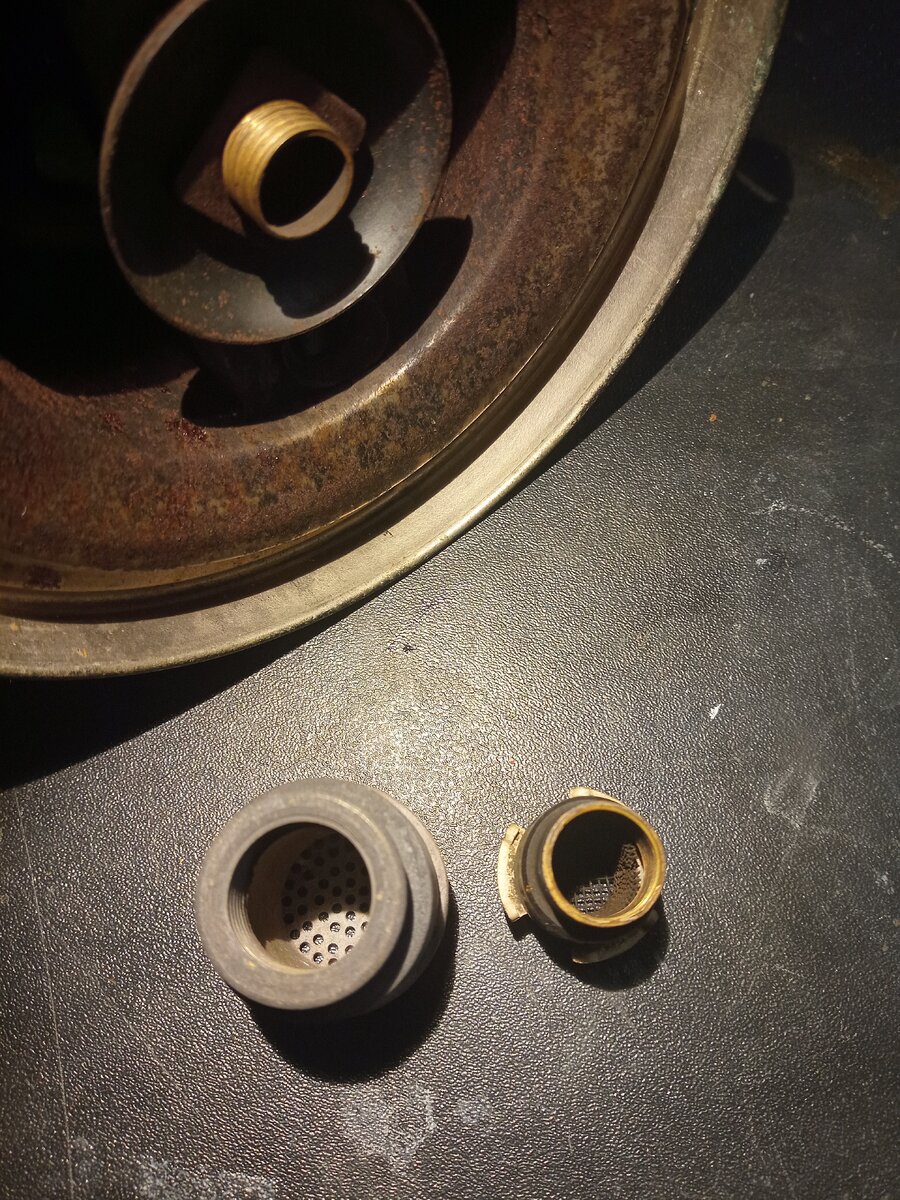

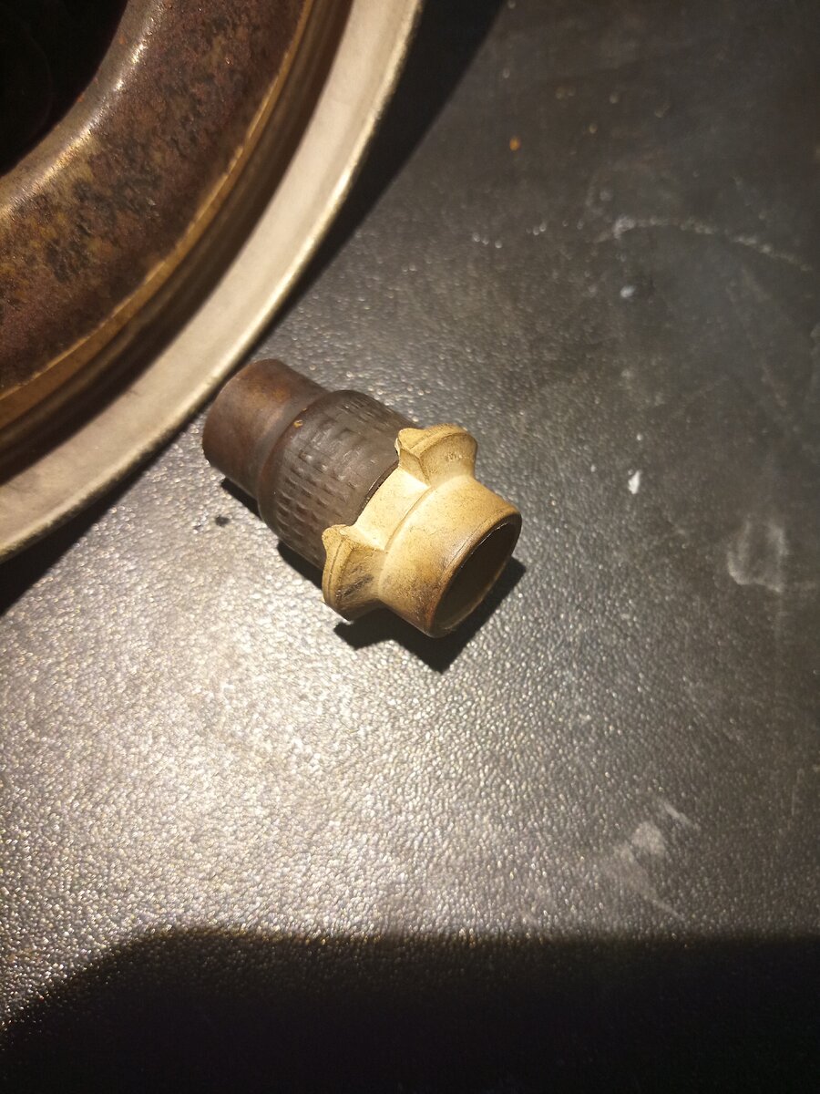

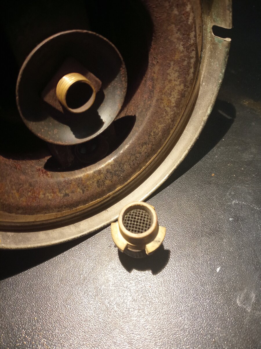

    @Reinhard
    Interesting.

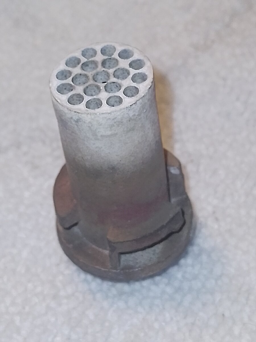

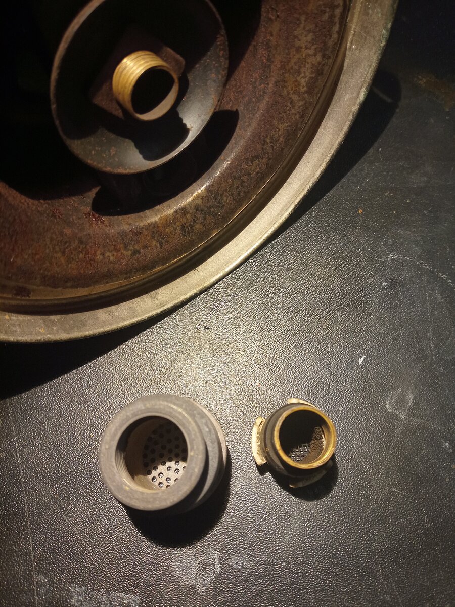

    I have similar stuff attached to Petromax 823. It seems to be original because fits to the unussually narrow J tube. Pics attached including comparison to regular Px mixing chamber.
    I am not sure how I am going to attach a mantle there. Maybe using ceramic like posted by @Michel , but these are quite expensive and I am not even sure if will fit to 100 years older parts...
    Any ideas are welcome.
    all the best,
    Piotrek

  6. Reinhard
    Reinhard Germany Subscriber
    Oct 15, 2018
    1,084
    This is what the complete lamp with the long burner looked like when I received it . My first thought was: a burner for rigide mantles that screw on , and perhaps for alcohol because of the few but large holes.

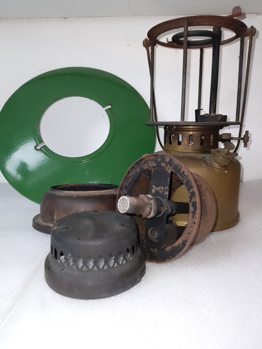

    A lantern for alcohol would also have the air restrictor and a jet with larger orifice as shown here at my Ditmar 509.
    Unfortunately I don't recall to which lantern the rigid mantle burner was mounted when I received it in around 2017, and since it looks quite differently than yours I believe that it once belonged to a gas lamp and not to a Ditmar. But the threads fit the Ditmar (and fortunately also my Wiktorin hanging lamp, which missed the burner when I akquired it).
