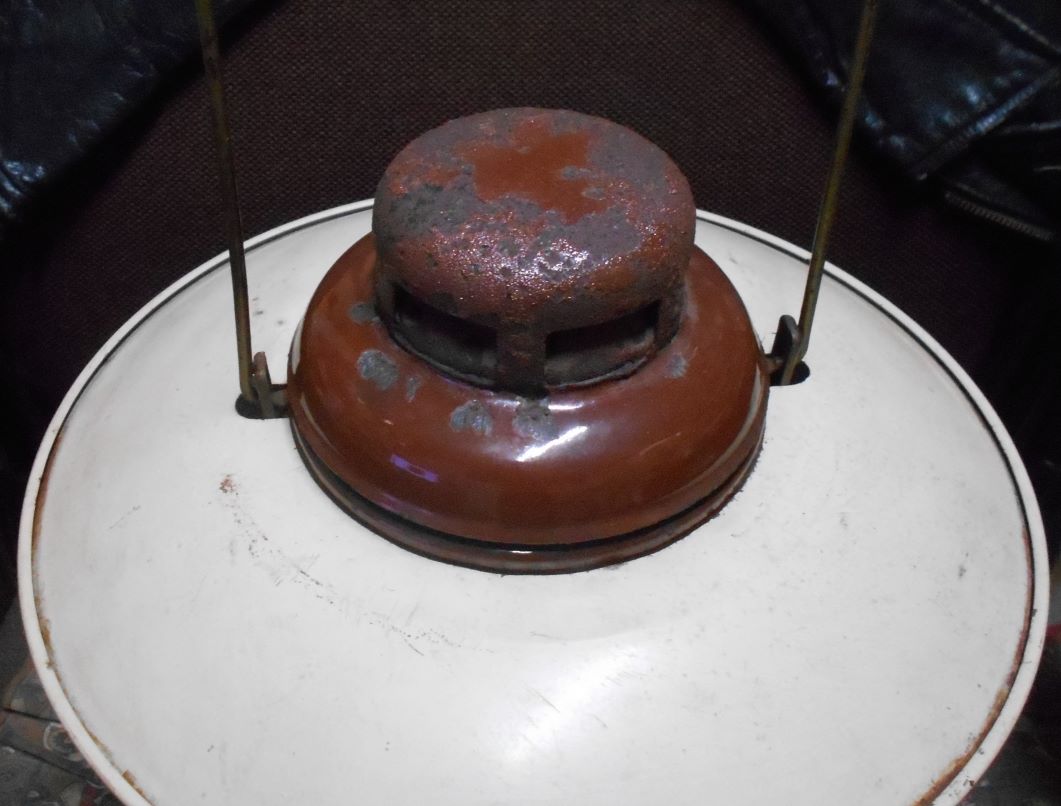

  4. Henry Plews
    3,033
    Early Vapalux 300.
    This one came on a 1943 Vapalux 300 with grey painted steel tank. According to Ian Ashton's book (Vapalux and Bialaddin Pressure Lamps) The brown colour was introduced in mid 1944, I assume your reflector is from that period and would have looked at home on a brown painted 300 with brown enamel heat deflector.

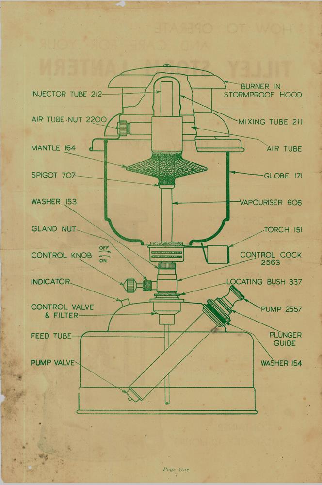

  12. ROBBO55
    4,335
    The drawing on the front page of this Operating Instruction doesn't indicate a deep globe but the cutaway drawing does. :-k

  14. podbros
    3,999
    @ROBBO55 .. hmm those two images show different pumps and they show different control cocks?
  15. podbros
    3,999

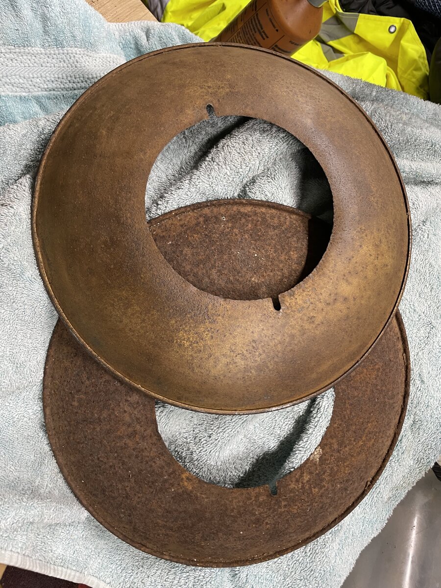

  16. Beanie United Kingdom
    Mar 2, 2026
    55
    United Kingdom

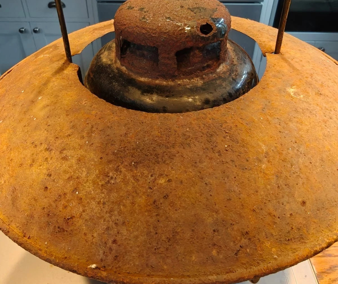

    I have a couple of these in poor condition that fit the later Guardsman , (Bail that holds the hood on)
    Has anyone any insight as to how hot they get, mine are rusted, will VHT paint last ?
  17. podbros
    3,999
    It might be ok for a few firings, but nothing beats the enamel for longevity, i’m afraid :/
    you can pick up the black hoods for reasonable prices still?? and on occasion the brown ones :thumbup:
    @MYN did try making a type of paint/coating which looked promising
  18. Beanie United Kingdom
    Mar 2, 2026
    55
    United Kingdom
    @podbros I was meaning the shade / reflector , not the Hood , or are talking about enamelling the hood ??
    Having spent a bit of time on them tonight , they were defiantly painted from new not enamelled
    Gold on the upper and white on the lower side
    Cleaning up well, but I’m still tempered to re paint

    3,999
    @Beanie
    sorry, yes im sure it will be fine to paint :thumbup:

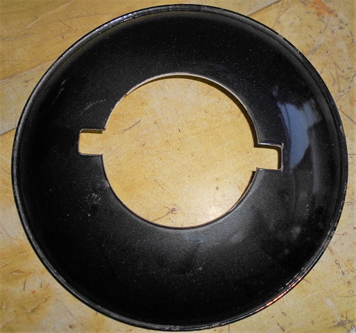

  21. Henry Plews
    3,033
    I think I used radiater paint on a KL80 reflector, it works fine.
    You may wish to adjust the handle mounts on your lantern, the reflector should be a snug fit as in this image.
  22. Tony Press
    11,026
    I’ve painted quite a few Tilley and Kayen reflectors for use.
    They do not need high temperature paint at all. But make sure you’ve killed all the rust before painting.
