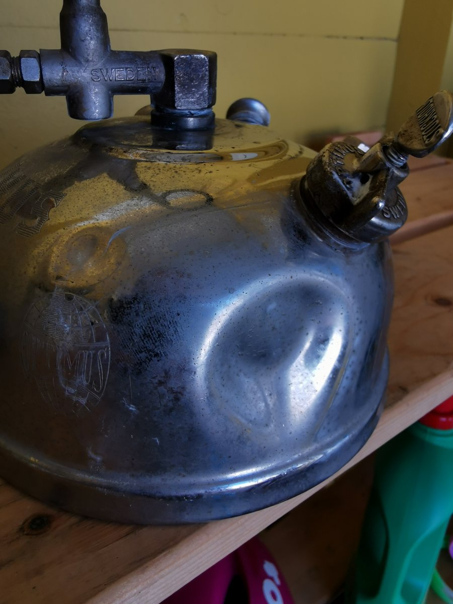

    Hi! I started to clean an Optimus 200 and i wounder if it is some easy way to remove the bumps from the tank. I attached some pictures.
    Other question: how to remove the black smoke on a way that doesn't scratch the lamp.
    Thanks för the information.
    Best regards,

    1. You can solder a rod to the deepest part of the dent and pull the dent out. The heat and the solder will affect the nickel plating, so you need to decide whether you do this or not.
    2. You can fill the hole with some resin and sand it back to the shape of the tank, but again you have compromised the nickel.
    3. You can leave it as it is and appreciate its history.
    I have used the method of freezing water to reshape a kettle, but I don’t recommend this method for a lantern that will be pressurised.
    Best regards

    Thanks Tony! That was what i thought also. I think it will be part of the lamps history :). I was thinking to try to pudh the dent från inside of the tank, but i need to investigate that option a little more.
    Best regards
    Frank

    For brass kettles I made a hard wood 'dolly' that fits through the lid hole so it can be used to push the dent out from the inside. For a small opening such as the filler cap on lantern founts you might have to make one out of steel so it reaches the spot that needs re-forming. The business end will need to be rounded and then polished and it would be a good idea to use some grease on the end. If you put the rough end of the steel dolly in a vice and carefully manipulate the fount it should be possible go gently swage the affected area back into shape. I have a tank I need to do this with so if it works I'll post some photos.

  7. bp4willi
    1,156
    Some people fill the fount half way with water. Then use a soldering torch to heat up the dent.
    The heat will pressurize the tank, while at same time weakens the brass and eventually restores the original shape.
    I never tried it.
    Because if applied wrong, the bottom might bulge.
    Try at your own risk.

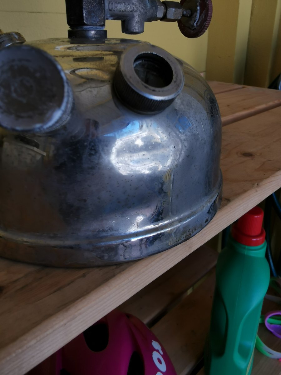

    I purchased one of the dent removal tools and tried to remove a dent similar to to the one in the second picture.
    No success, too many curves and fittings to allow the tool to get a proper purchase. The glue kept letting go.
    I haven't tried again but a shallow dent on the side where the surface is flatter might work? And probably need to have pressure in the font.

    Sometimes, I've managed to significantly reduce the depth of these dents by the following:
    Fill up the fount half full with water, kerosene or some suitable fluids. Pump it up to slightly higher than 30psi.
    Tap, with repetitive glancing blows, the high ridges (edited photo below) with a nylon-head mallet. The dent might eventually bulges out again due to the tension created on and by the surrounding metal. ***Some practice and skils required:
