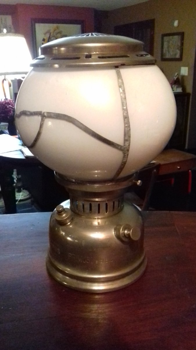

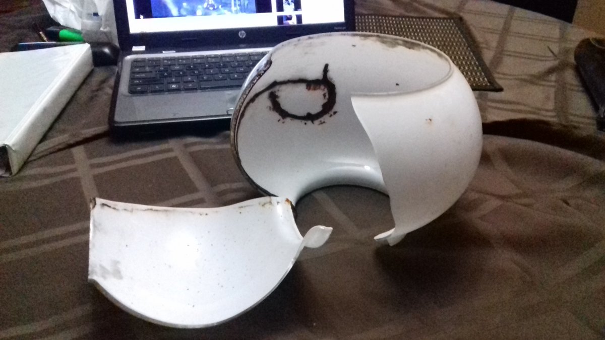

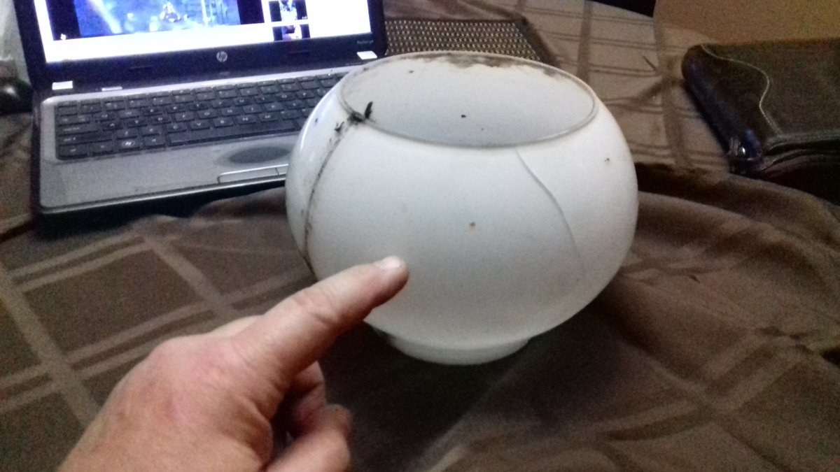

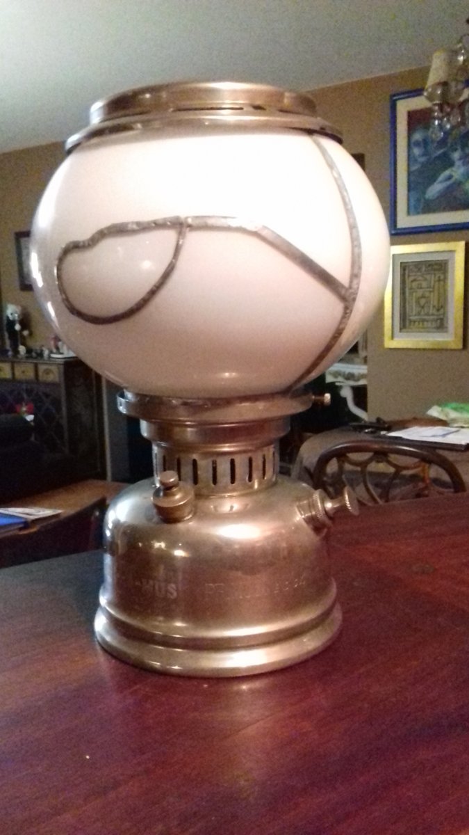

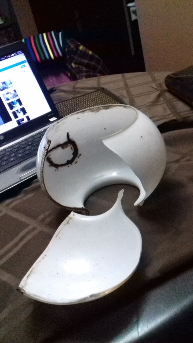

    The tulip had broken and there were no spare parts. It occurred to me to try with the system that is used to make the "vitreux". The optimal south result! The lamp remained stationary for a long time without the glass breaking.
    Cheers,
    Primuseum
    20160831_223352.jpg 20160831_223407.jpg 20160831_223423.jpg 20170509_221619.jpg 20170509_221629.jpg

  2. ROBBO55
    4,440
    :clap::clap: @Primuseum ,
    Does the lead soften from the heat when operating?
  3. phaedrus42
    phaedrus42 Subscriber
    2,056
    Is that lead or epoxy glue?

    I think that is soldered lead - same method as making a Terrarium.
    An inspired idea!
    May not be original but it's far better than broken. :thumbup::thumbup::thumbup:
  5. phaedrus42
    2,056
    I have a broken Perfection 735 globe that I have been considering mending the same way. But will it stand the heat?
  6. JonD
    JonD Subscriber
    Apr 15, 2014
    1,012
    Hertfordshire, England
    It's a good question Phil. How has it been done?
    Modern Terrarium construction is adhesive backed copper tape and 60/40 tin lead solder - when you could get it.
    I have doubts about that method. For solder like that at 250C or higher - game over. Maybe it never gets there. You can go higher using lead free solders - maybe 350-400C?
    The adhesive glue would give up much earlier than the solder but who cares?
    It's only there to keep the copper tape in shape before soldering.
    The old way for leaded windows (AFIK) was a formed piece of lead in H shape (nasty & poisonous) melted at higher temperature to fuse to itself.
    I wonder which it is?

  9. Primuseum
    May 24, 2015
    6
    Does not soften, works perfectly.
  10. Primuseum
    May 24, 2015
    6
    It's lead.
  11. ROBBO55
    4,440
    Thanks Primuseum, nice work.
