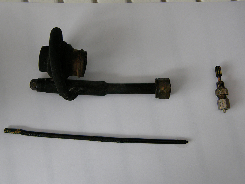

    I dismantled my primus 980 today... looks like i need some spare parts...
    Yes those parts are bent... is these change to get spare parts or should i try to repair these... that valve is also stuck :(
    How i am supposed to get pump valve away from end on its pipe? I think is is jammed.
    Edit. I just noticed how these are similar with small airbrush :D

    There's nothing there that can't be straightened. First remove the jet and ceramic mantle holder from the vapouriser tube and the remains of the cleaning needle from the cleaning rod then anneal (soften) the brass by heating to a dull red and then quench in water. Then straighten using whatever tools fit. I have a screwdriver that fits perfectly in the lower tube of the vapouriser and then use an adjustable spanner to hold the top part. These vapourisers are quite strong so a lot of force is required but do it gently as you don't want to bend it too far.
    As for the pump valve, you need a special tool to get the valve out. There has been at least one thread about this tool but I can't find it right now of course.
  3. Carlsson
    3,966
    As Nils says, it has been written many times about the pump valve, generally often abbreviated NRV for non return valve, so there's plenty of information in the forum already.
    here's just one quick example where you also can see how the NRV look like once it has been removed from the pump tube (and also one that's been taken apart to show you the rubber/cork pip that seals).
    So as you see there, all you need to do is to get a good piece of steel that fit snugly inside the tube, and make a 5mm wide slot straight through the flat end of it. I think the pictures in the link tell you all.
    Mind you, these valves can sit extremely hard, so it's best that you have a good tool with a snug fit on the valve head, otherwise the brittle brass valve will be deformed in no time, probably meaning that you'll have to unsolder the entire pump tube to get it out...

    Thank you, those pictures help a lot. Slowly learning new things about these lamps...
