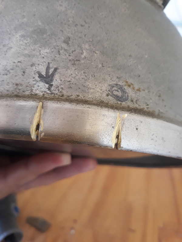

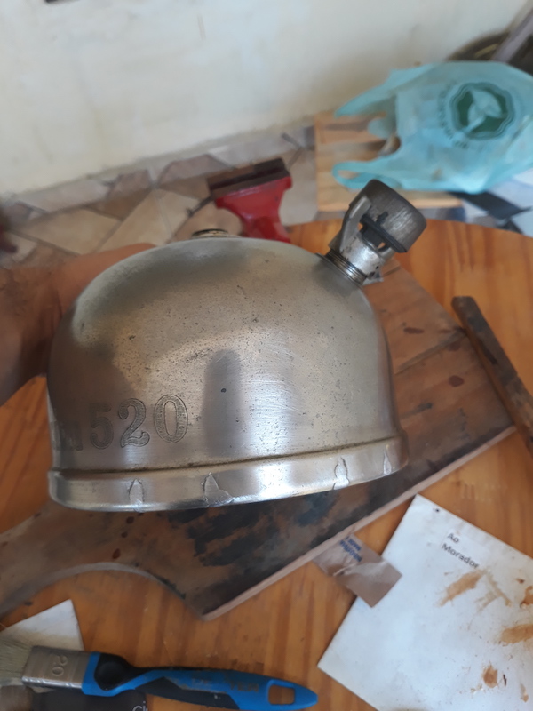

    Very good job, I need to do the same to my Ditmar Maxim 520, found 4 cracks on the bottom. What solder are you using (tin/lead like the one used for solder circuit boards)? Thanks.

  5. Cristiano Brazil
    Oct 9, 2023
    5
    Rio de Janeiro - Brazil
    Thanks, it worked!

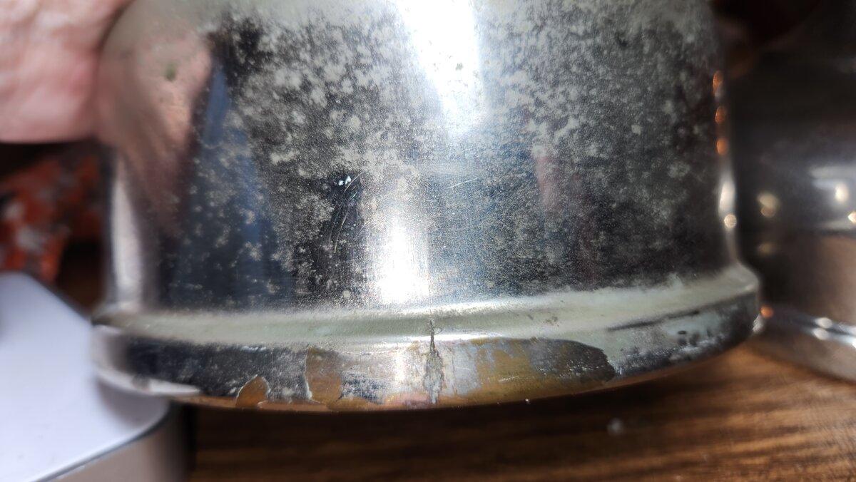

  6. Nagel
    Nagel United States Subscriber
    Aug 25, 2023
    38
    Cristianio,
    Those repairs look very smooth, nice work. I can't tell if you drilled the hole at the top of the crack or not. I haven't tried repairing one of these yet. I did buy a Nagel Chase recently. Looks like someone repaired a crack down at the bottom like where the cracks on yous are. On mine the stress cracks continued up the font. I assume those showed up after the repair. 20231104_193207.jpg
  7. Cristiano Brazil
    Oct 9, 2023
    5
    Interesting, I tried to drill the hole all along the visible crack, from top to bottom. For now it seems fully sealed, tested under water. I hope they don't open more. Thanks.
