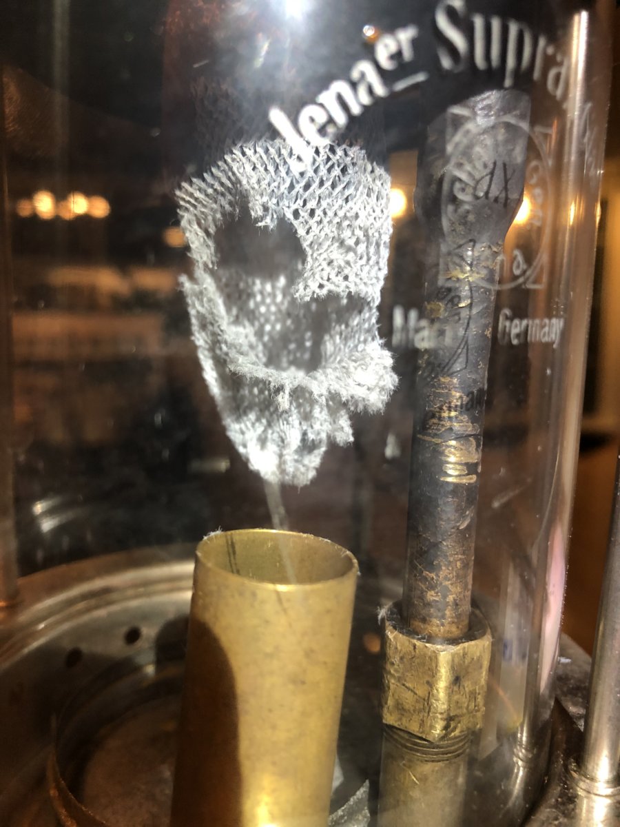

    Well. I’m doing something wrong. I had two mantels and they both look like this now. I didnt use the pre heater but the cup with some alcohol in it to pre-heat the mantle. Saw a guy on YouTube doing it just the way I did...absolutely gutted now:cry:. Aint got no more mantles and couldn’t find any but some primus 100cp at my local hardwear store....

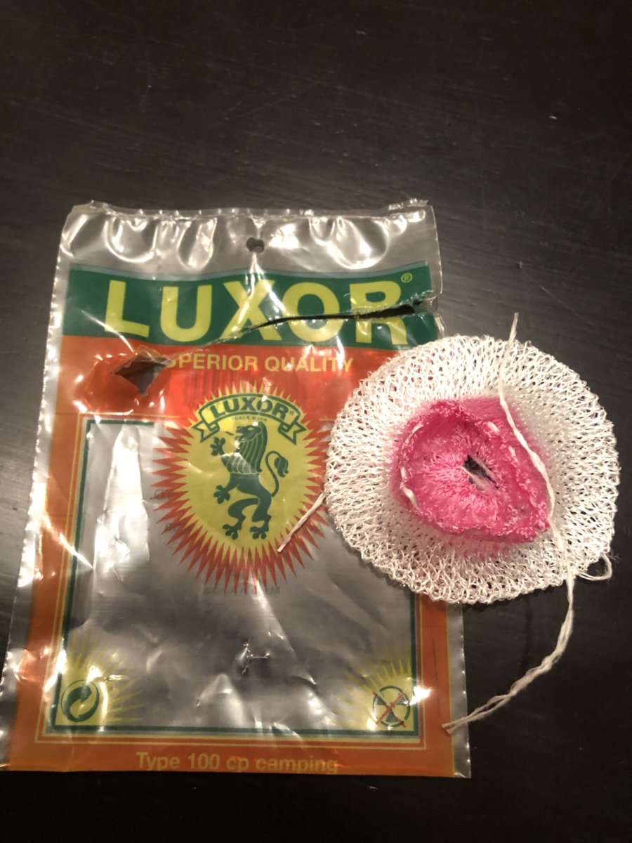

    This is the mantle I still got. Any chance it would work?
  9. phaedrus42

    First try to get a steady blue bunsen flame without the mantle and glass, at low pressure. If you get a steady blue burn for a few minutes, then try a new mantle. The 100cp mantle will not work properly. A 300cp single tie mantle should work well. Are you sure the vaporisr is clean inside and the preston loop is clear?

    This far i’ve just filled the cup with alcohol and fired the alcohol up. To pre heat the mantle and loop. As I saw on a vid on YouTube.
    The only thing that happened was a big hole in my mantel.

    ...now that looks bad! Obviously the preheater has blown half of the the mantle away! Did you give the mantles enough time to turn completely into ash?
    I'd recommend that you burn the mantles outside the lantern, maybe using some spirit, until it is completely white (except the upper rim which usually stays black).
    Then before re-mounting the inner chimney with the ashed mantle (which is very soft and fragile at that time) preheat the vaporizer with full power.
    After that put on the inner chimney with the ashed mantle very carefully, though quickly, and give the vaporizer another softer preheating just for some seconds, and try to light the lantern by carefully turning the handwheel. The mantle should then blow up to its final shape.

    I didn't use the preheater, just filled the small cup with some alcohol and lit it. The mantle turned all white and ashy (as I think it should?). I let it sit for a couple of hours (while making dinner) and when I was about to start it up properly I noticed the mantle was ruined.
    As a complete beginner I must admit I have no idea how to start up a lamp like mine with a new mantle. I googled it and got a video showing a guy filling his cup with alcohol(?) and let it burn under the mantle for quite a while, Turning the mantle all white and ashy...then he just opened the valve and the mantle lit up. Did I go wrong letting the mantle cool down a couple of hours?

    As the burnt mantle is extremely soft and fragile I never leave it standing for some longer time. Surely it isn't necessary to let it cool down. Only after the burnt mantle has been blown into the final shape it hardens and is much more robust. I assume that the carbonates transform into oxides and sinter to a smaller volume. However even in this state they can break easily.

    Hmmm...there’s where I went wrong then. Letting it cool down and moved the lamp around before the mantle hardened properly...will go on a quest tomorrow for a new mantle. Not easy to find (if there are any at all?!?) here on my little island...

    Firt of all: use the right size of mantle.
    second: burn the mantle to ashes and fire the lantern up. The flame front and pressure will shape the mantle and harden it.
    But first make sure you get a good blue flame. So test the lantern without a mantle and globe.
  16. MYN
    You had two mantles that were broken the way they did in the pictures?
    So, did they break because you move the lantern around, before you even turn on the fuel?
    Or, did they break immediately from the initial fuel-air surge while you turn the pricker wheel?

    First mante i just screwed up with. My clumsyness. Second one broke when I moved the lamp before I turned the fuel on.

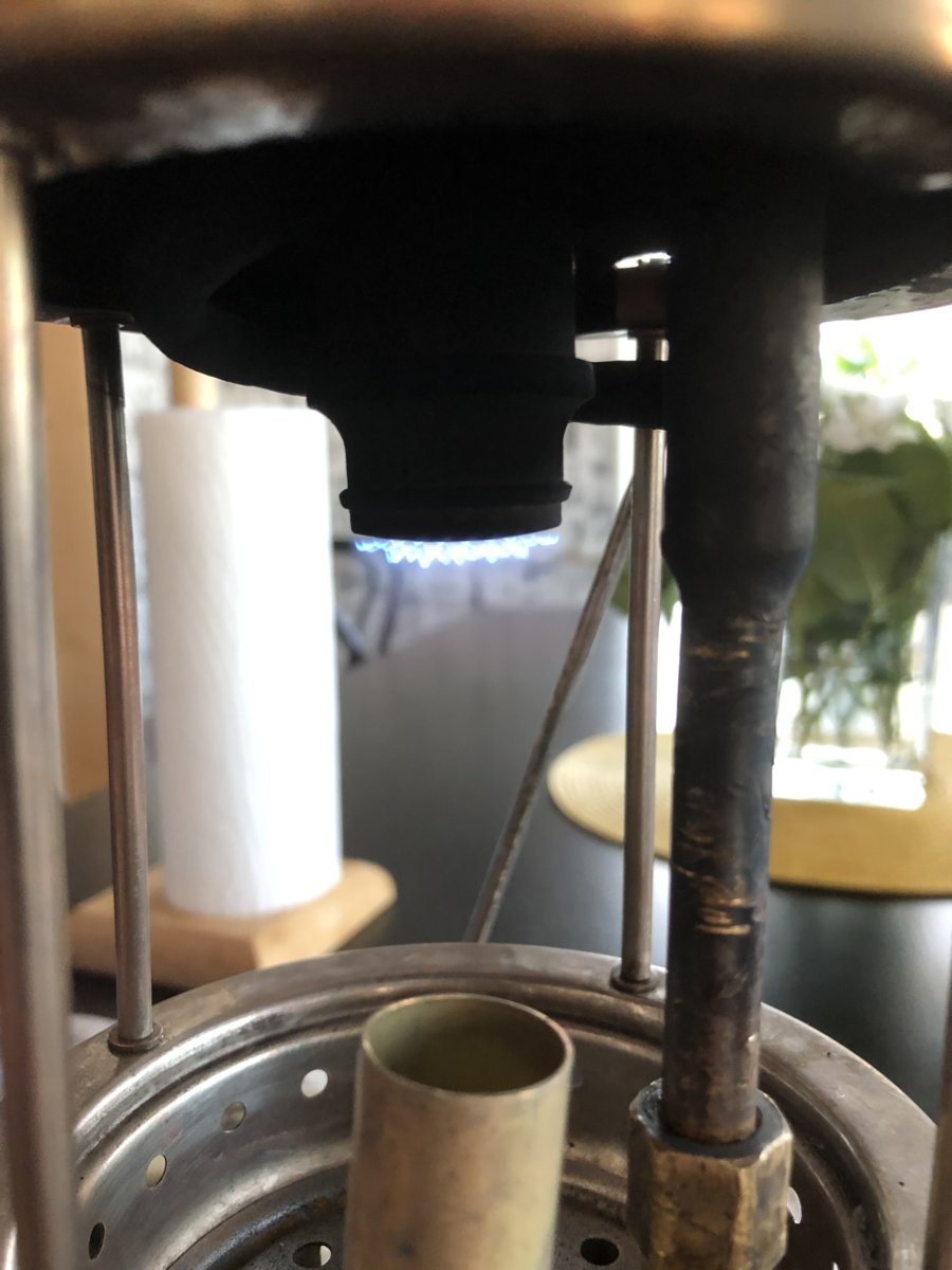

    Don’t know if it’s possible to upload a video here. I get some kind of error message when trying.
    Lamp burns with a blue flame, a bit flicker but it burns! Progress!

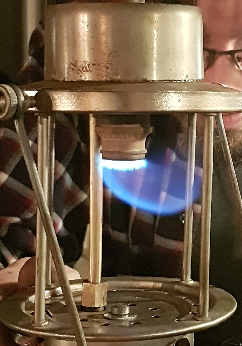

    The flames seem a bit small, maybe try some more pressure. I've got a picture with a lamp that is now doing fine:

    The flame's blue alright. Is that too small or is it just colourless due to the pictures?
    Anyway, it should be something like @Martin K. 's picture. And also, note @WimVe 's comments.
