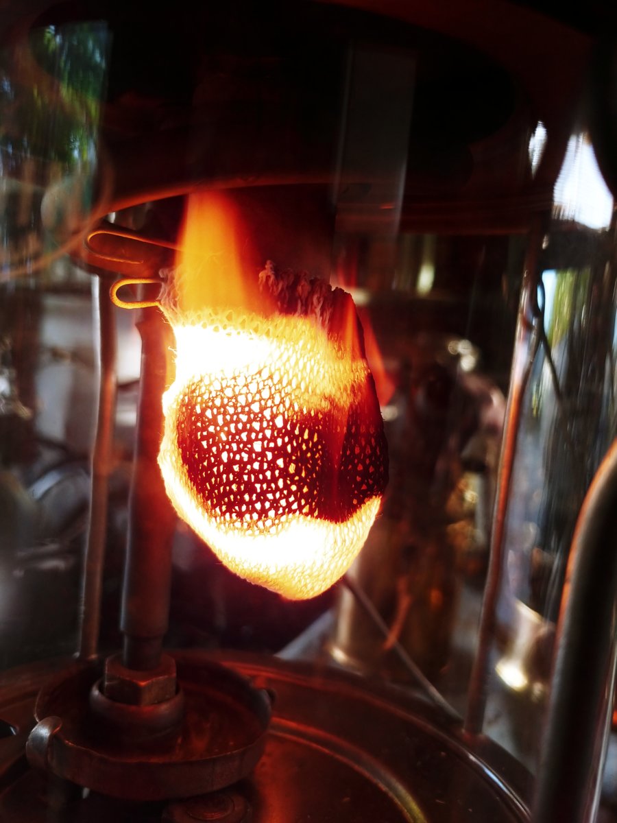

    I got it going so super glue holding but cant get mantle ignited (using a gasmate gm300 cos keen to see it lit)
    Seems to flame around it as per photo. Mantle gets blacker.
    Pressure seems good because when I release fuel filler cap there is a nice hiss.
    Fuel flows nicely out of jet (when off of course)
    Any thoughts?

    Check your jet is tight, check you air tubes for any blockage, and ceramick for any cracks

    Did you burn off the mantle before lighting with pressure, have you checked that the air/J tube is clear of wasps/ spiders.
    Is the Preston loop clear etc check by blowing through with a small round plug on a thin rod so air forced through loop (or use the pricker rod minus pricker) you will have to readjust pricker )
    The meths cup takes close to 3 minutes to pre heat did you heat long enough ?
    Clearng loop-- Bicycle gear change cable should work, curl end and feed in from top with jet removed and twist while feeding in. or heat and gentle tapping if you quench "MAKE SURE IT IS dry" before lighting as steam can burst vaporisers

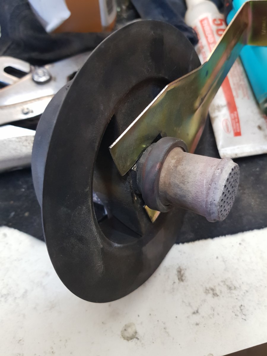

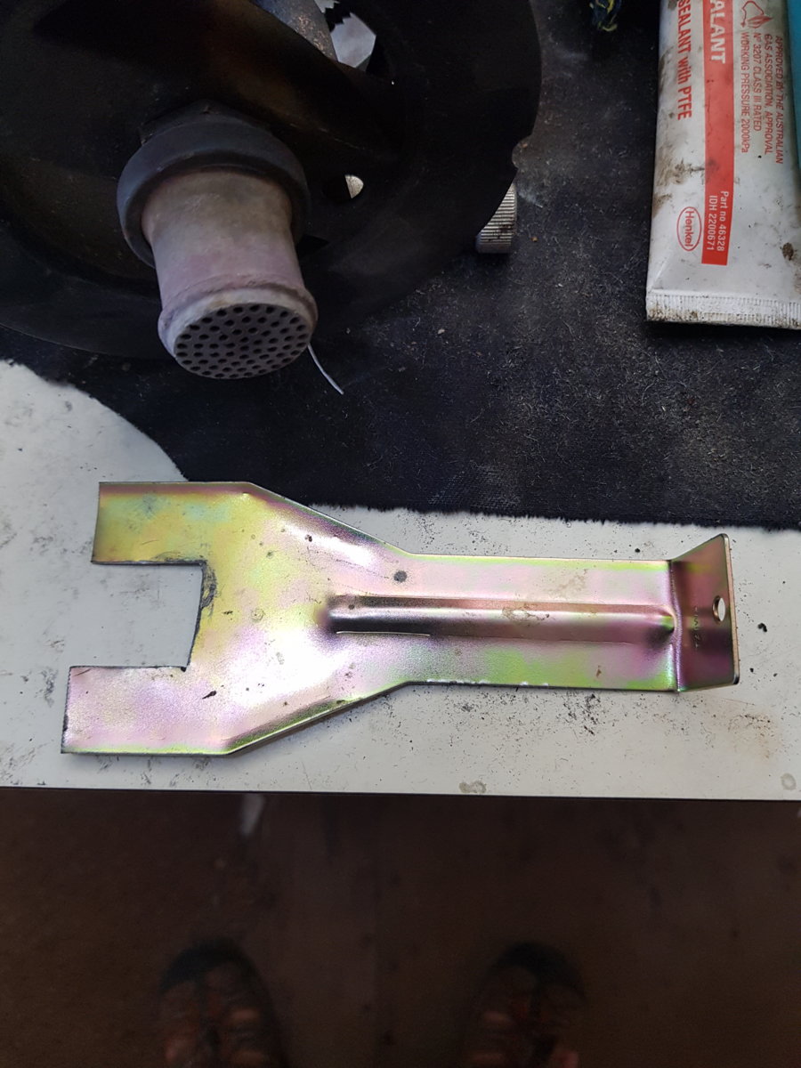

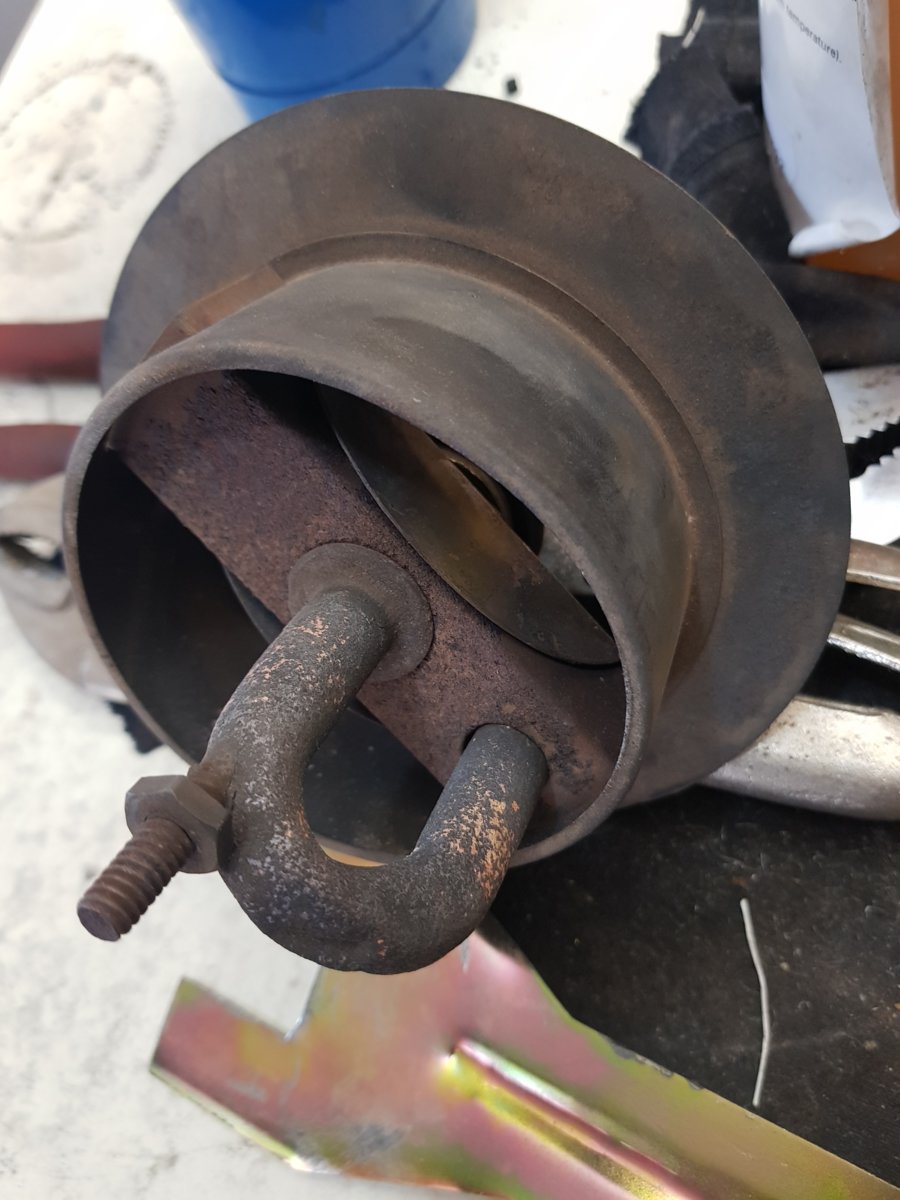

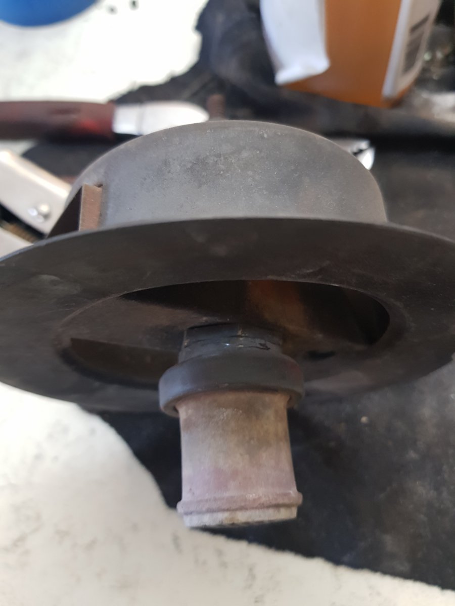

  15. Darryl Durdin
    1,650
    I made this from a car door handle remover, it works a treat, to access the hex nut, the round collar part screws onto the j pipe. Air intake. I use the pointy part of an old small wood chisel it bights in when tapped to rotate round collar under flange and ceramic burner
    This is the j pipe or air intake, it needs to be cleared .
    If you can dismantle it all give a good clean pup back to gether, it will work better, i hope this helps. As the fellas have mentioned above, stress cracks, in tank, take up the generous offer of a
    tank with no crack, safe act, safe condition.

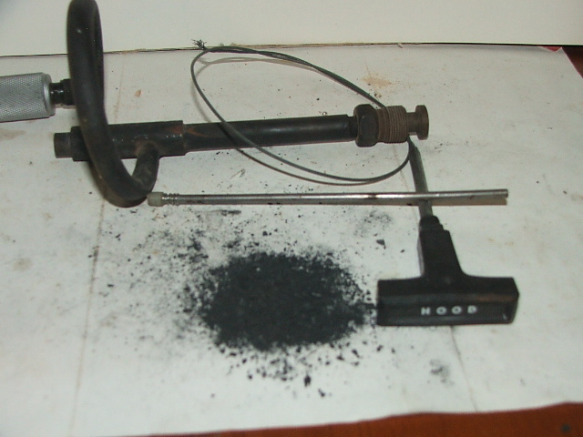

  16. Graham P Australia
    Mar 3, 2012
    982
    Albury area NSW AUstralia
    Here is an Aladdin vaporiser and the carbon removed by gentle tapping after using the stranded wire cable (which appears to have started life as a car hood release cable) it is 1.2mm overall dia and about 19 strands The other piece of rod has a plug to suit i.d of vaporiser between ends of preston loop (the thicker section of pricker rod is too small seal the vaporiser between ends of preston loop

    Confirm I burnt mantle off properly.
    Meth cup full and preheat was at least 3 min.
    J loop clean.
    Vaporiser clean. Used cable as you indicated and got into Preston loop. Not too much debris came loose, bike brake cable works its way through nice and easy.

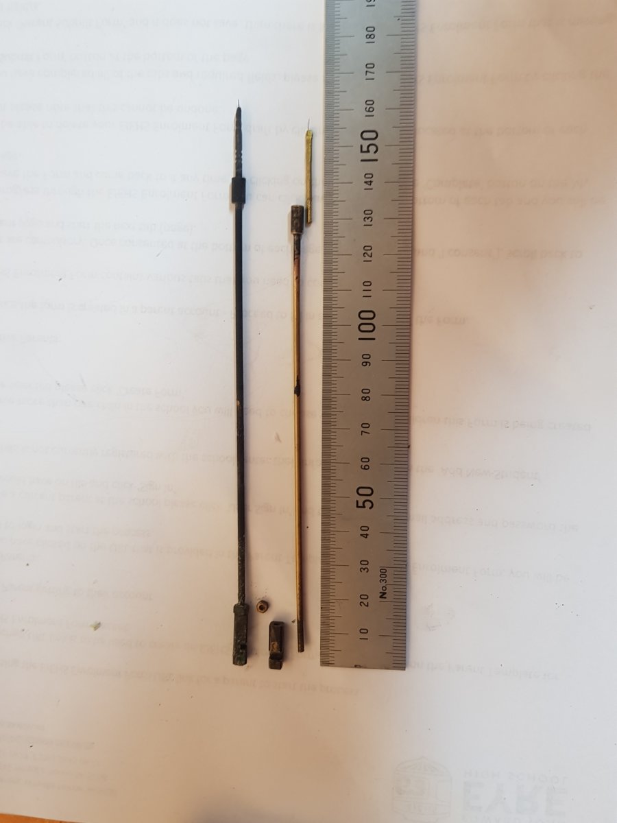

    So, it appears that with new pricker installed, the height of the pricker is not enough to go through jet when you turn the control valve. The thin brass rod that you screw the pricker into is simply not long enough. Could it be that this broke with a previous owner? When I unscrew this rod from the block that the control rod latches into, I can see there is only about 3mm of thread.
    Is it possible to get a new pricker supporting rod? Or is there a substitute?
  20. Darryl Durdin
    1,650
    Hi John, the rod screws into the ecentric block, there should be about 10mm of thread, there should be a small locking nut, this is where most of the adjustment is, it only needs a few threads and lock in place, also where the pricker screws into, you can adjust it here as well, send me a picture of what you have and whats happening, no need to buy pricker rod ill send you one, i have plenty of Aladdin parts, if you do look for parts Radius 119 needles, rod etc are the same,
    I will post some pictures of the whole set up
    I hope this helps

  22. Darryl Durdin
    1,650
    Hi John, here's a picture of an assembled pricker and rod and ecentric block, and a break down, you should have enogh thread, if yours doses not look like mine, something is amiss, ive added the ruler for a guide to lengths, 20200129_071444.jpg
