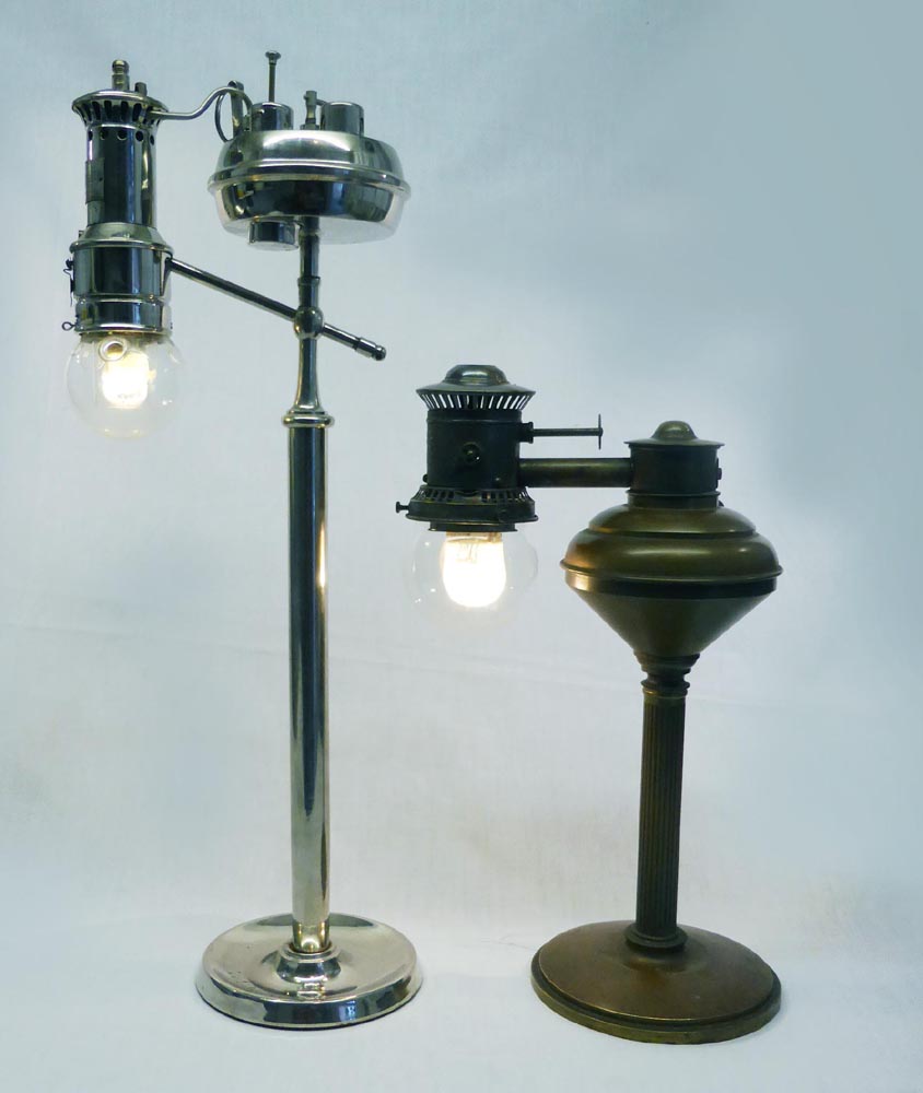

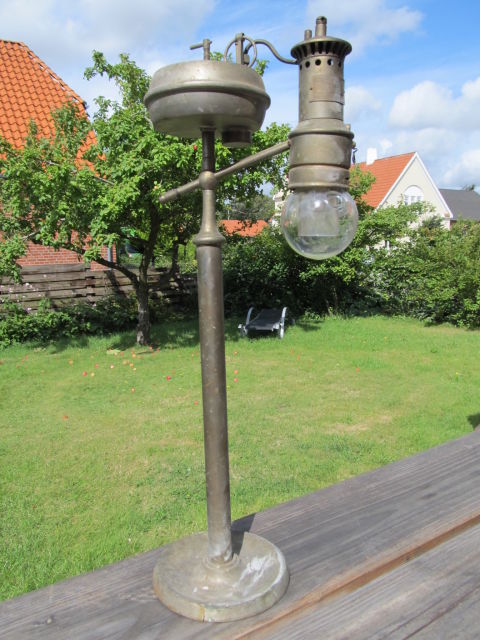

    I will start with a old known one I just got the globe for, the Wiktorin-table lamp:
    Cleaning will be done some day and it is to be seen in action from Conny's fine youtube link under Chuck Hays introduction.
    But I couldnt help thinking there must be some other nice alcoholburners out there pressurized or not and I would like to see what is hiding out there if anything is ?

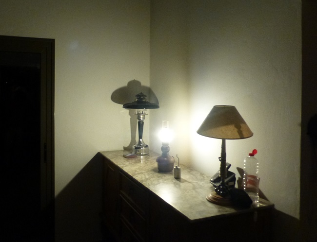

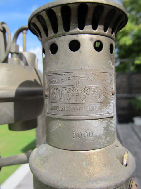

    Hi Claus,

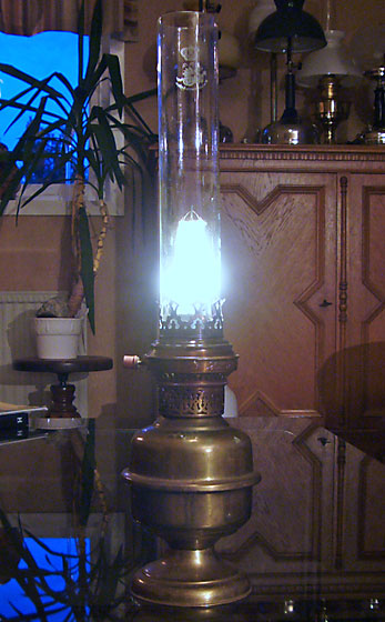

    Here are my "two" best non-pressure alcohol lamps; the Wiktorin 5000 (my avatar) and the Gral no.1 Hugo Schneider lamp.
    /Conny

    Stunning lamps Conny :thumbup: I hope my Wiktorin will look just a bit like that soon. I already started cleaning O:)

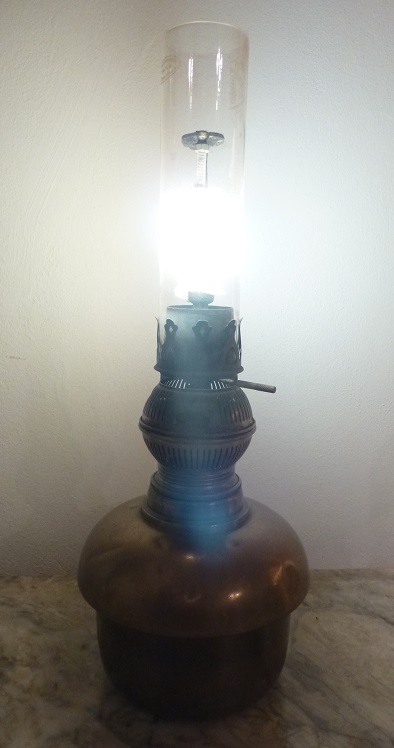

    I'm not sure if it is my best alcohol lamp but at least is my only one in working order.

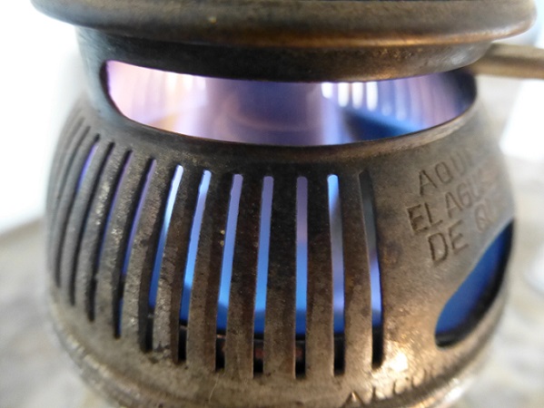

    It is a Comalumbra, made in Argentina in the '30s. They are supposed to run on "alcohol carburado" which seems to be ( or used to be as no one knows) a mixture of alcohol and some carbon fuel. It runs fine on alcohol.
    It gives a decent and brilliant light, perhaps the half of a good working 100 cp lantern. 30 - 50 cp?
  9. Claus C
    Dec 18, 2012
    1,787

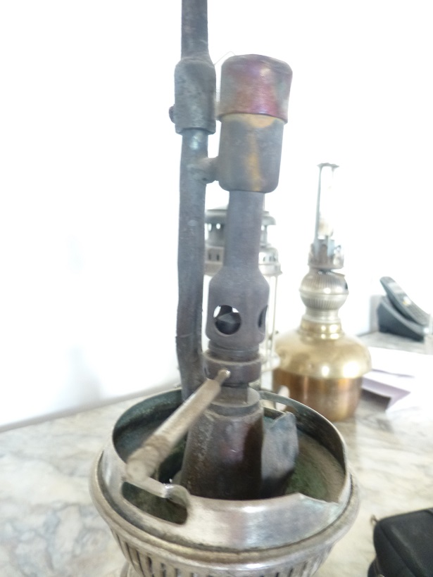

    WoW Juan. You always surprise me in a good way. I have never heard of this lamp. :D/
    I would like to see the burnersystem one day without mantle and gallery. :-k
    It seems to be like the Tito Landi, HS2, but something is different in the top and side of the burner.
    It also looks like it has a inboard preheatercup. The stick on the side is that for adjusting the wick??
    And it gives a awesome light :thumbup:
    What a nice lamp Juan. Thanks for sharing.

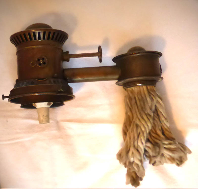

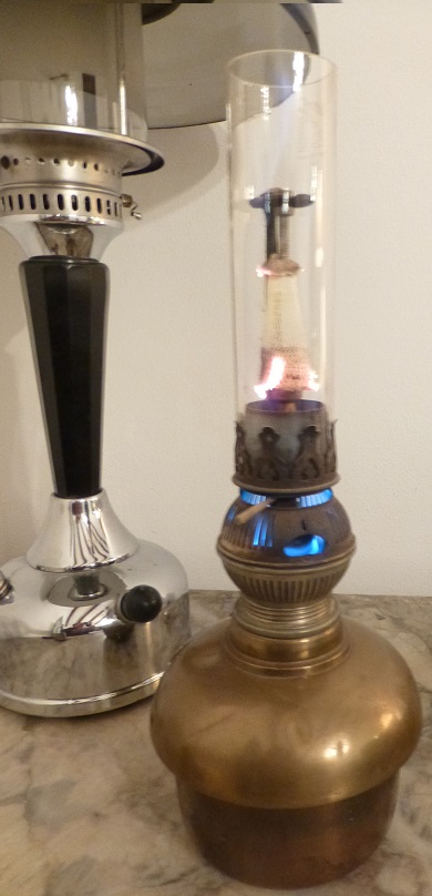

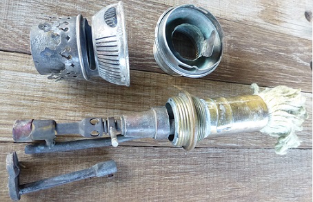

    I'll take some pictures of it taken apart. It works in a similar way to Tito Landi lamps and no, the lever works opening or restricting the valve/jet.
    I have three of these lamps, one with the same brand but made in Germany.

    Here they are.
    1408923262-P1070700.jpg 1408923278-P1070701.jpg 1408923291-P1070702.jpg 1408923374-P1070704.jpg
  12. Claus C
    Dec 18, 2012
    1,787
    Nice Pictures Juan and the lamp just came on my wishlist.
    It doesnt look like a "copy". They did some thinking and futher designwork apparantly to a existing burnerprincip. Me like :thumbup:
    Do you know if these lamps ever came with a shade besides the chimney?

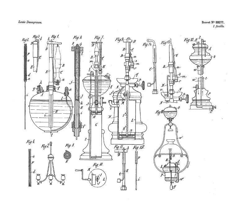

    I believe the "Denayrouzine" concept is associated with the French inventor Louis Denayrouze as he from at least 1895 to 1908 issued a dozen patents with numerous drawings of many different types of wick fed mantle burners. I've also seen paperwork that use "Denayrouze" as a generic term for a certain type of both gasoline and alcohol fed early wick burners. The one you refer to from Lamp Guild is the burner that was launched in France by Boler as the "Boler" burner.
    However there are also Denayrouze patent drawings that is quite different and in many ways looks like the Comalumbra burner, see attached drawings no 6,7 and 9. I have no doubt that Comalumbra is an original made South American burner, but made from original patents of Louis Deanayrouze. The Helios catalogue comes from Montevideo, so Uruguay is the probably the origin for these lamps. I've also found a Comalumbra ad from Buenos Aires so maybe it is a product spread to the whole South American continent.
    /Conny

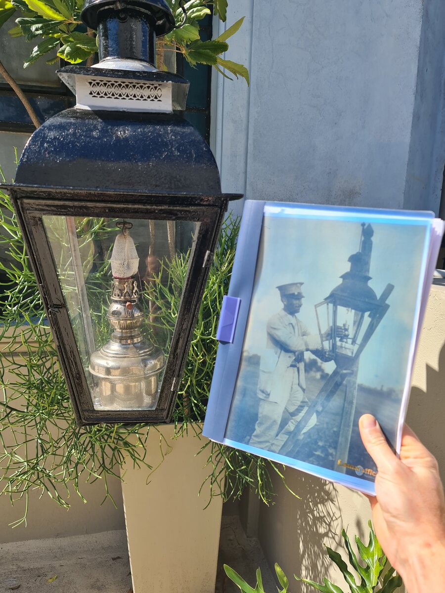

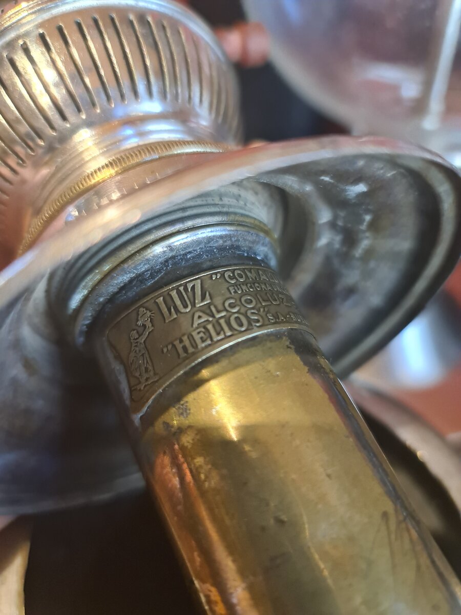

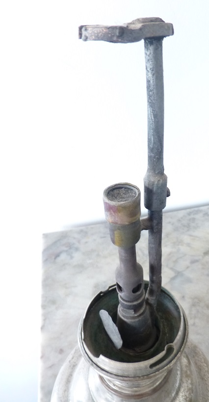

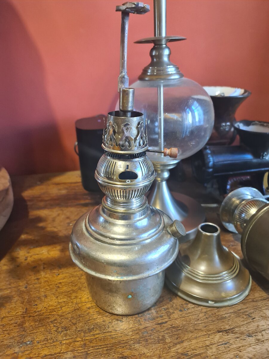

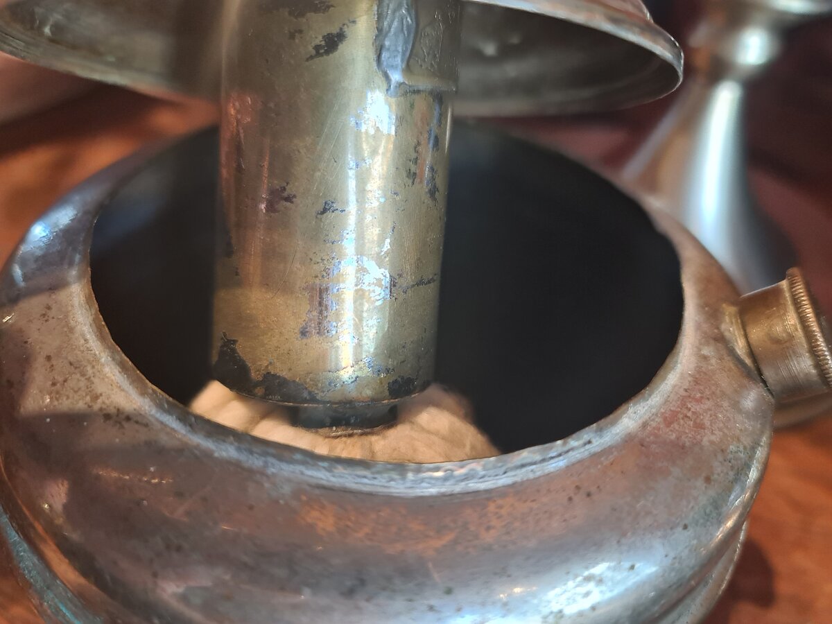

    hi, i just bought 3 of them... but like usually incomplete. who does the cap looks like (the burner hat with coat, that is hanging on the hammer?
  23. didier Argentina
    Dec 24, 2020
    83
    buenos aires Argentina
  24. didier Argentina
    Dec 24, 2020
    83

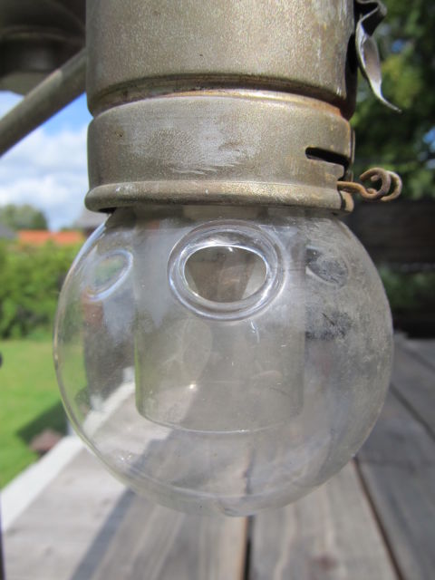

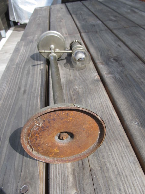

    how to put the jacket on?? what is the size of the jacket? where can i buy these.
  25. Fireexit1 United Kingdom
    3,525

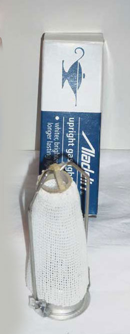

    Hi Dider, "Camisa" o "Mantilla" = "Mantle" in English
    You will probably have to make one from another mantle for a different lamp, or you may be luckier closer to home.
  26. Conny C
    Conny C Sweden Subscriber
    957
    Hi Didier,
    I think most likely an Aladdin Upright mantle would fit on your burner!
    /Conny
  27. Juan
    Dec 2, 2010
    975

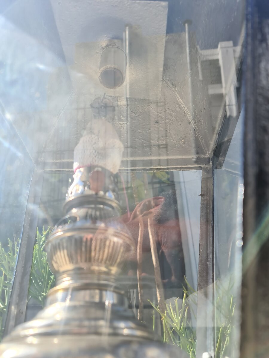

    Hi Didier.
    I made my own mantle because you won't find any inverted mantle in Argentina.
    Your lamp has missed a little cap with a wire net on the burner's top.
    The fuel used was "alcohol carburado". Over the years I researched a lot but I could never find an answer to the question: what does "alcohol carburado" mean. I use regular ethanol on this lamp and it works. Not a great light but it does something, at least...

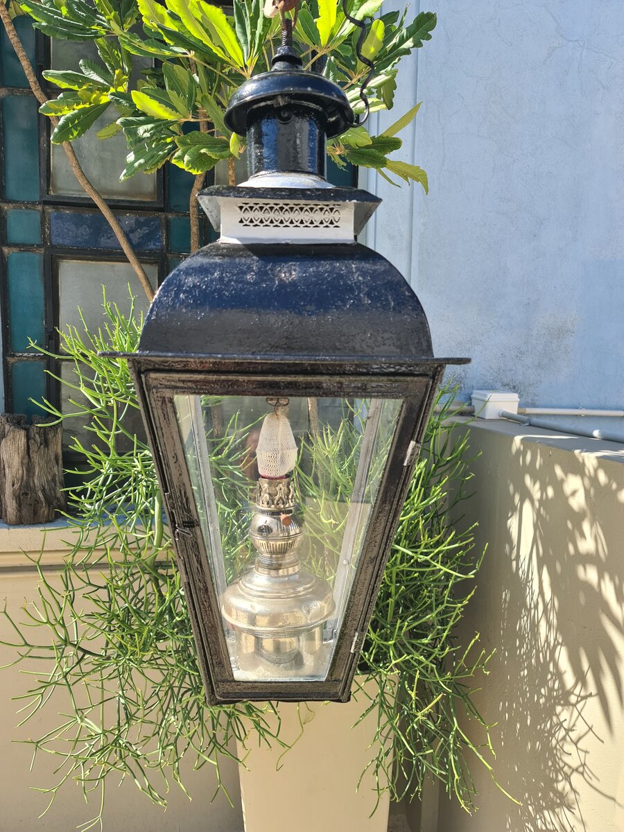

  29. didier Argentina
    Dec 24, 2020
    83
    Hi Juan,
    are you from Argentina? but right imposible to find the mantle. i will try with ethanol too and i will let you know.
    as you can see in the picture, i also made one on my own. with 2 circles inside... a small on the top and a bigger on the bottom... looks good i must say.

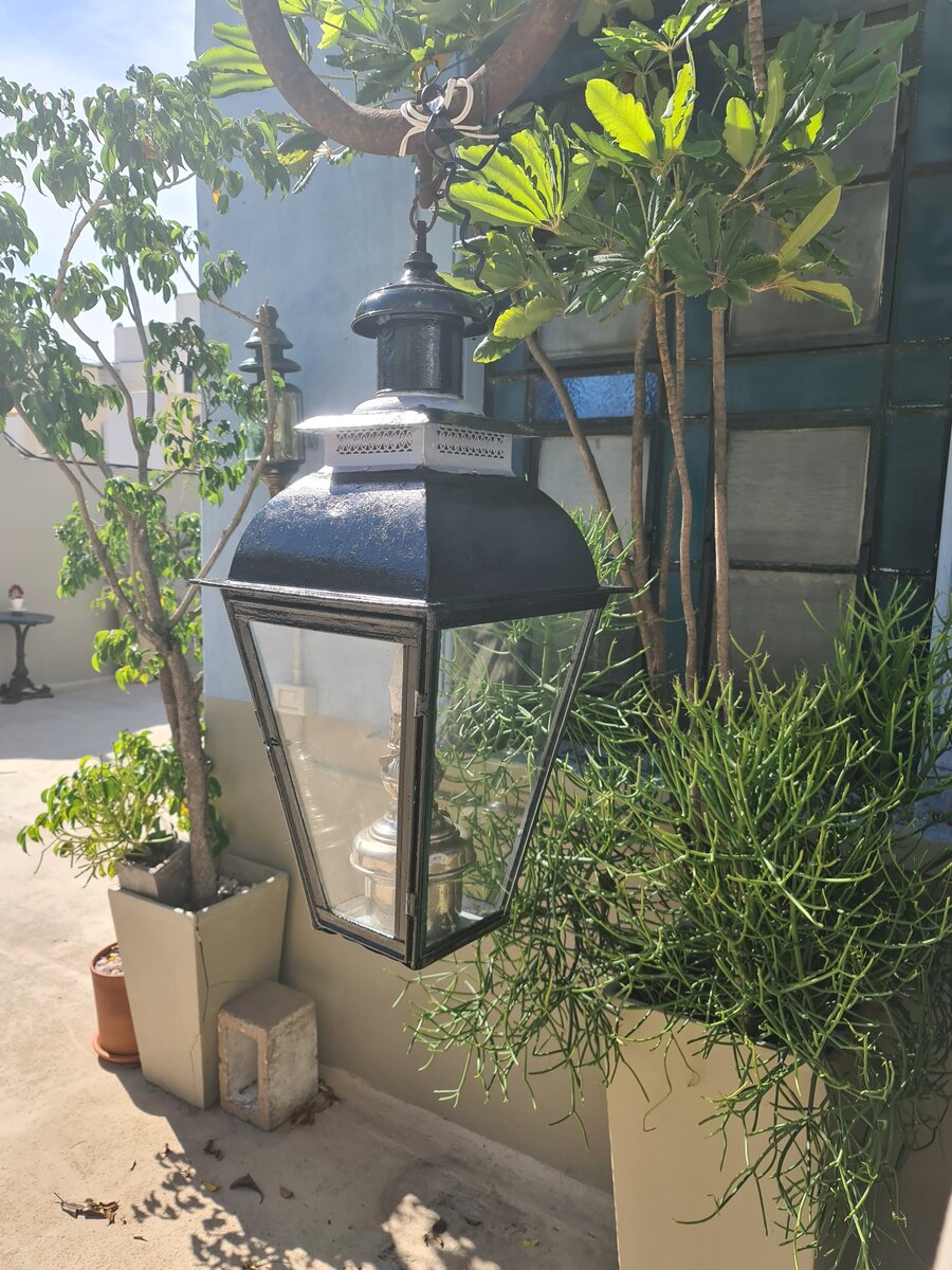

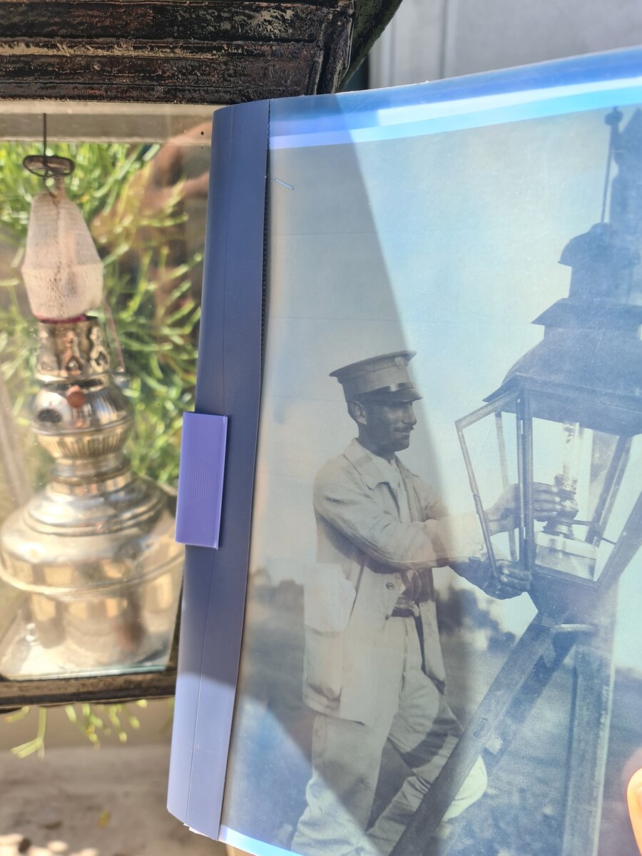

    pS> this street latern has been modified with a electric lamp. but they did not changed fysically the latern... the last latern on Kerosene worked in Buenos Aires till the 1931
    he last Buenos Aires bluff, 1931.
    AGN_DDF / Box 489, inv: 75916.
    On April 1, the municipality installed 208 alcohol lanterns in the city, reaching a maximum of 2424 lanterns installed in 1918, which were replaced due to the shortage of alcohol during the Second World War (1914-1918), they were replaced by kerosene lanterns, until 1920 when alcohol lanterns were put into service again, reaching their peak in 1927 with more than 5000 lanterns installed, these devices were in charge From different groups of the lighting management that having the function of lighting them, recharging the fuel and their general maintenance, these characters who carried their stairs on their shoulders wandered through these forgotten streets were «Los Faroleros».
