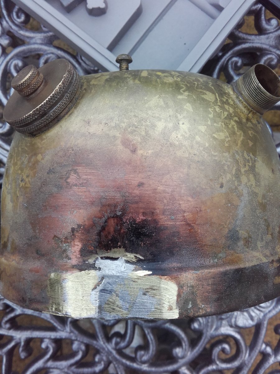

    Hi everyone. Recent update after stripping paint off the lantern. The small pinhole as mentioned is now a little more serious. There is a slight crack at the bottom of the tank.
    Can this be soldered or scrapped
    Thanks

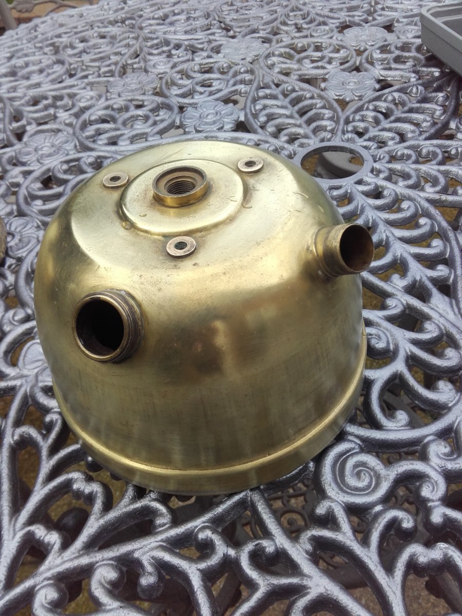

    20171117_134217.jpg 20171117_134209.jpg 20171117_134217.jpg 20171117_134200.jpg Cleaned split ( dremelled to an inch of its life) soldered. Checked pressure -no leaks. Hopefully happy days. Picked another font up excellent condition but smaller filler size.
    Would it rearly matter or why did they change from large to small
  12. Simon Cresswell United Kingdom
    Oct 21, 2017
    56
    Manchester
    Sorry for the duplicate pictures of New font

    If your solder has bonded in the crack and on the surface of the dremelled area, your tank should be fine.
    Test it under full pressure.

    Have filled it with water and pumped it up with my finger over the vaporizer hole.
    Is there a better way to test it to full pressure.
    Thanks
    Simon
  17. Tony Press
    11,090
    @Simon Cresswell
    That’s a good start.
    Of course the ultimate test is to put the lantern back together and fill it with kerosene, pump it up and see what happens.
    It’s looking good so far.
