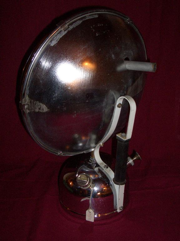

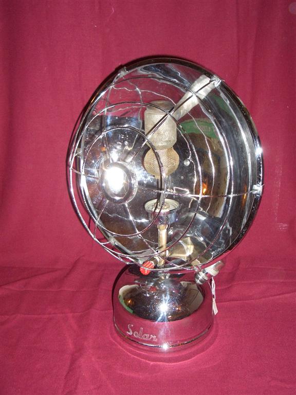

    Here is my last restoring object, a Solar heater.
    As been told in other topics, this brand seems to be very solid and of high quality.
    This one looks like a copy of a Tilley and a Bialladdin but I have no idea when it was made.
    It is not very old, maybe from the 60:s?
    The most spectacular of this one is the fittings and the guard itself. Must be unique for this model. One odd thing to note, is the not symmetrical placed air inlet tube. A bit hard to see on the image though. No idea why it is that way.
    Unfornately is the pump knob not original and the pressure meter/filler cap looks like it has been modified. Anyone that knows how the original looks?

    Good one - if it hadn't been for the word 'Solar' on the front I'd have thought it was a Tilley R1 with an earlier burner fitted. The control cock knob does look like Bialaddin.
    I've no idea why the air intake is offset, though - perhaps to save you coming into contact with it when you picked the heater up (not that you were supposed to move a heater whilst it was lit...)

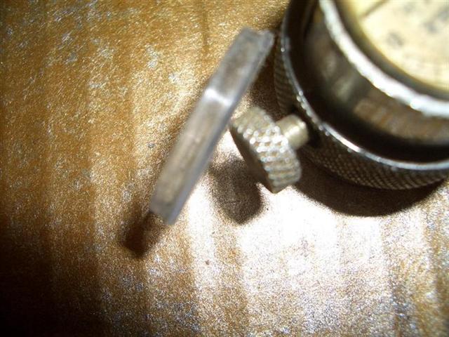

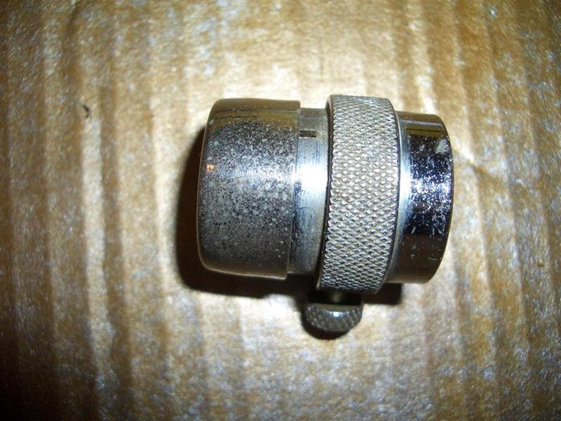

    Here some photos showing the pressure meter.
    The base is original I guess, maybe also the cover but the I am doubtful about the glass.
    It is plastic and has a rim that makes the cover rise from the base when mounted. Maybe the original had a glass plate. Signs from a small stop screw is also visible, now broken.
    I believe this item was used on all Solar products so maybe someone has an original and can tell what it looks like.

    Hello BO, the link below shows a Solar lantern and there is a good close up photo of the pressure gauge, Jeff.
    Solar 200cp
