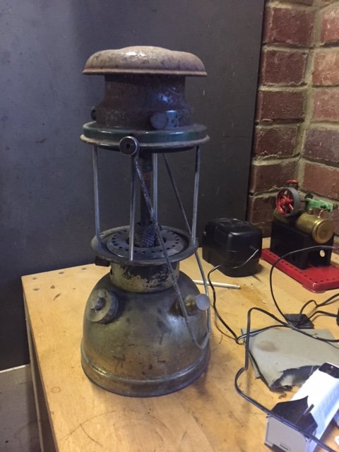

    Pics as requested. This looks professional and the bottom of the lamp is not blown. Thoughts before i spend much time fixing it. Can someone also confirm it is a 305?

  7. Mackburner
    The model number should be marked on the collar. However the 300 and 305 are near identical. The only difference I have seen is on a 300 the globe cage rods are riveted in place and in 305 they are held in with small machine screws. ::Neil::
  8. Manlee
    Sep 4, 2015
    51
    It does have screws rather than rivets. But the collar shows no markings at all. Dark green paint is on it in patches but no other markings at all. Would this be military?
  9. Mackburner
    Sounds like a 305 then. I can't remember seeing an unmarked example so that is perhaps rather odd. Military? Who knows? Air ministry stuff in grey was sometimes marked but in general army green were not. It is a civillian model and the army used civillian lamps so maybe or maybe not. ::Neil::
