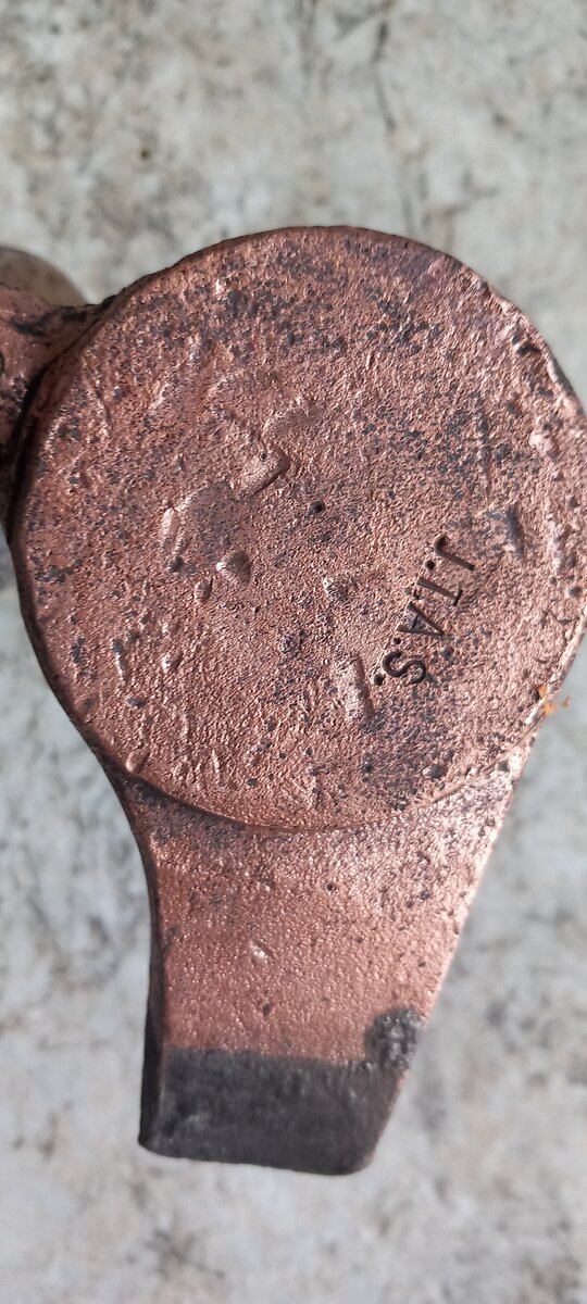

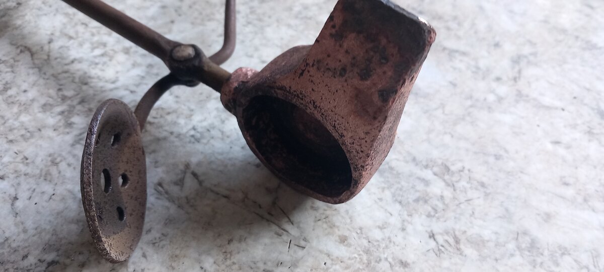

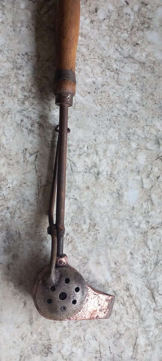

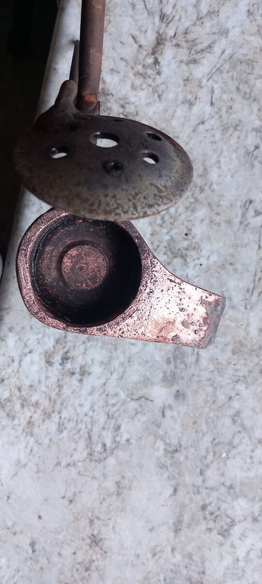

    No doubt this is a soldering iron, what did you use to get into the hole.
    Is there charcoal or liquid fuel?
    It is stamped J.T.A.S, which I know means Jysk Telefon Aktieselskab.
    Tom

    Never seen one before! But anyhow, this is what I think. The JYSK telephone company was the user, not the maker, the marking stamped in to prevent theft. The way I see it being used is with a small field forge to get the soldering iron up to using temps and at the same time a fat ring (kinda donut shaped) of iron or copper also being heated in the forge. A hook can be used to lift it out of the heard and drop it in the soldering iron. To keep the iron hot one changed the donut for a fresh hot one when needed. It is obvious this would be for outdoor use, laying new telephone lines etc., in the factory gas heated irons would have been used. BTW, judging from the colour in the photos this would best be called a soldering copper, not iron.
    So, this may be a load of male cow droppings ;) but that's what I think might be how it worked....8]

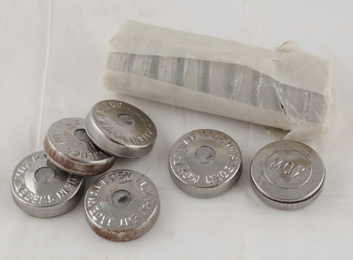

    The mystery is solved. An older employee from J.T.A.S has approached me. He wrote that something called MOX Cartridges was used. These consist of pure phosphorus, which sputtered terribly when ignited, and they developed a colossal heat. He wrote that if you put one on a shovel blade it burned a hole in the shovel blade.
    No heat source other than these cartridges was used

    I've never seen a soldering iron like that. That's certainly different:).
    By the way, is that a copper tube hard-brazed to the chamber with vent holes?
    It looks rather like a tube by which air could be forced blown into the chamber.
    The chamber might function as the location where the combustion of some solid fuel could take place to generate heat. The solid fuel could possibly be charcoal. Air is forcibly blown-in to supply oxygen for combustion.
    Could it work that way?

    Great iron.. i have seen similar in poorer condition and always assumed they had iron ‘slugs’ which were swapped with others that were heated.. similar to the clothes iron types?
    Perhaps there were different ways of using them?
    @MYN there is a pierced cover with a long handle that swivels to allow access ?(most visible in the last photo)
    intriguing how tools adapted and changed over time..

    Here is a link where you can see fuel for the soldering iron. They consist of pure phosphorus.
    Moxbrikett
    Tom

    Thanks for the link. Very interesting! Never heard of these, and they seem to be pure energy. Quite dangerous, I assume.

    I have been told by an older telephone technician who has used it that it continued to burn even if you threw it into a bucket of water.
    Tom
  15. MYN
    @Tom Pedersen
    That makes it even nastier :mrgreen:.
    White phosphorus is spontaneously combustible in air. Red isn't.
    Phosphorus has a density than is greater than water. Therefore, regardless of whether it is red or white, phosphorus should sink in water. The flame should extinguish once the phosphorus is underwater and starved of oxygen.
    Now if the Moxbrikett stuff could continue to burn underwater, it means the stuff contains an oxidizer in addition to phosphorus as well.
    It is almost going to make it similar to thermite incendiaries :mrgreen::twisted:.
