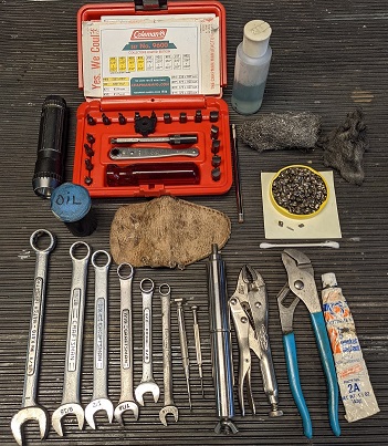

    This is my baseline set of tools to disassemble a lantern or stove.
    Starting in the upper left; a flashlight to inspect the inside of the fount, a good set of hollow ground screwdrivers. This is the set Chapman Tools put together for CCF a few years ago. It is their 9600 basic set. Hollow ground screw drivers will help you not bugger up screw heads. They still sell this set for under $40. The bottle is simply water with a few drops if dishwashing liquid. That is my leak detector. Fill the bottle half full or less, shake vigorously to make suds the spread some bubbles on the various connections. With the fount pressurized leaks will blow bubbles in the soap suds. I find this quicker and easier than a dunk test as I can do it on the workbench. There are times when it is still necessary to resort to full immersion, especially if you suspect holes in a fount. Next is a telescoping magnet for retrieving burnishing shot from the inside of a fount. Coarse and fine steel wool. Coarse for cleaning/polishing bails on lanterns, fine for general cleanup and polishing. In the yellow cap is burnishing shot. As you can see from the pieces on the paper, it comes in different shapes. It is normally used in a tumbler to polish metal castings but I found it’s excellent for the BB dance. The sharp edges and different shapes do a good job of cleaning up the inside of a fount. I bought 5 pounds, probably 40 years ago, not knowing any better. A pound would be more than you need. A plain old Q-tip. Makes one of the best cleaning tools going.

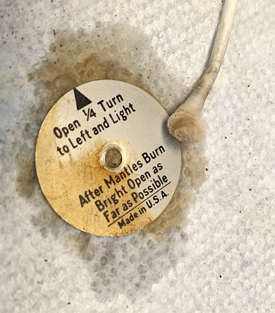

    This was just a couple drops of soapy water from the leak detector bottle and a bit of scrubbing,

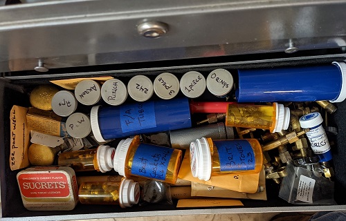

    Below the screwdrivers a piece of leather. In this case the top piece out of an old pair of loafers I was throwing out. Used to pad fuel caps and other things you need to grab with pliers to loosen. A plastic film canister with about ½ inch of oil in the bottom. Drop your dry pump leather in there and let it sit while you’re doing other things.
    Film canisters and pill bottles also help organize the over-crowded tool/parts box.
    Bottom row, a set of decent quality wrenches. These six will do most of the work, especially for Coleman products. Some of the other brands use some bigger sizes, Preway pumps, for example. Two jeweler’s screwdrivers sized to fit fuel cap gaskets. I don’t like burning out gaskets and find I can chisel and scrape out the hardest ones in under five minutes with these and a small mallet. More on that later. Check valve tool, not absolutely required but if you have it, it only takes seconds to remove, clean and reinstall the CV. Easy to make it part of every rebuild. And once you’ve buggered up a CV and maybe ruined a fount you’ll wish you had bought the tool. The small Vise Grips are handy for holding small parts when cleaning, especially with a wire wheel. Channel locks for fuel caps and other things that haven’t come loose in many years. Should always be used along with the piece of leather.

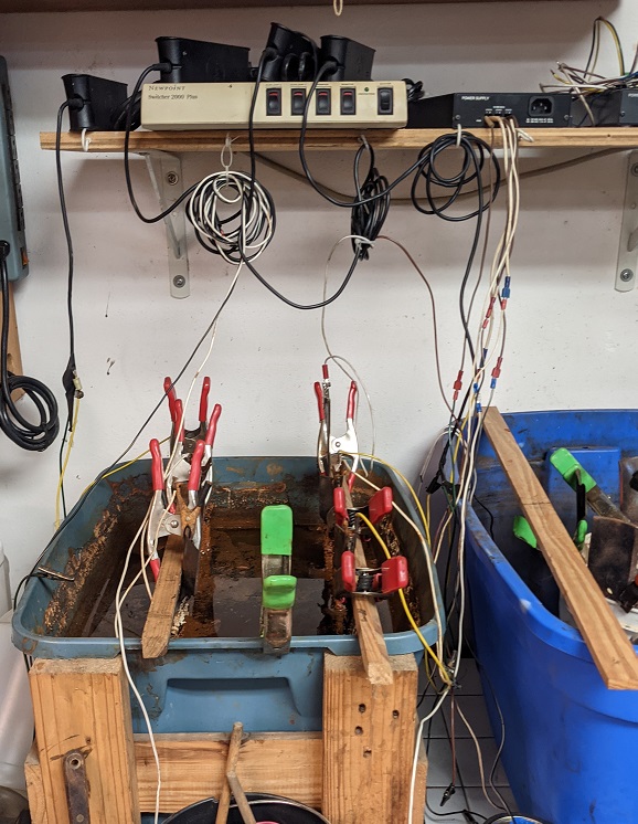

    Last but not least the electrolysis set up. The tub is big enough for a 413 case (barely) but it's the easiest way to deal with rust. The two sticks shown each hold 3 old lawn mower blades as sacrificial anodes. Power comes from 4 laptop power bricks and a regulated power supply that has 3 12V-3A outlets. You can drop a crusty burner frame ii and while you're fettling the fount and valve it's cooking away getting rust free.

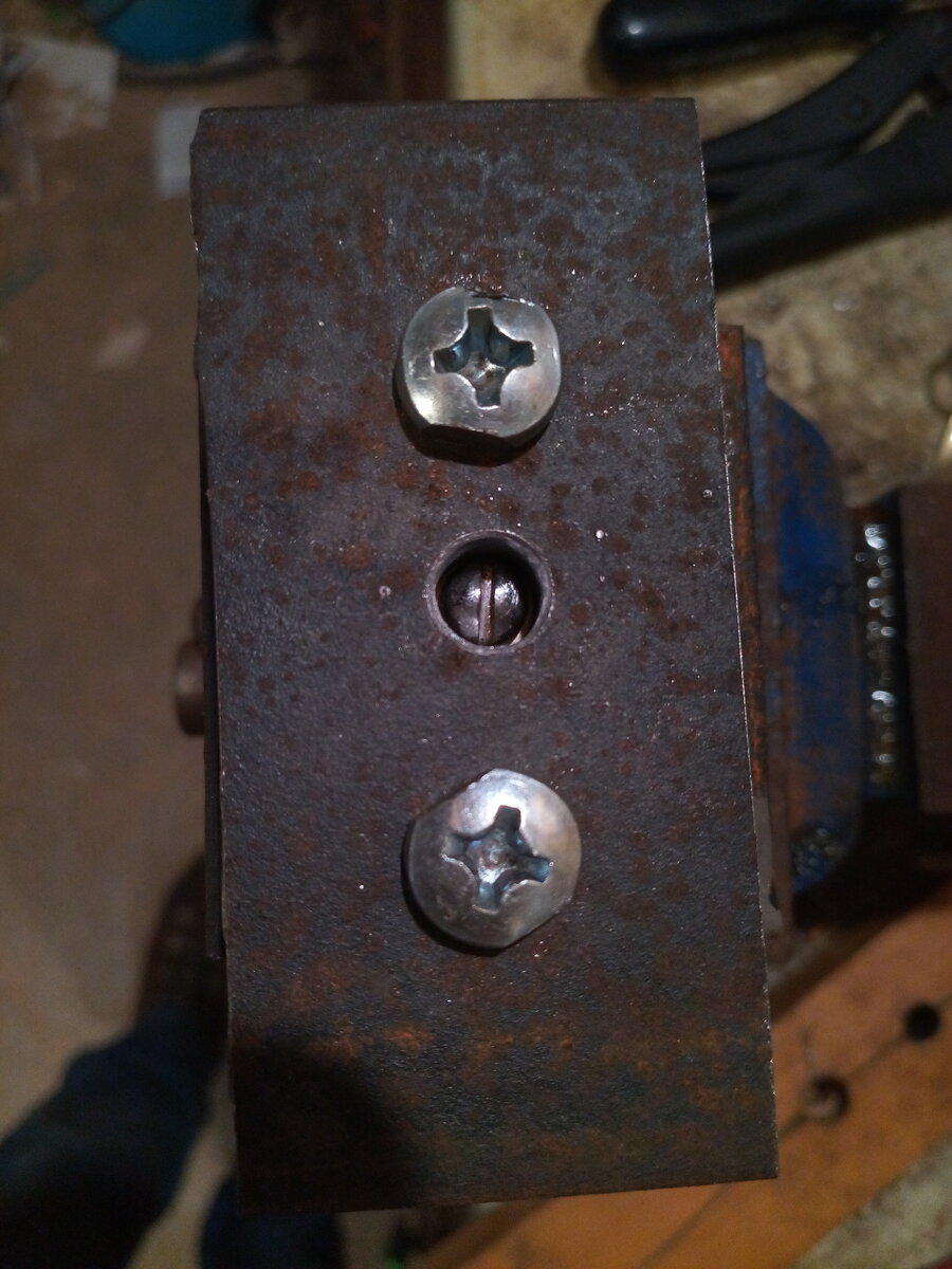

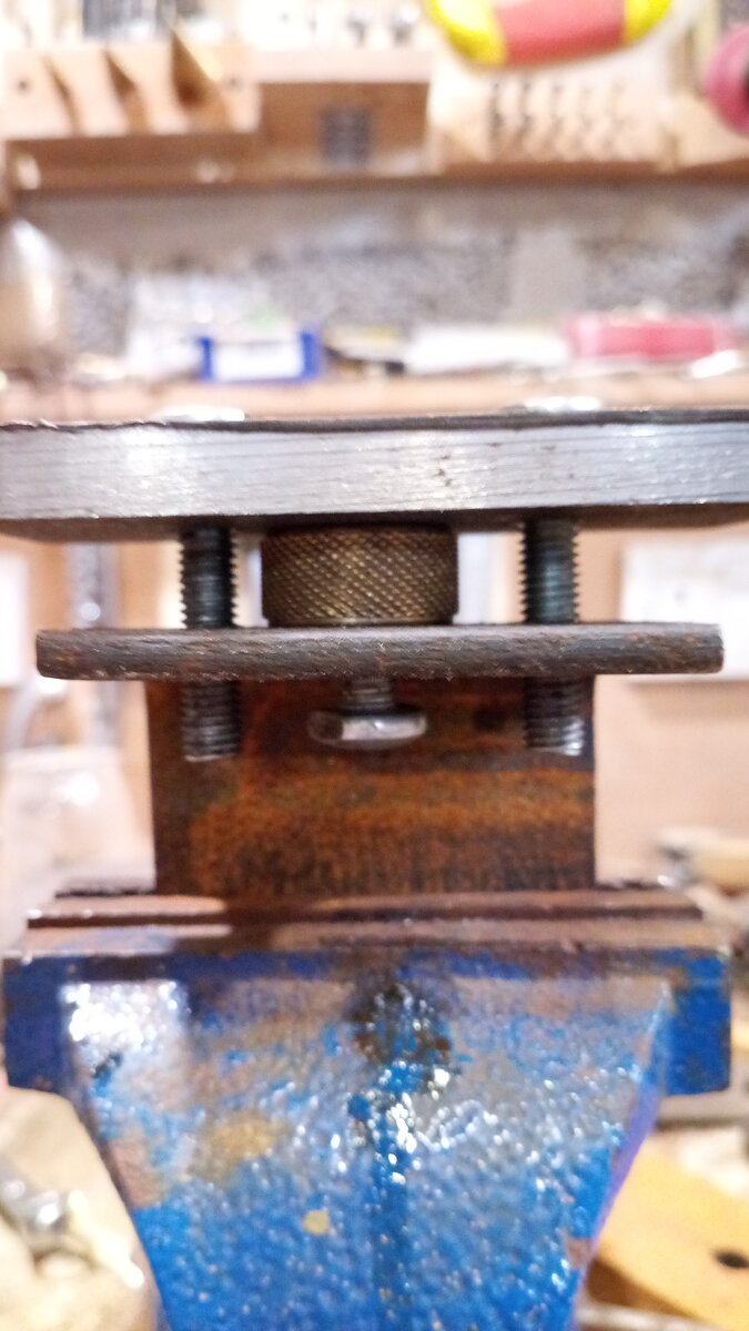

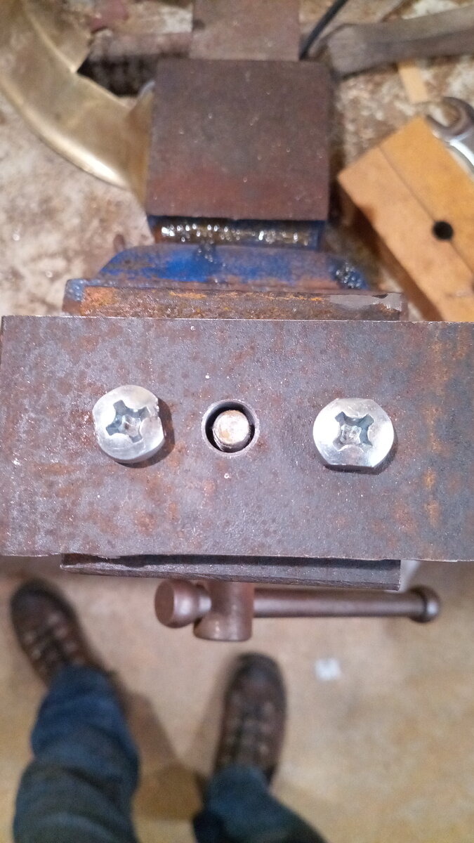

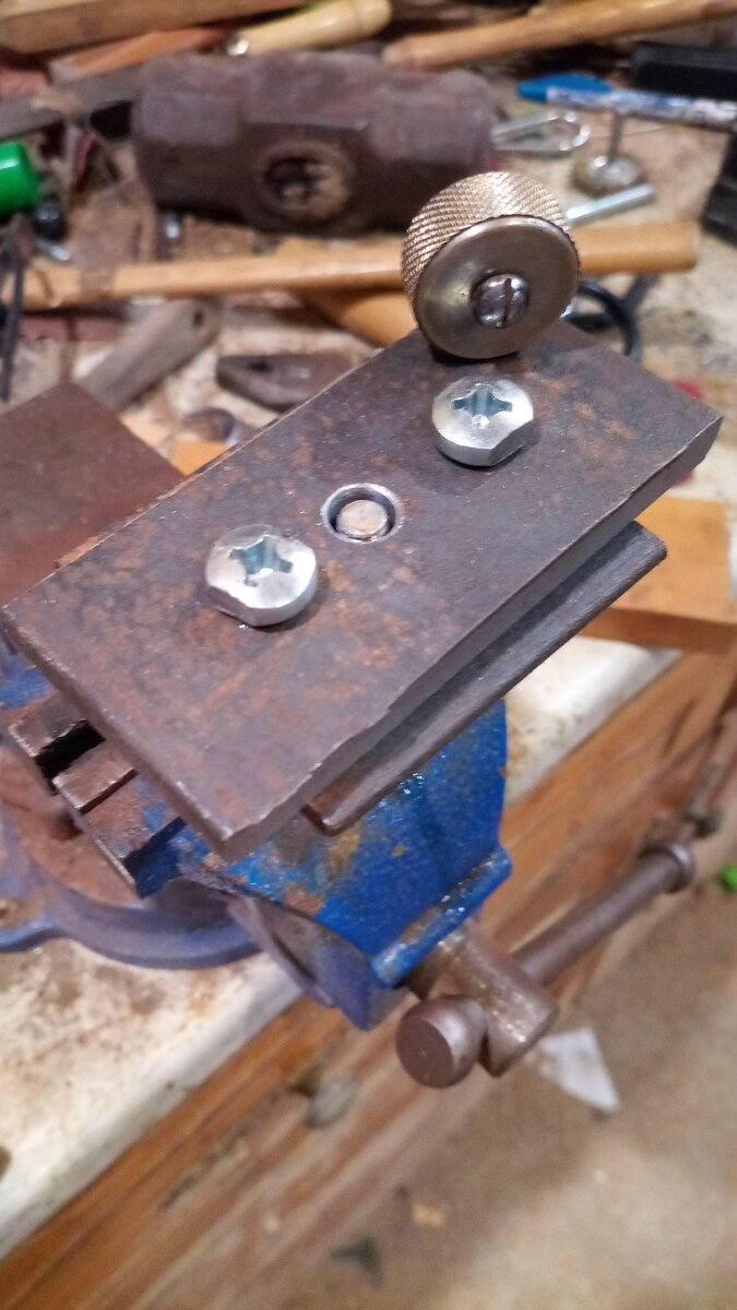

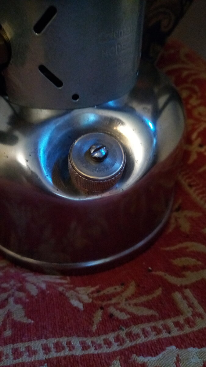

    Sometimes you need to make your own tools which is what I did to remove the centre screw from a Coleman 3 piece fuel cap. It had been tightened ridiculously tight at some point in the past so I made myself a clamping jig from a design I saw on one of Camp Wounded Dog Workshop's YouTube videos. Thanks fella, without your idea the wretched screw would still be stuck fast!
    Here's my version made from offcuts from NewCo in Fort William. They very kindly allowed me to raid their scrap bin and pretty much take what I wanted. I can see myself taking some more trips down there!
    Here's the dual cap in position.
    And back on the tank again.
    I had to work with what I had laying around so as I didn't have any hex head 8mm bolts I made do with pozidrive headed machine screws and ground 13mm flats on them so I could clamp everything good and tight with a spanner. Once it was secure in the jig, the fuel cap centre screw gave no resistance at all, enabling me to replace the O ring very easily.
    The 220x is nearing completion but the check valve needs removing to sort out some issues, possibly a full replacement as the slot looks slightly damaged. I will post about this when I've made myself an extraction tool.
