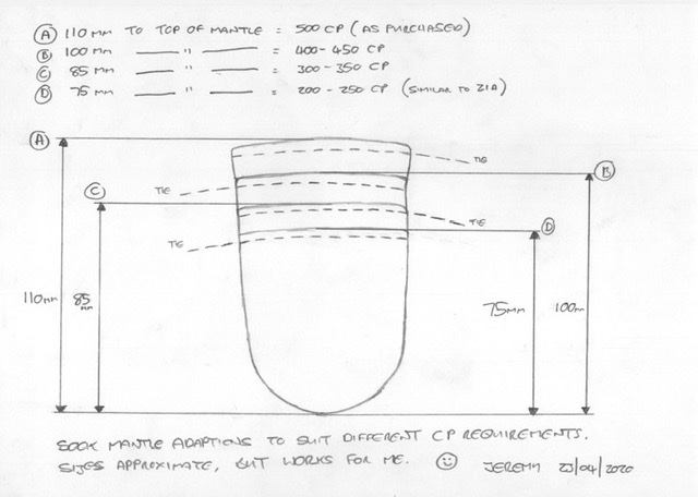

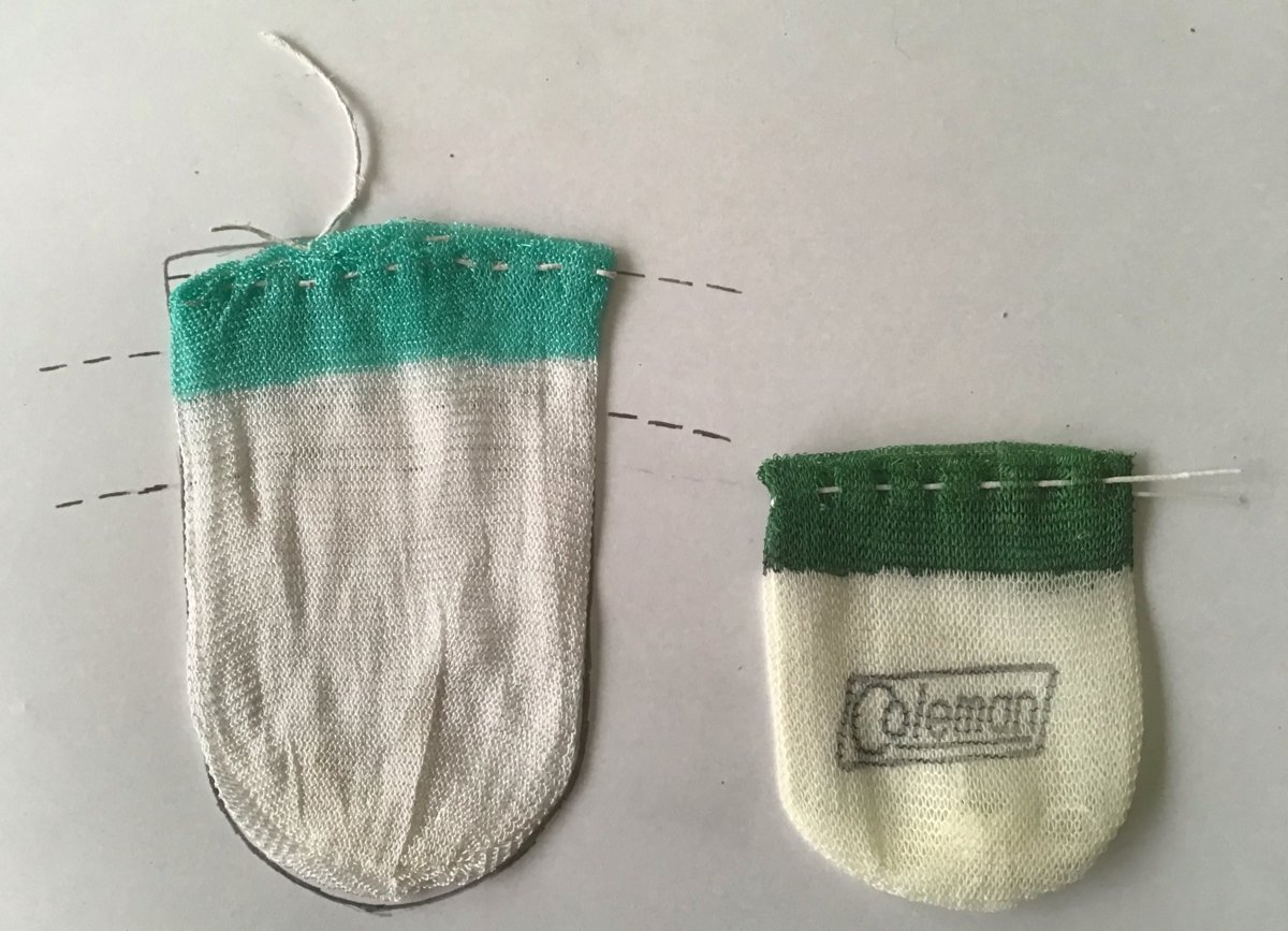

    Further to my comments and link to the cheap 500cp sock type single tie mantles I have produced (very badly) a chart showing original mantle sizes and the lengths I have used for adjustments where I haven’t had the correct one available for the lantern.
    I started by drawing round a 500cp as purchased and then a Coleman 21A as seen here:
    Adding measurements from my notes taken from earlier trials as here:
    The 400-450cp adaptation was used on my Veritas Superb: Veritas Superb 1950's
    The 300-350cp adaption was used on my Coleman 335P: Coleman 335 1980 Canada
    I’m sure I am not the first to do this however I hope my experiments are of interest to you.
    Regards Jeremy
    EDIT: Links shown.

    An excellent bit of investigation and you actually could be the first. I've not seen this done before but then again I've not been a member of the site for that long. I'm pretty sure this will be really useful for fine tuning the amount of burn needed for different lanterns if you use Chinese mantles like I do quite often.

    Now you just need a comparison with the 'burnt in' length. :) Some mantles shrink more than others.

    I came to post virtually word for word that Nils did.
    The actual test is, not what they look like now but once burnt in.

    I can of course measure the mantles I have adapted and burnt in which seem to work for the lamps I have mentioned, but don’t have the correct or specified ones to compare against. All I can say for me is they are working well on the lanterns I tried them on.

    I'm thinking more on the lines of if you have brand X of a mantle that matches one of the dimensions above unburnt, then measure it again after being burnt in. Then do the same for brand Y and so on.

    @X246A Jeremy, Good work, thank you for sharing. Handy to know when the mantle you require (or would usually use) isn't to hand. Regards, Alex
