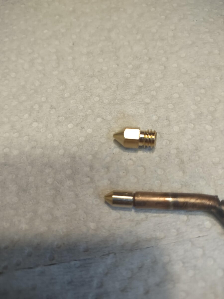

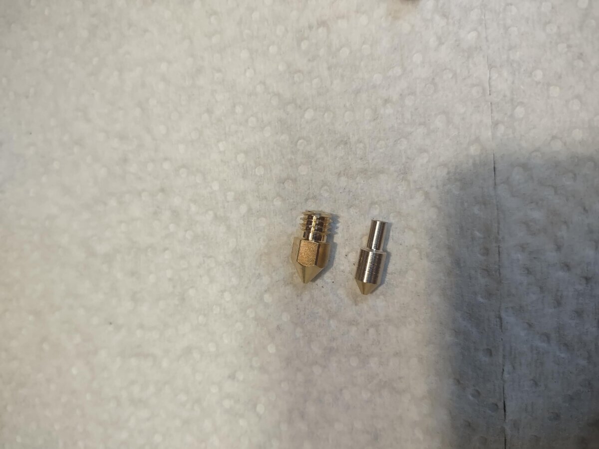

    I make my own Coleman Q99 generators which is easy enough (for me-lol) . I can fabricate everything except the generator jet so I would have had to steal one from another generator...but that would mean I would be one jet short for my lanterns. I do 3D printing and found that the brass nozzles come in varying sizes. A .2mm nozzle is very close to the required .008 inch needed for a Q99.
    I found these on Amazon. There are various sizes available. I turned the threaded end on my lathe and brazed it onto my home made Q99 and it works. For some reason the photos are not in order. Q993.jpg Q992.jpg Q991.jpg Q99.jpg well.
