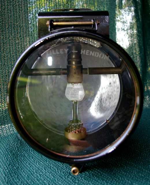

    I was looking at this picture and wonder ut any of the spiritcup from hurricane will fit my AL21?
    [​IMG]
    Picture from this thread in AL21
    16,661
    The AL-21 uses a standard 606 vapouriser, so the answer is yes, but the Vapalux/Bialaddin vapouriser is larger in diameter, so it would be wise to secure the meths trough to the vapouriser with some twisted wire.
