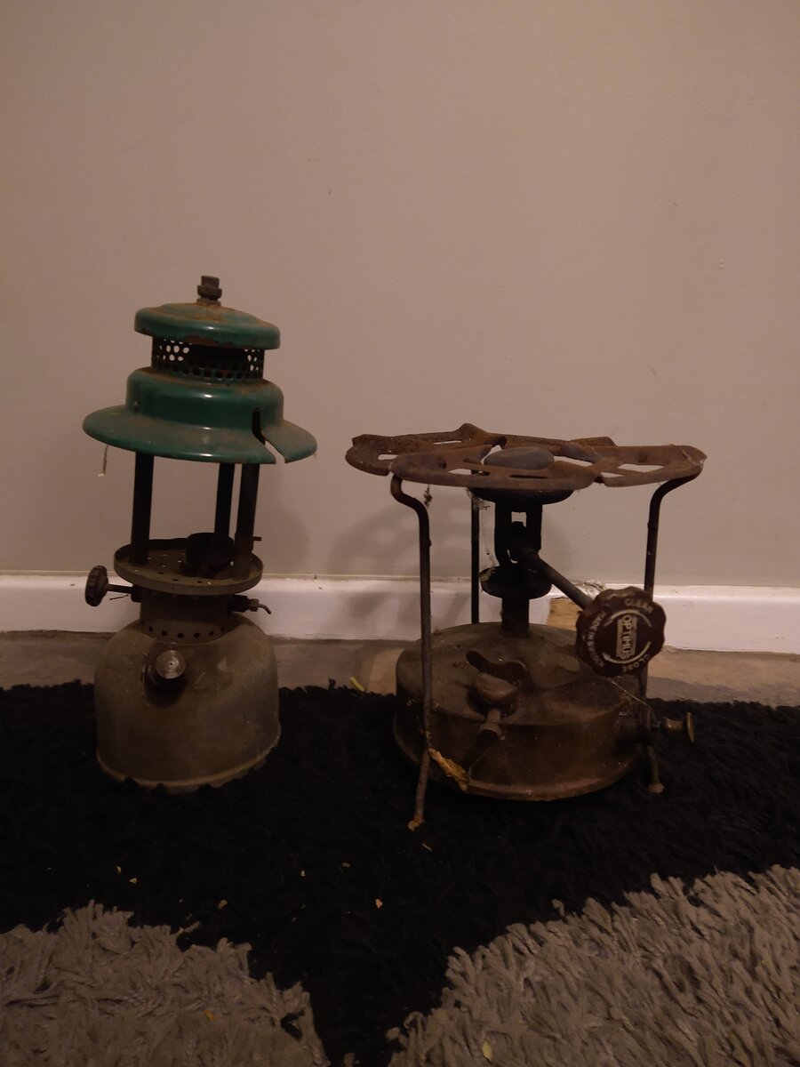

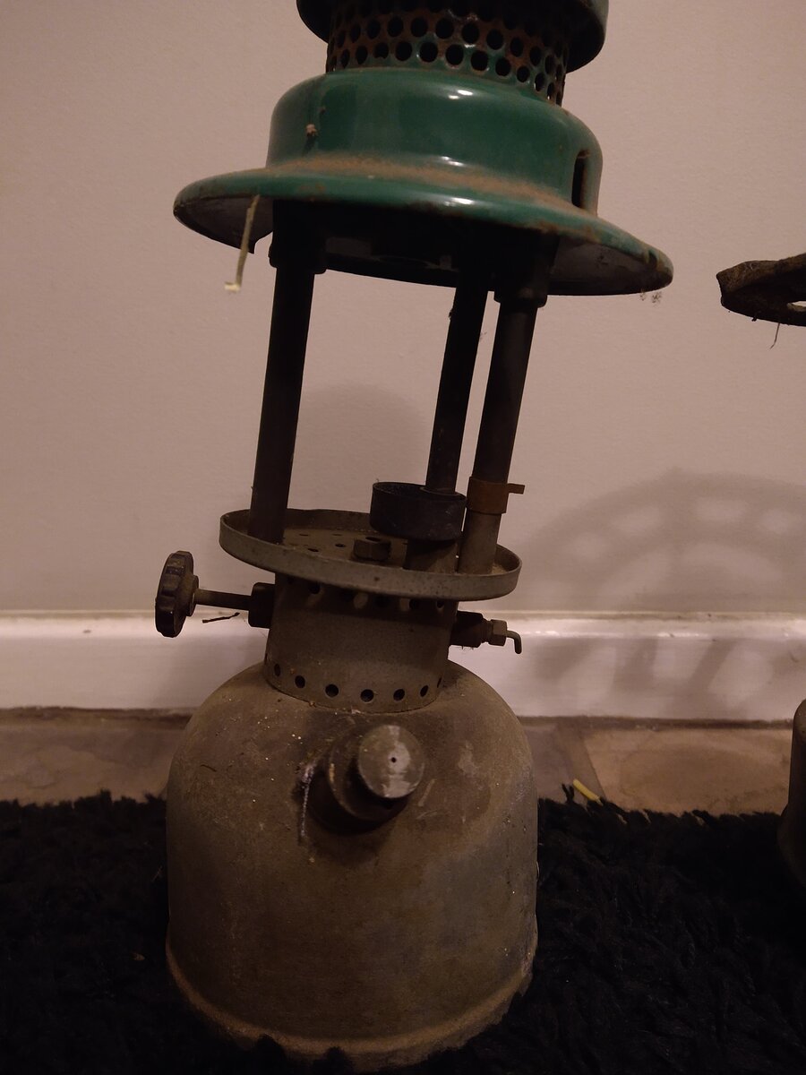

    Today I picked up a Coleman 249. It appears to have been squashed or dropped. I picked up the pair as the stove has an adjustable burner control (I've been hunting for one for a while) As for the lantern I had a hunch it was a Coleman.
    Where to now...The stove is a easy job, the 249 looks like a great unit but I'll need to fix the fount. I'm open to any suggestions on this. It appears to be chrome plated steel as the bottom has a bit of surface rust the dents are big. Can the bottom be un- soldered?

    The base is steel but the rest of the tank is brass. The base is "copper brazed" in place so is in there for keeps, see here
    the relevant part is between 3:30 and 3:58.

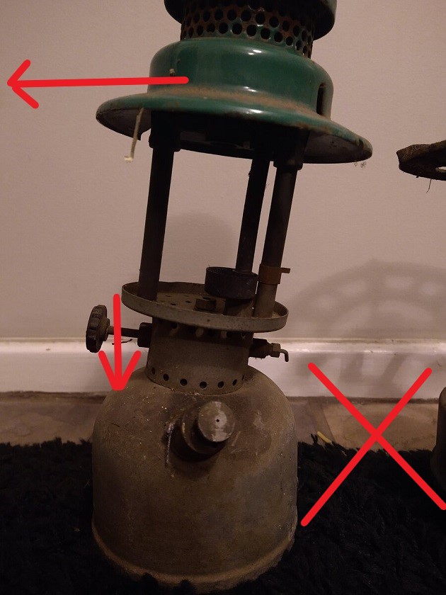

    You should be able to get the lantern straight but the force must be applied correctly. If you push the top over there's every chance the other side of the tank will go inwards
    Much better to pull the top and bottom away from each other.

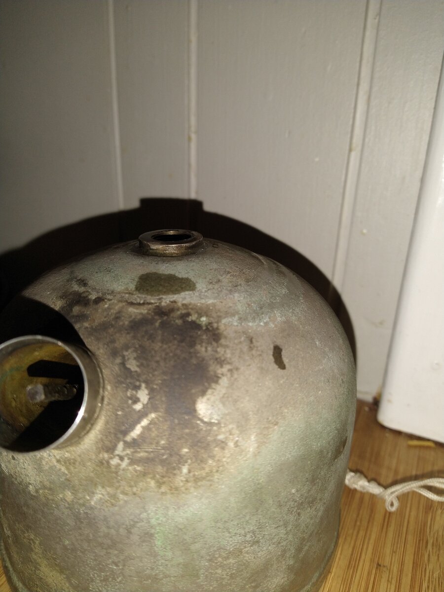

    I'd take the ventilator, cage and frame support collar off first and see what is on the lean. Send in some better photos of the top of the fount and the valve and generator areas, including any dents, if any.

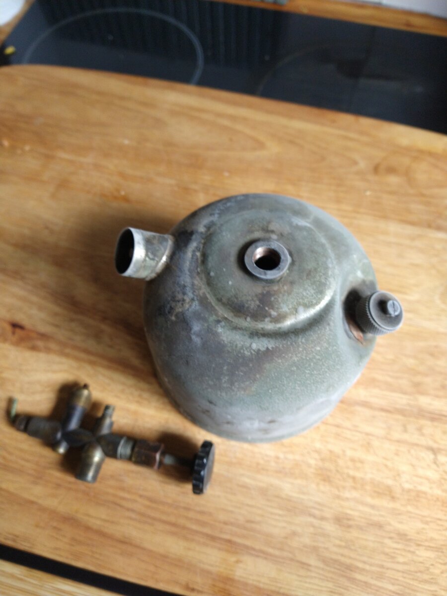

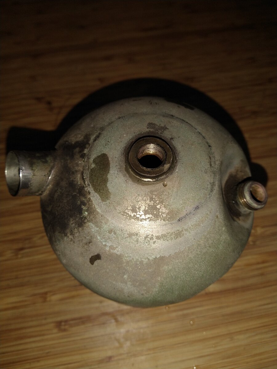

    After accidently popping the assembly slightly worse to the side whilst pulling everything apart I became suspicious of the top half being brass as it's was rather soft.
    The good news is it all came apart with a kettle of hot water, I'm used to things not being so easy.
    I spent a few hours last night going through the forums and those links. Now it's sitting half full of ice In the freezer so I'll give the ice technique a go.
    Although I did make one mistake and had to drain/melt some ice out as I didn't take into account how much the bottom half of Ice would expand...
    The wet look in the photos is water. The corrosion is heavy but I buffed up the sunshine logo and there's hope that it will come up nice without a re-plate. Although this is a good excuse to learn nickel plating.
    This dent may be tricky. After I give the ice truck a go for the top I'm thinking of filling with water and leaving an air void behind, lay it on its side and heat the dent (hoping a bit of pressure pops it out)
    Thanks again for everybody's input so far.

    As I didn't have a suitable bung, ive de- soldered the pickup tube and put the valve assembly back in after filling up the remaining space with chilled water (to speed up the process)
    Let's see how it goes..

    I recommend against the water/air space/heat option. A rupture under those conditions can lead to a significant emotional event. A leak with air or steam under pressure is sudden and violent. Water under pressure is just a leak and a mess. If you fill with water and freeze with the fount in its normal position you risk bulging the bottom plate. It needs to be frozen with the dent down. For the dents you've shown I think the water/grease gun technique would work best. I do like the idea of using oil rather than grease in the gun as it will certainly be easier to clean out.

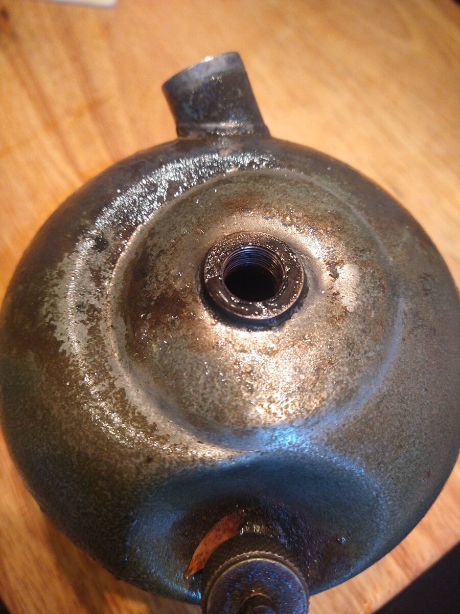

    Success.
    I've had a win and pushed out a majority of the dent. The hardest part was guessing how much water on the second freeze.

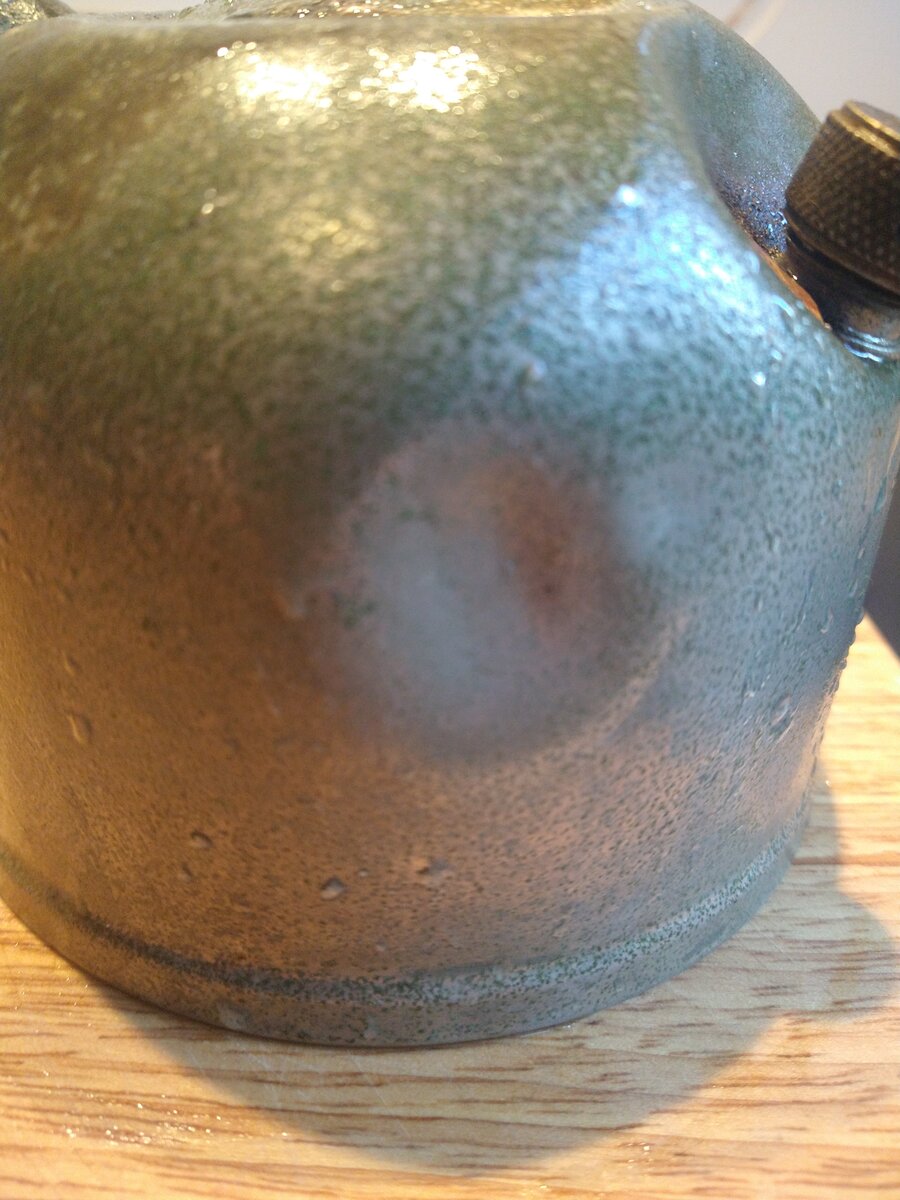

    Now for the final dent and then a cleanup/polish. If I use heat on the last dent I'm thinking I'll kill the finish before the dent pops out. Ideally I don't want this to happen what's the consensus on this? Or am I looking at having to re-plate anyway as the tarnish is heavy/feels bumpy

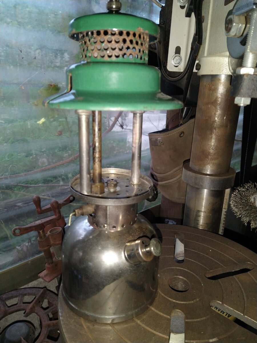

    Here's it is up and running.
    It runs nice and quiet, no wonder they're popular.

    Id like to thank everyone for the advice and links.
    One observation and unless I'm mistaken it appears a lot quieter than my 201, could the larger generator generate less hissing noise? I did lash out and treat myself to a Mica globe maybie it doesn't "ring" like a glass one. Perhaps I should start a new discussion about this?
