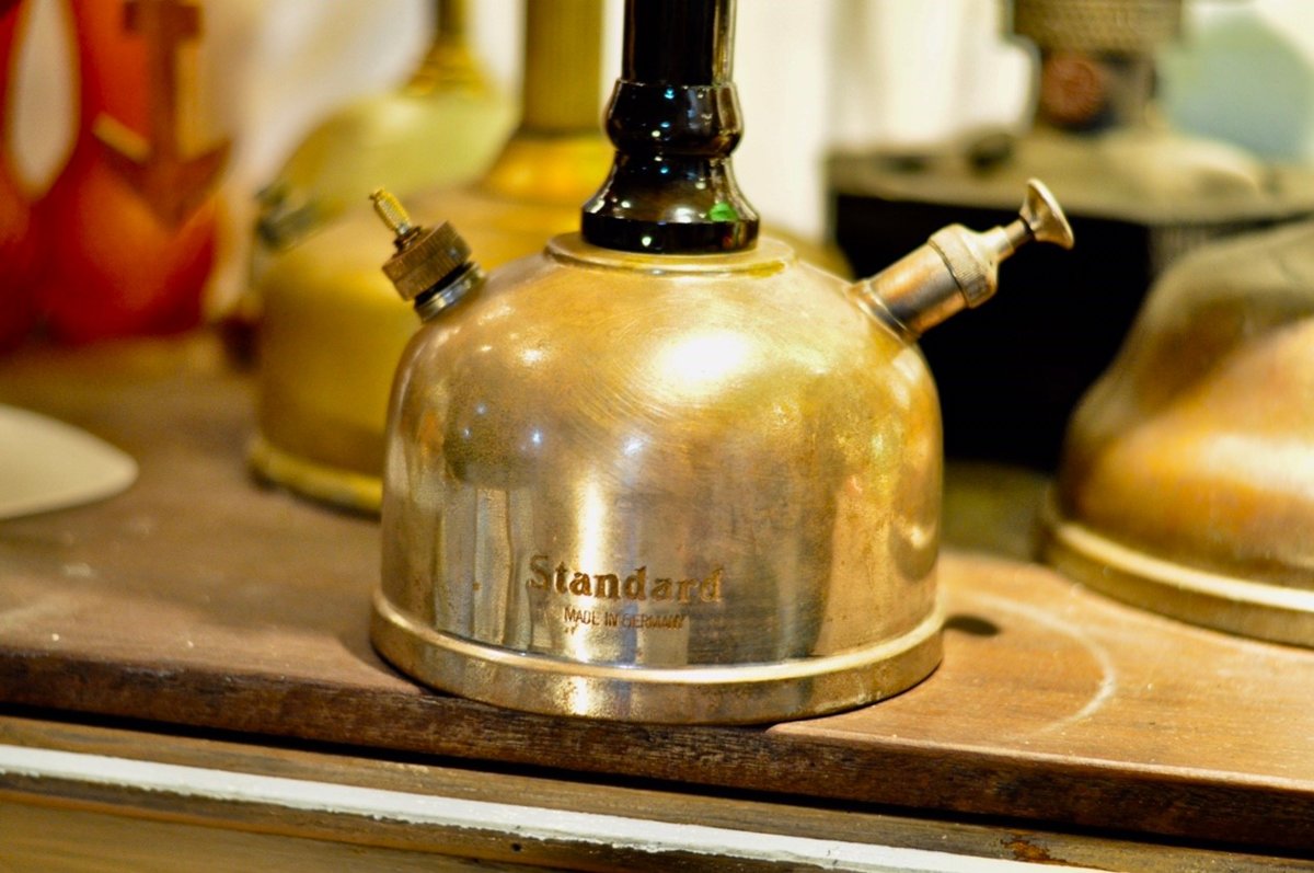

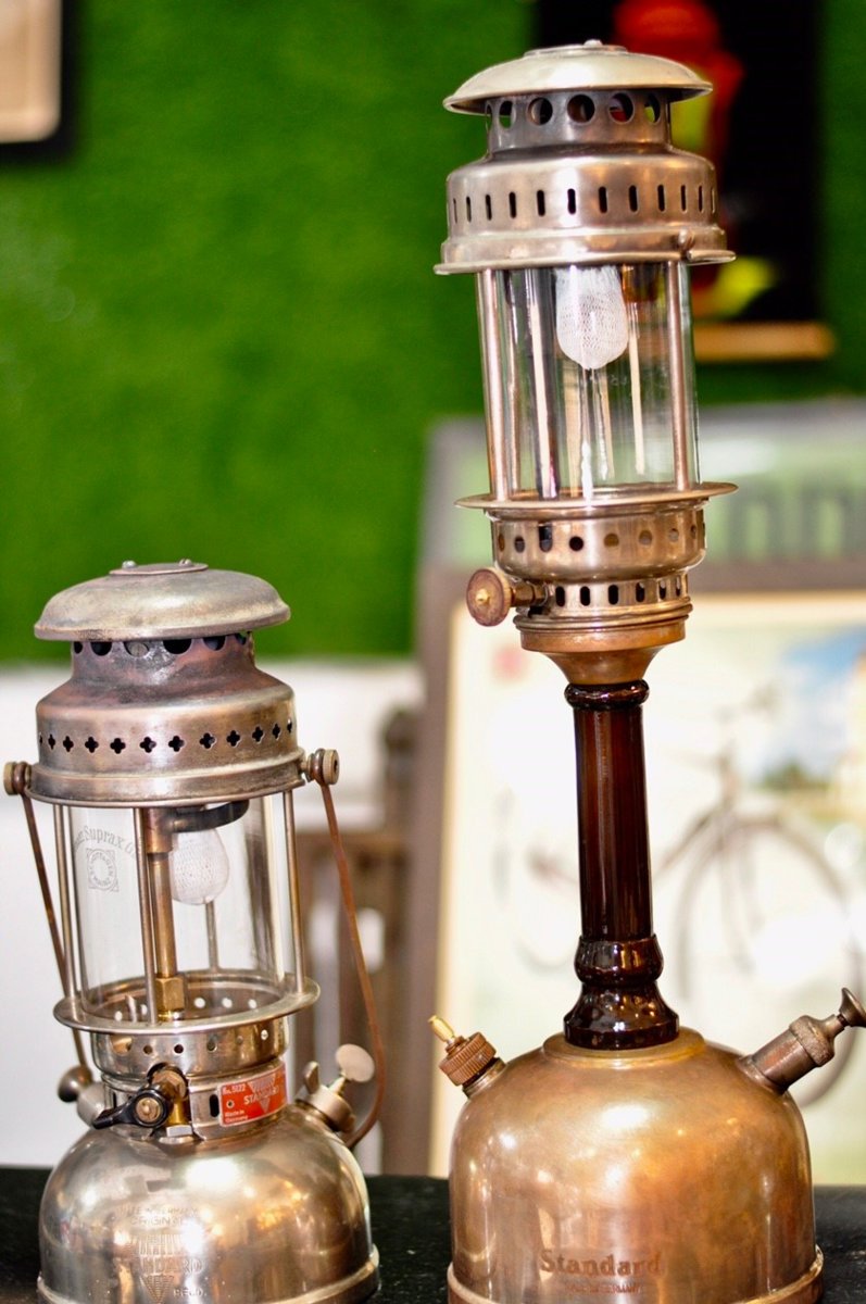

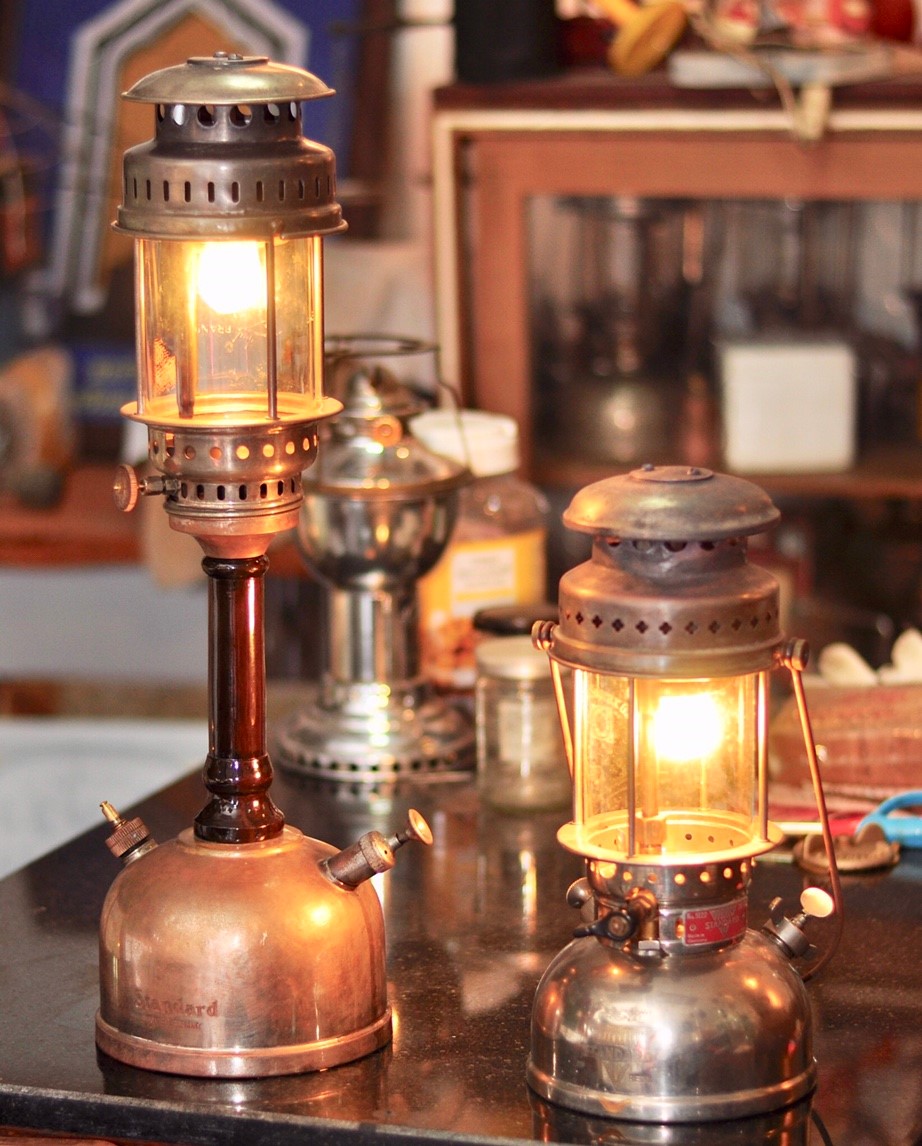

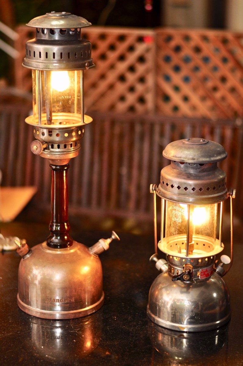

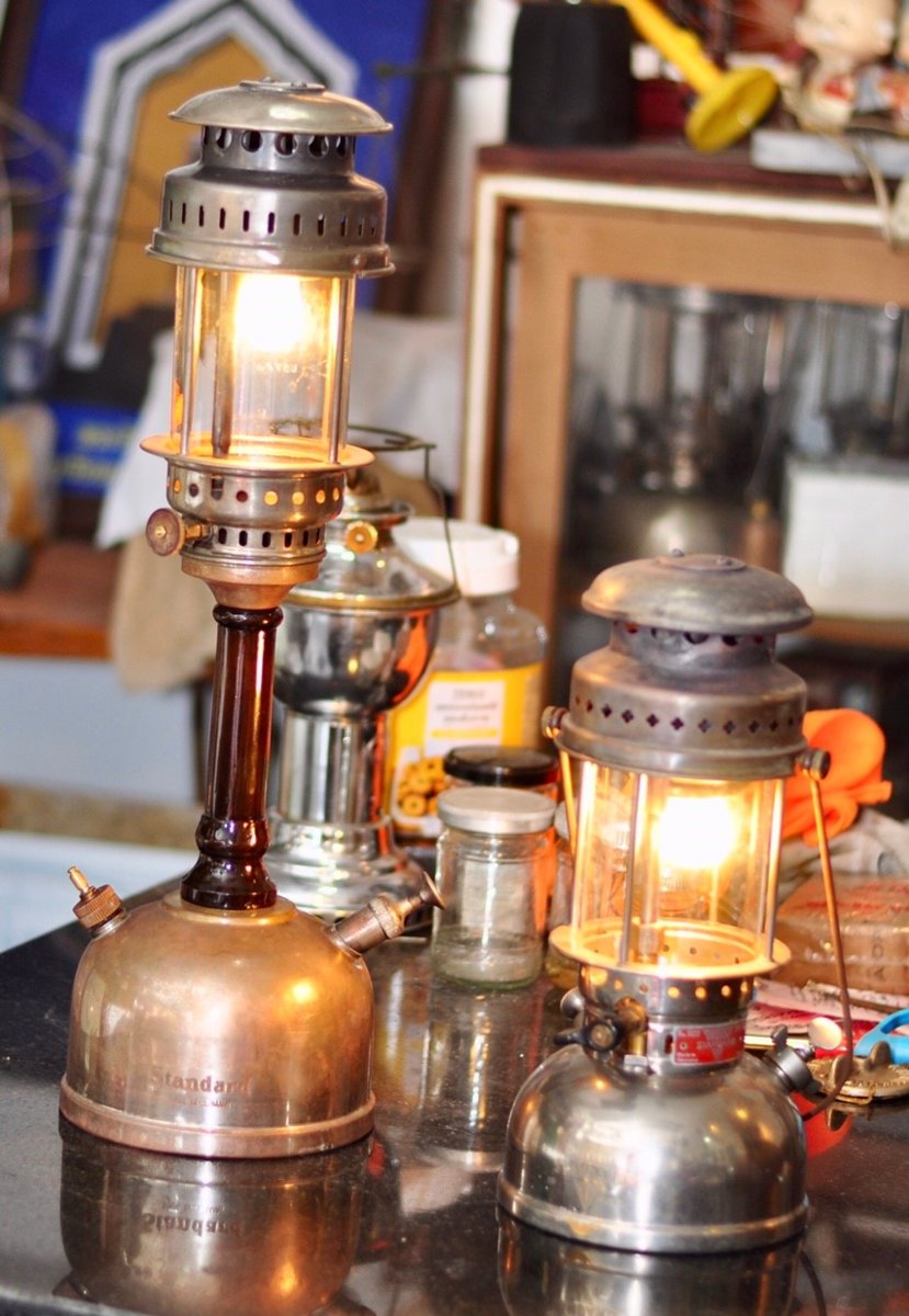

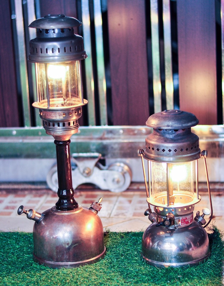

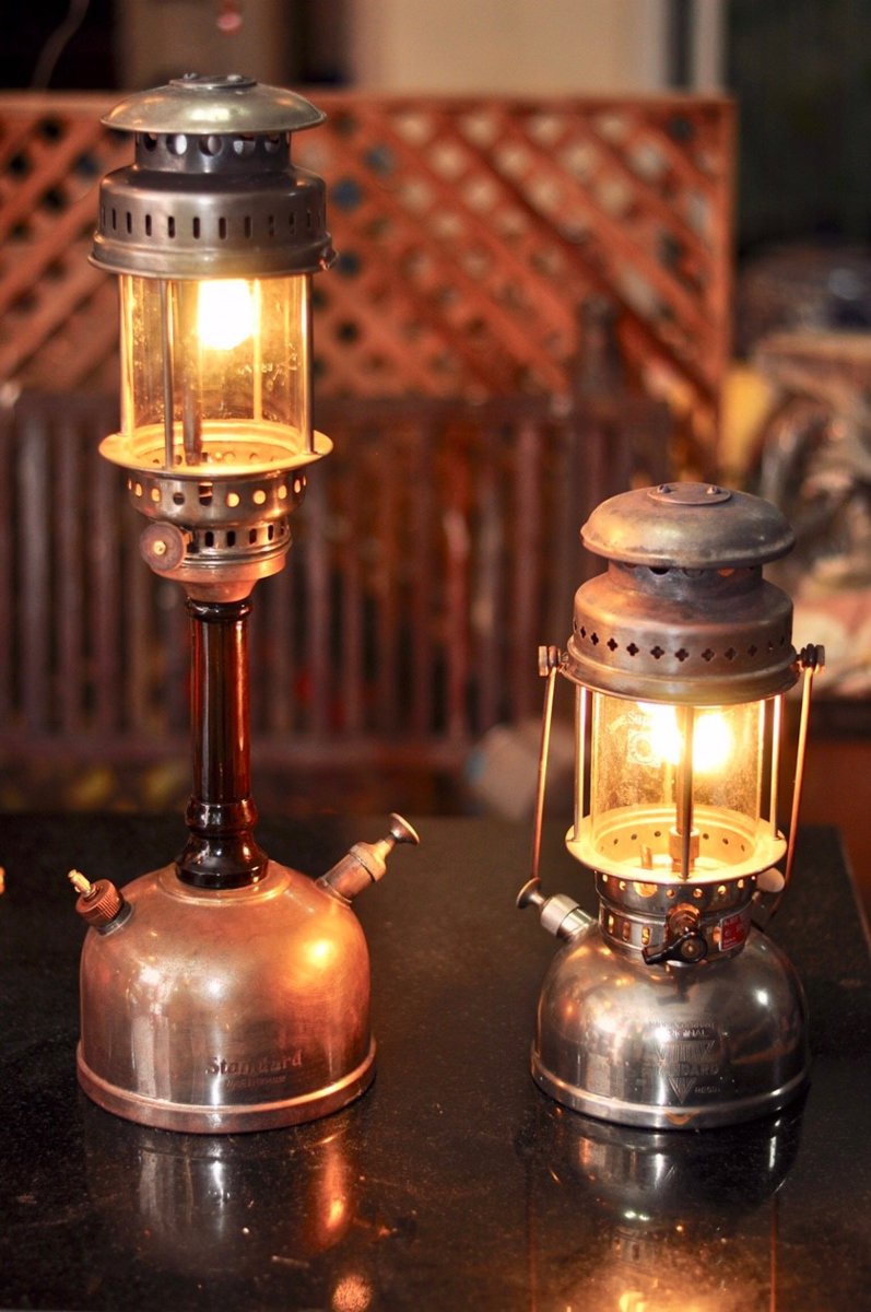

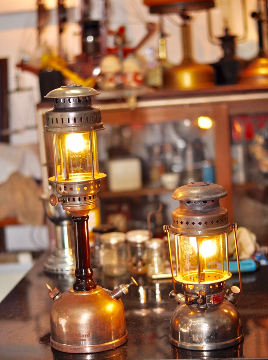

    Standard No.3060 .
    Talble lamp .
    I want look other model .
    thank you. Logo catalog_181203_0012.jpg Standard table lamp_181203_0105.jpg Standard table lamp_181203_0035.jpg Standard table lamp_181203_0011.jpg Standard table lamp_181203_0028.jpg Standard table lamp_181203_0057.jpg Standard table lamp_181203_0064.jpg Standard table lamp_181203_0068.jpg Standard table lamp_181203_0097.jpg

  6. WimVe
    3,544
    Looks great but I always am suspicious when lamps only have a brand name without the brands logo.
    Look at the difference between the two lamps.
    Made in germany but wasn't Standart a swiss company ?

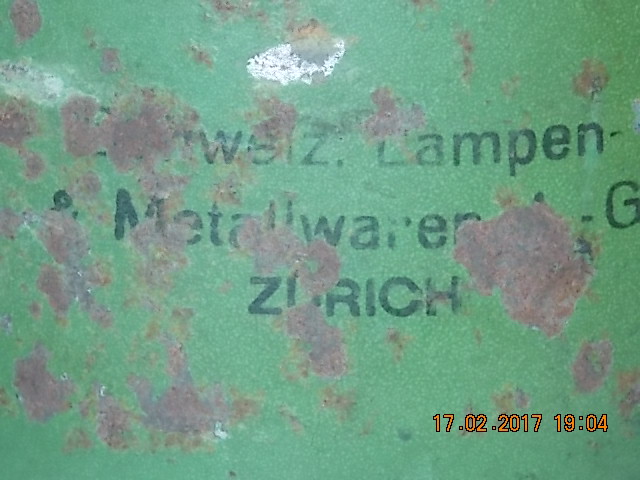

    Hello ,
    I have a Standard 2045.
    You can clearly see that she comes from Zürich Switzerland.
    But where it was really made I do not know.
    Regards,Reinhard
