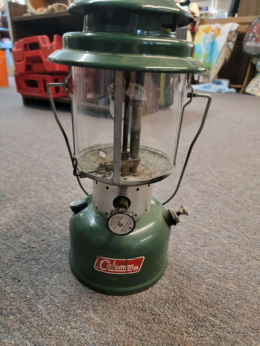

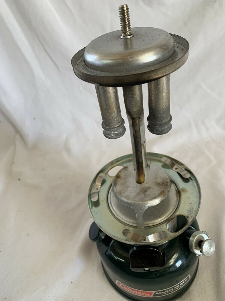

    1 - What is the comparable overview of these models: a 220F (1971-top image) and the 288a700 (1987 - bottom image, without the glass)? Are they operationally the same? Same white-gas fuel? Just different parts?

    Hey Jeff,
    Yes, same principle; different method of getting there. It’s a case of finding a way of building something cheaper; just like everything else.
    The 220F was one of the last to use the time tested and proven fuel/air tube and positive shutoff fuel valve.
    The 288 and like designs used a redesigned burner system from tank to burner; running one without the guard can damage the internals.
    They will both perform as designed on white gas.

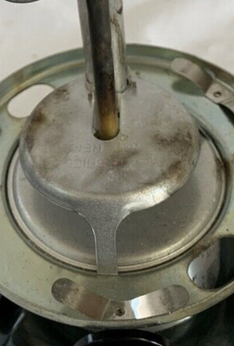

    John from Dallas above: Your answer includes "The 288 and like designs used a redesigned burner system from tank to burner; running one without the guard can damage the internals." Can you please expand on the latter part of your answer about running it without the guard? What is the guard that you're referring to? Thanks!

    The guard “heat shield” is the three legged piece above the baseplate. These designs used plastics inside both the valve and the pickup tubes. Excess heat doesn’t play well with plastics.

    All of the 220 series used the two-tube and rod FA setup, it didn't stop at the 220F. The 275 was the first Coleman to use a Schrader valve and plastic fuel pickup. Everything after (288, 285, 290, CL2 etc) used the new system.
