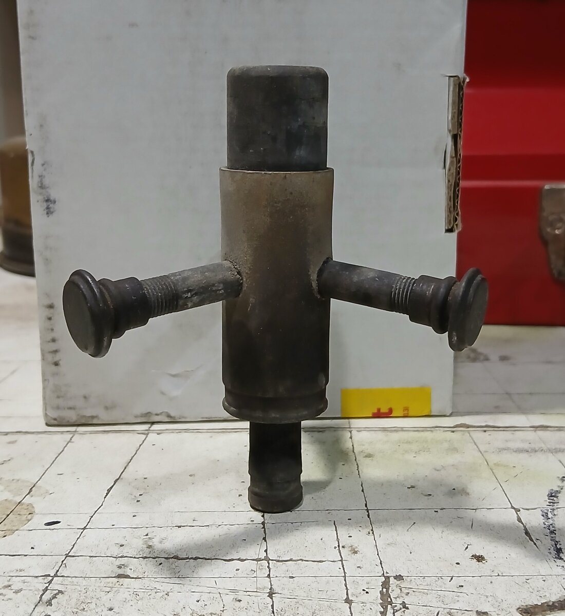

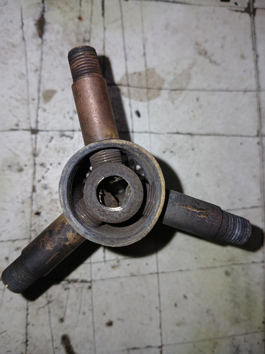

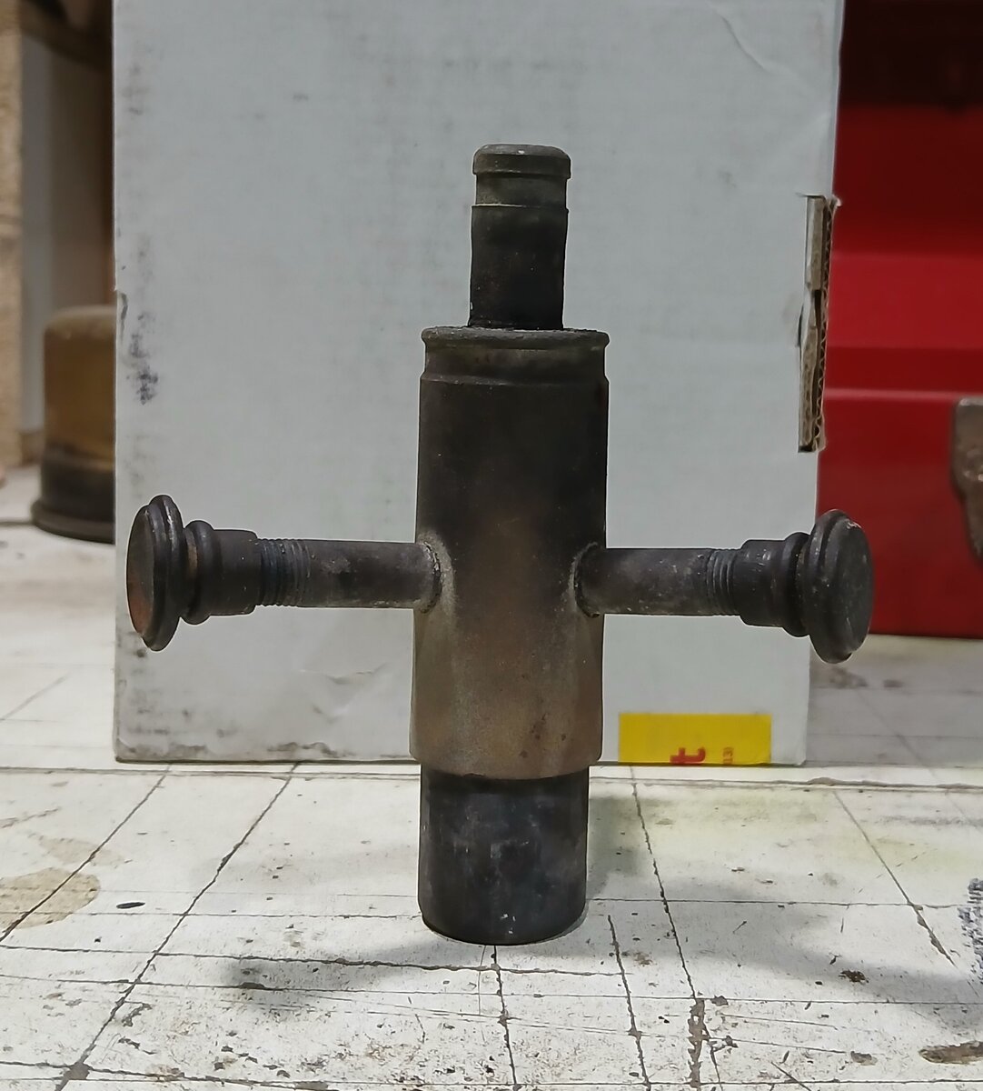

    This is the burner that i took out of the hood and when I changed it for another the lantern run sweet as.

  7. Tony Press
    When you put that burner together were any of the threads worn, corroded, and or loose? And was the burner shape distorted at all?
  8. Ross Hayes New Zealand
    Jan 2, 2024
    43
    New Zealand
    Hi the top thread was fine and the threads on the 3 tubes felt fine also and were all firm. The burner itself is not out of shape but the inner vertical tube is showing very minor rusty colour if that is of any help

    Wait: how close to the top of the dome does the inner steel tube go when the burner is back together properly?

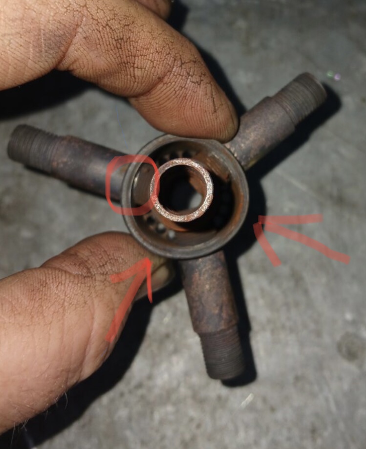

  10. podbros
    4,112
    In the first photo the threaded part looks out of shape? (arrows) Very common which can let hot gases in
    the circled area shows where the burner dome is bottoming out on the air tubes.. try some copper ease or a small amount of exhaust paste on the threads :thumbup:
    or it may not be salvageable

    I have had similar problems, but for whatever reason they've always been resolved by two things: 1) disassembly and thorough cleaning of burner, chamber, and air tubes and 2) coating all threads with copper anti-seize sealant and reassembling. I have found Tilley and Bialaddin burners to be very sensitive to gas leaks. Once I seal everything up I have had good success. Ulf.

  13. Ross Hayes New Zealand
    Jan 2, 2024
    43
    New Zealand
    So update . Im not surprised to say you guys hit tge nail on the head. I sealed uo the thread on the dome at the top an bingo. I now have a very happy lantern ticking away perfectly content. Is it just me or are there others who need to have a lantern fired up even though its midday and sunny as hell outside ? Thanks for your help

  16. David Shouksmith
    I had a lantern which had a flat like that. It didn't let hot gases in - it let hot paraffin vapour out so it was a right stinker whenever I tried to use it. I got it back to round and it burned sweetly after that...

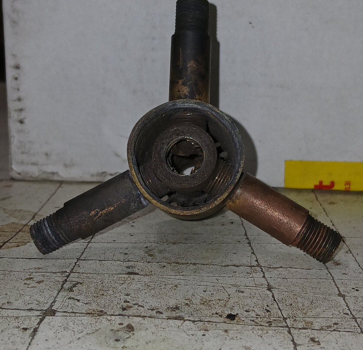

  19. JonD
    JonD Subscriber
    Apr 15, 2014
    1,012
    Hertfordshire, England
    This happens when the burner runs hot enough for the brass to soften. The weight of the hood on the air tubes provides a down force so the sides of the burner bend like that.
    It would certainly occur if the flame is allowed to burn up in the dome for any length of time. That can happen if the tank pressure is allowed to get low.
    In the extreme it ends like this.
    Tilley X246

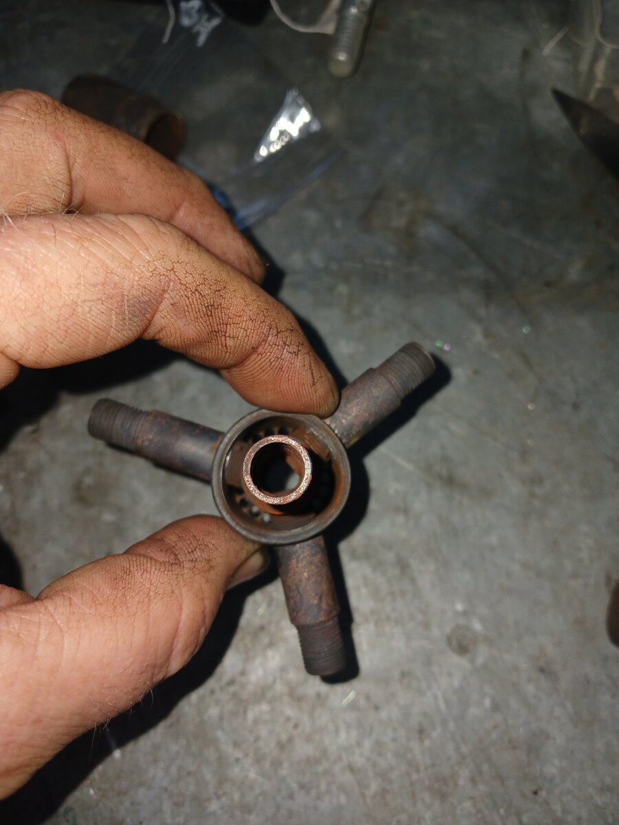

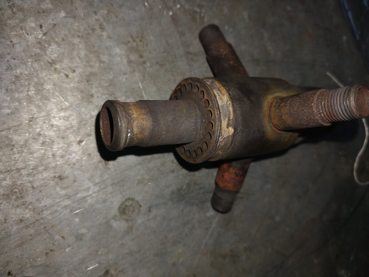

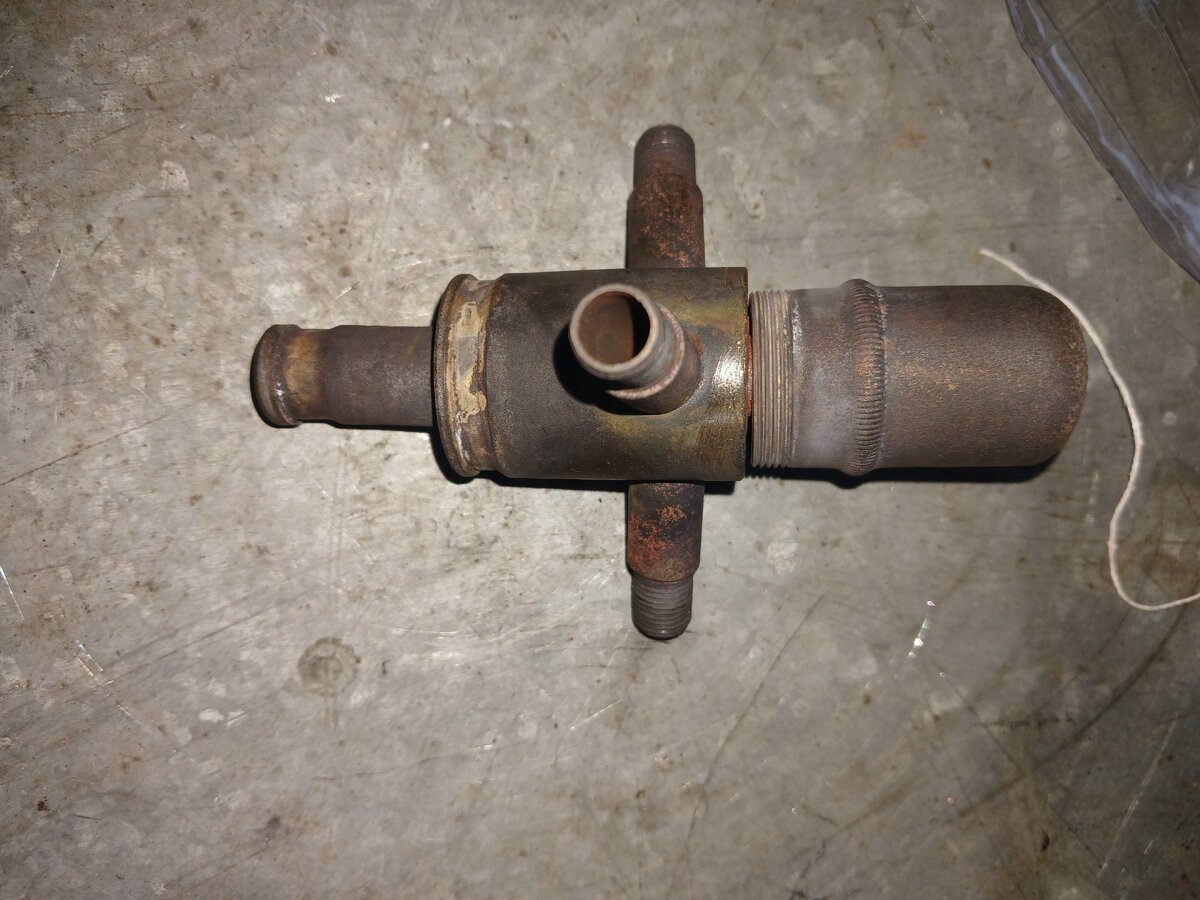

  23. Buggerlugs

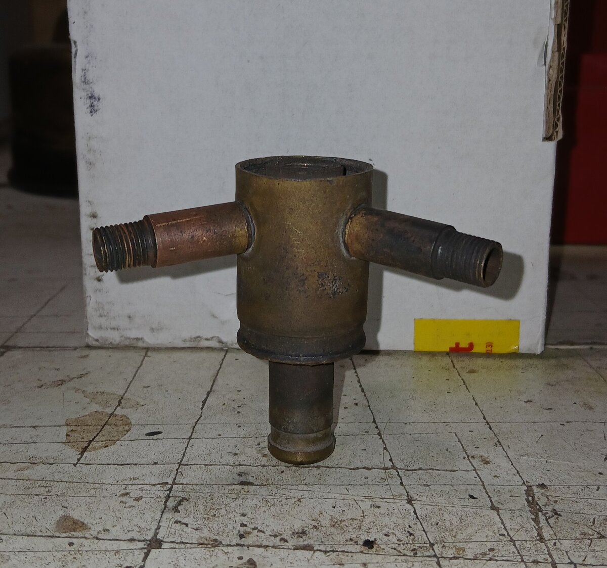

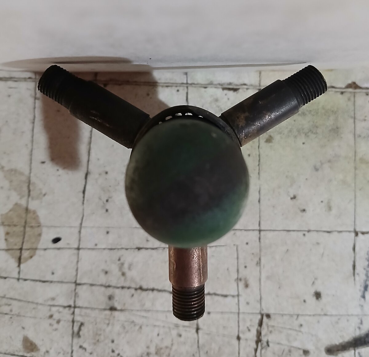

    I can answer that question, yes they do.
    Here are some photo's of 2 Kayen burners, as best as I can get them.
    First one
    20250219_202142.jpg 20250219_202226.jpg 20250219_202344.jpg 20250219_202709.jpg
    Second one
    Regards
    Brian.
  24. podbros
    4,112
    :thumbup::thumbup:
    at first i thought the walls of the vapalux burner body might be thicker but they look similar :/
    it has to be the type of brass then :-k
