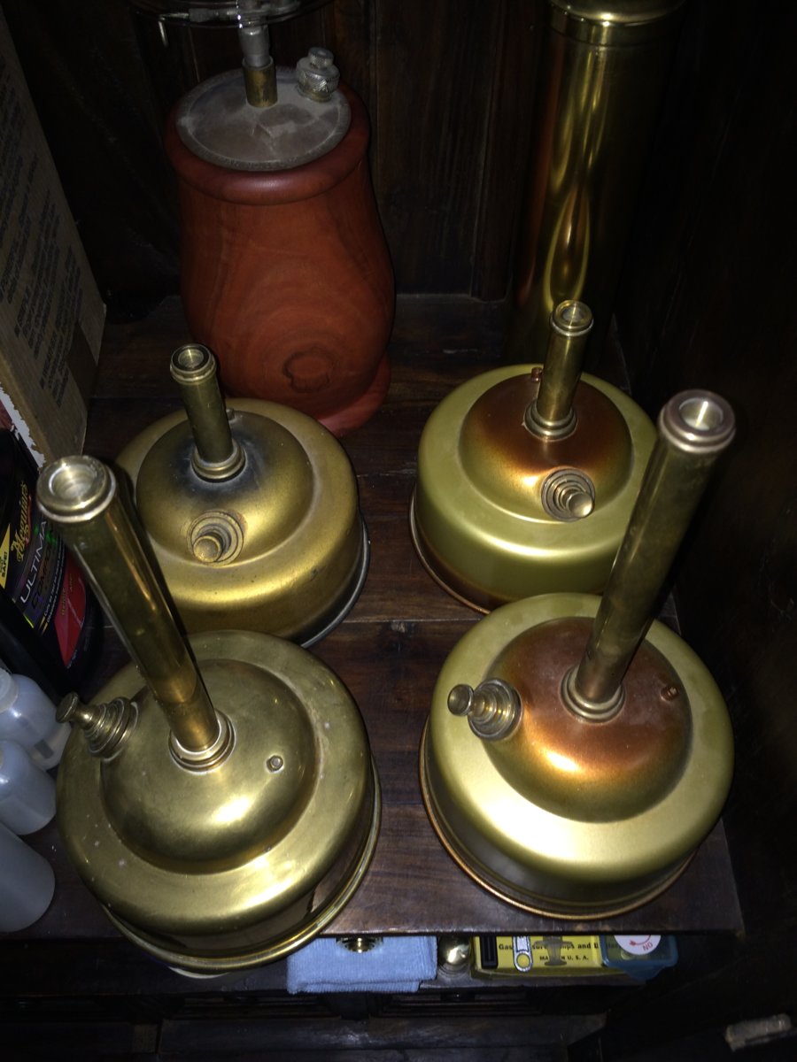

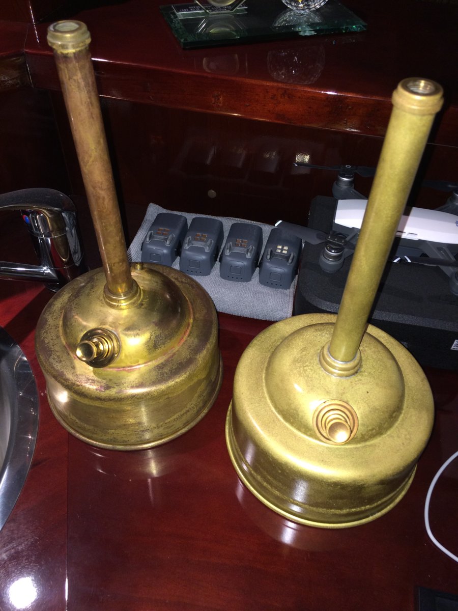

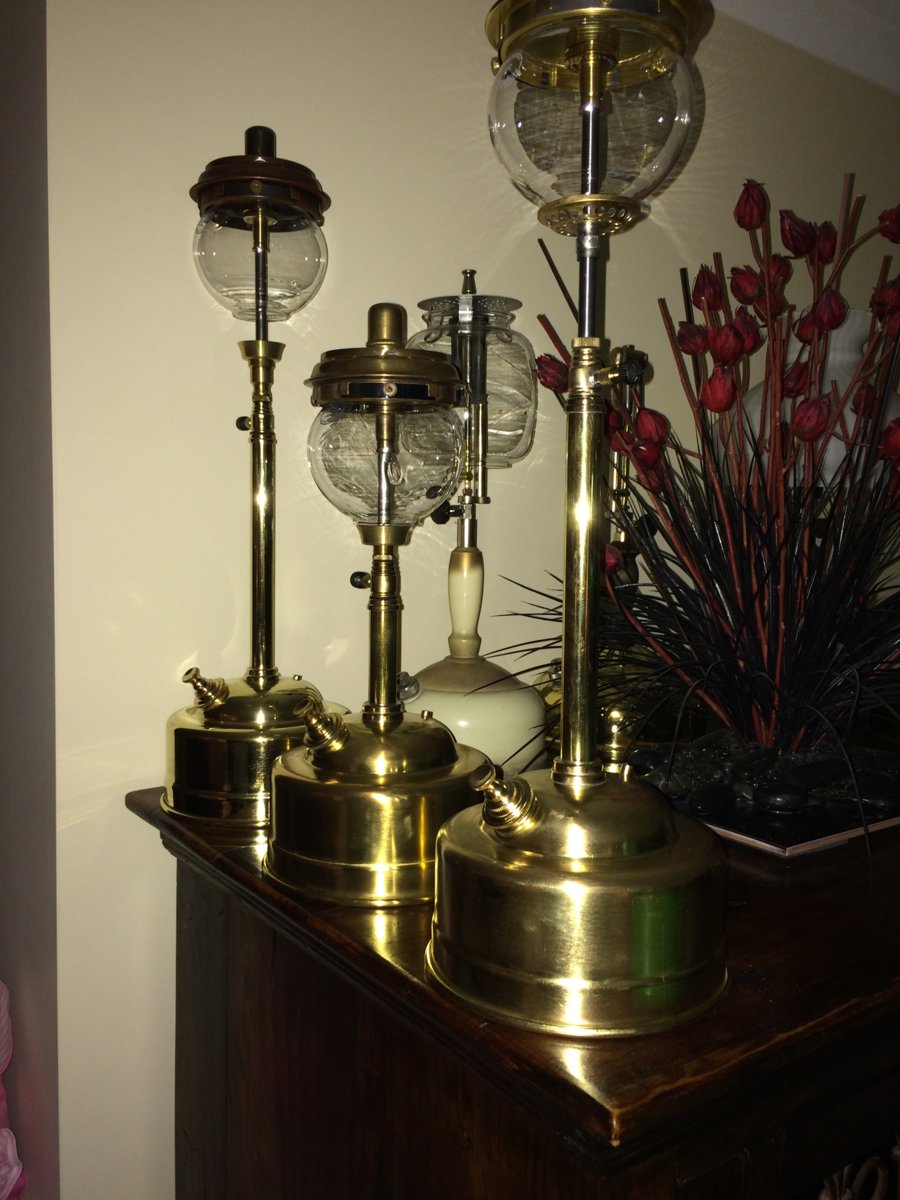

    Below photos show 6 porks i
    wanna strip to brass as they have had shit paint jobs, the last photo has two highly polished lamps that i brought from Jim. And another pork that i brought from another collector who had it polished.

  6. Henry Plews
    3,051
    @Kiwiboy00
    The two lamps in your first image - fair enough
    The four lamps in your second image, the paint job on the lamp at top left is as close to original as you'll ever get !
    Lamps at top right and bottom right, I've seen that finish before and assume it's a variation and therefore original !
    Lamp at bottom left - looks to be stripped already.
    They're your lamps to do with as you wish so if you wish to devalue them, then go ahead and strip them.
    Henry.

    Hi Henery, the Lamps at top right and bottom right, You said you have seen that finish before, im interest where you have seen this. You assume it's a variation and therefore original !
    I brought those two from Jim Dicks collection, im far from qualified to even guess if its original, but to me it looks like jim had them re-painted.
    Tony no doubt you have seen these two lamps when going through Jims Lamps. What is your thoughts, original or re-painted.

  10. Anthony
    Anthony Australia Subscriber
    May 7, 2013
    1,651
    I too have seen those lamps in amongst Jims lamps and these have been resprayed.
    As far as I am aware the shading was done in black.
  11. Henry Plews
    3,051
    Hi Darren, after reading the post by @Anthony and looking again at the lamps, it's clear those at top and bottom right have been repainted and my reply to your post was far too hasty.
    I still have this nagging thought at the back of my mind that I've seen that colour combination somewhere before though.
    Henry.
  12. Anthony
    May 7, 2013
    1,651
    @Henry Plews , perhaps your thinking about some Coleman lamps that have that colour in the same way. :-k
  13. Kiwiboy00
    Jun 23, 2018
    255
    Gold Coast, Australia
    To be honest guys i lean towards re-painted. But Tony might have a better idea on this.
  14. Tony Press
    11,056
    My recollection and judgment is as @Anthony said:
    Top left: Original paintwork
    Top right: Jim Dick repaint
    Bottom left: Stripped
    Bottom right: Jim Dick repaint
    If it were me, I would paint the unpainted one and keep the rest as is.
