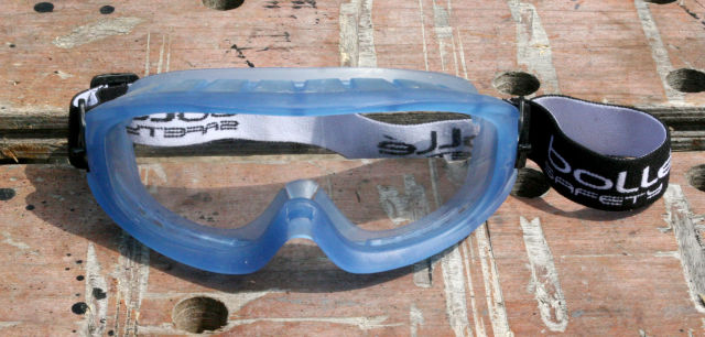

    Hi David. I used to use Wickes paint stripper. Worked OK but slow and messy. I now use a scotchbrite wheel on a bench grinder. They come is various grades and don't seem to remove any metal (maybe the harshest grade will). Basically, a pan scourer on a wheel. Takes the paint off a tank in minutes. Then paint stripper for the odd awkward corner:
    Usual H&S rules apply. BTW, as a spectacle wearer I have struggled over the years to find a pair of safety goggles that work for me. Bought these 'Bolle Atom Safety Goggles' from Screwfix the other week - brilliant. Optical lenses and specifically designed for spectacle wearers. Very comfortable and clear - you forget you are wearing them:
