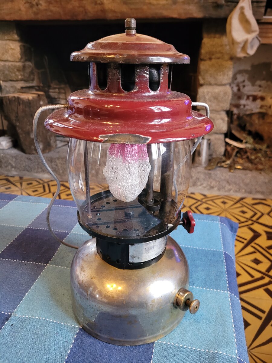

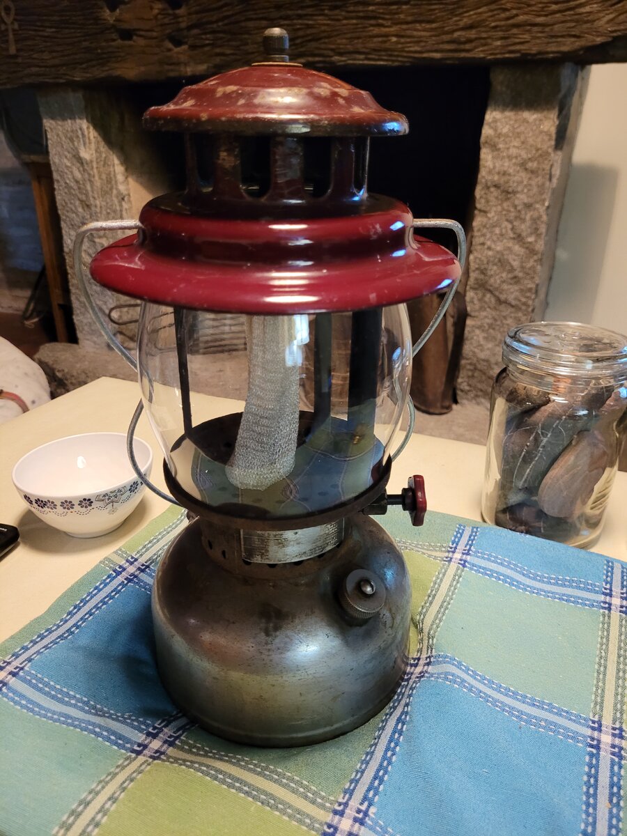

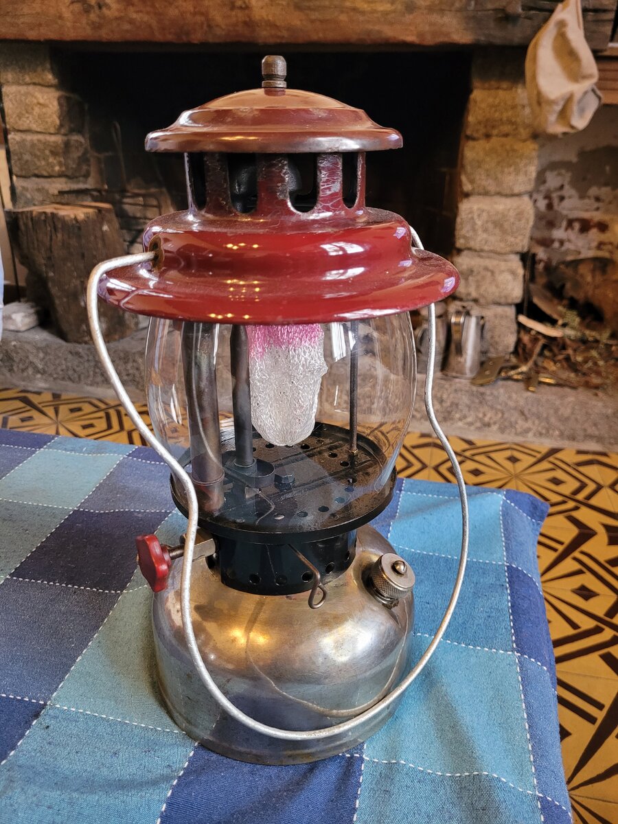

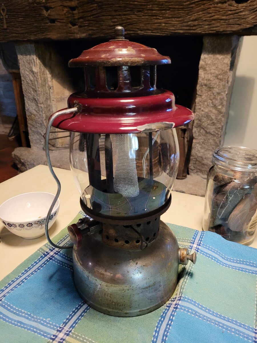

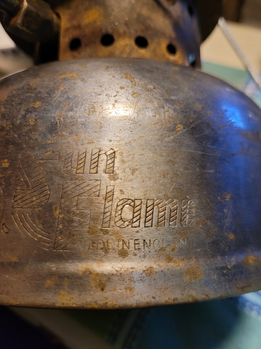

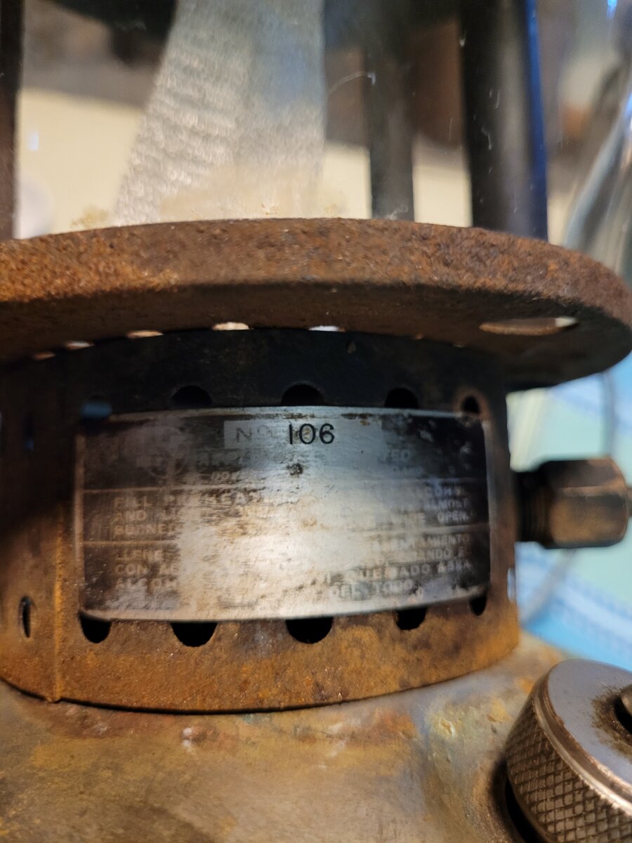

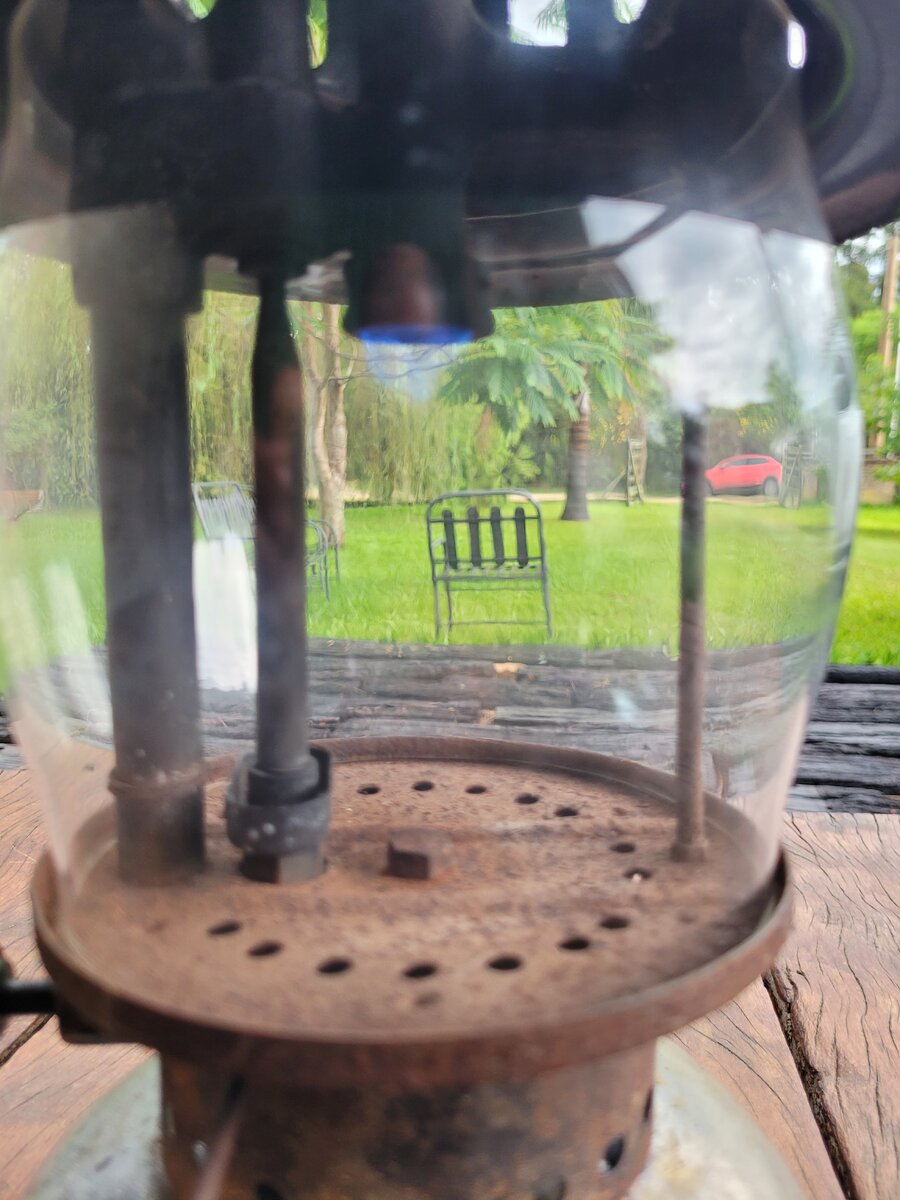

    20250123_201242.jpg 20250123_201253.jpg 20250123_201306.jpg 20250123_201339.jpg Hola a todos, hoy pude comprar este Sun Flame No. 106 en estado regular. Espero poder limpiarlo bien y que funcione. Pero algunas piezas están bastante dañadas. Saludos
    16,646
    The SF., lanterns which have made in England stamped on them are scarce, so that is a very lucky find.:thumbup::thumbup:
  3. MYN
    Looks like this one is not at all common. Another lucky find.

    51
    Uruguay
    Hello Tony, no, I cant see any mark on it, is not the original globe.
  7. Tony Press
    11,050
    Thank you.

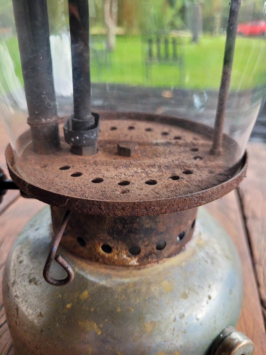

    The lamp is in working order, but the base is in very bad conditions, any idea what treatment will be the best?Dificult to find same color in heat resistant paint... Anyone had try the heat blueing??
  9. Tony Press
    11,050
    Use either electrolysis, citric acid or Evaporust to remove the rust from steel parts.
    You don’t need flame proof paint for the base plate. It is ok to use automobile paints from a rattle can, but let the paint cure for a week, or bake in the oven at 94°C for an hour after the paint dries.

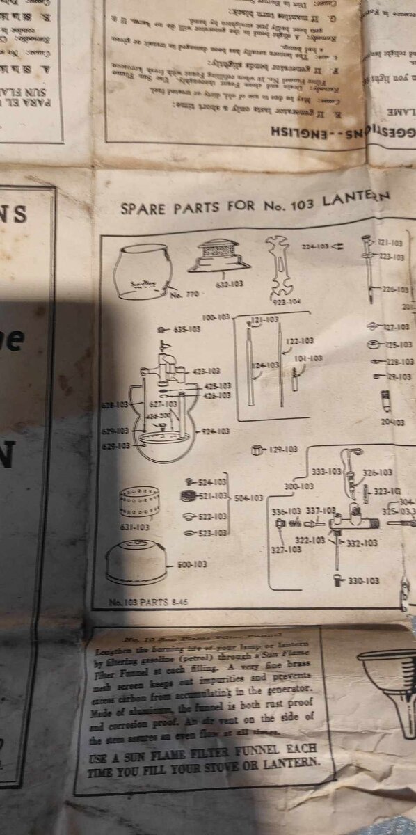

    hola Leonardo, acabo de comprar una sun flame, una 103, tuve un poco de suerte, cuando llegue si a alguien le sirve subiré el manual.

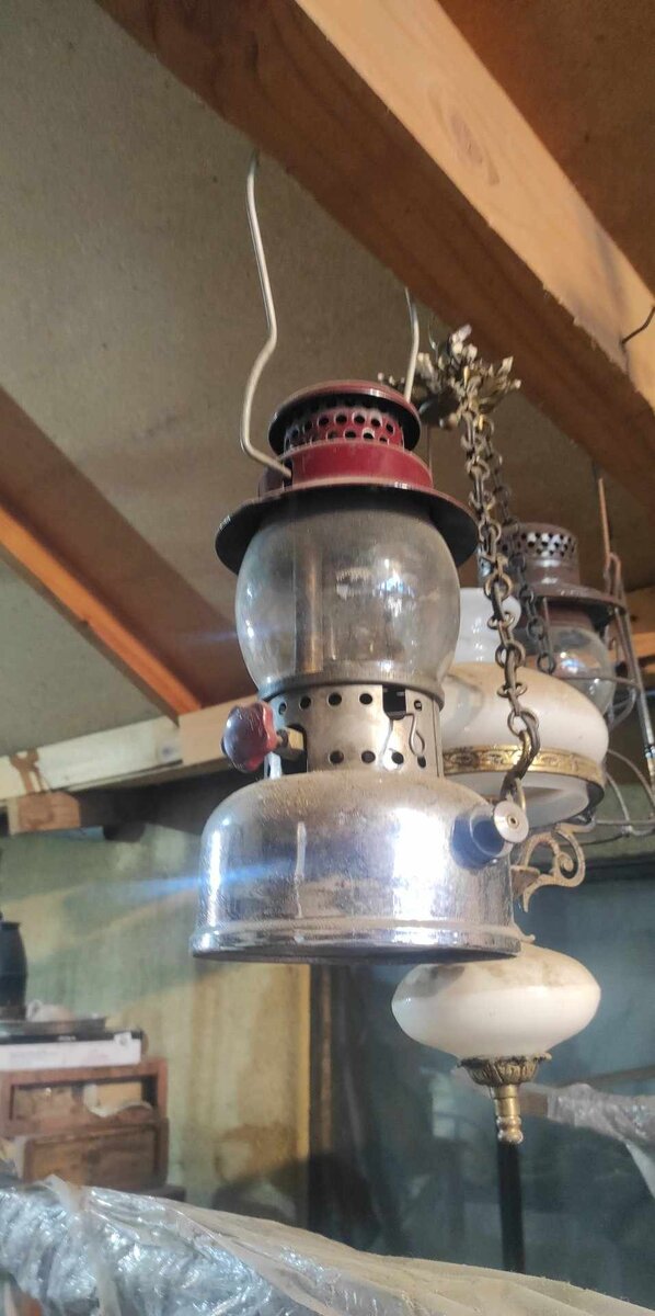

    Hello everyone, im sending you some photos of my 106 now in working conditions.
    I paint the base with automotive paint like Tony said and is working good.
    Some things are irreparable like the chrome of the tank or the label, but its working fine, good light and nothing of smell, best regards 20250526_131726.jpg 20250526_131726.jpg 20250526_131803.jpg 20250526_182037.jpg

    It looks good.
