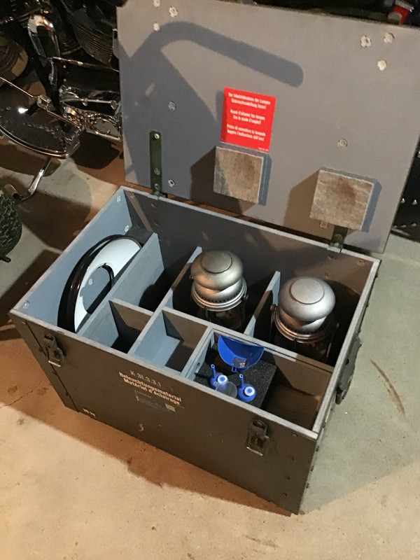

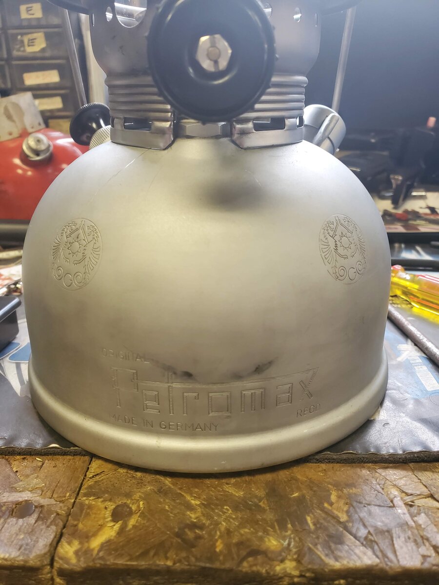

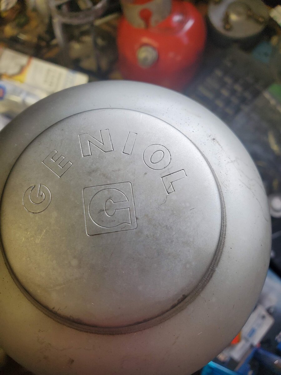

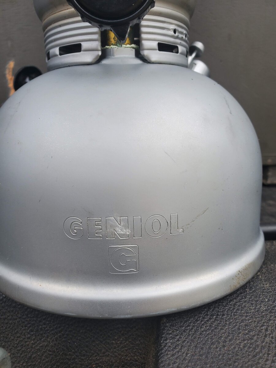

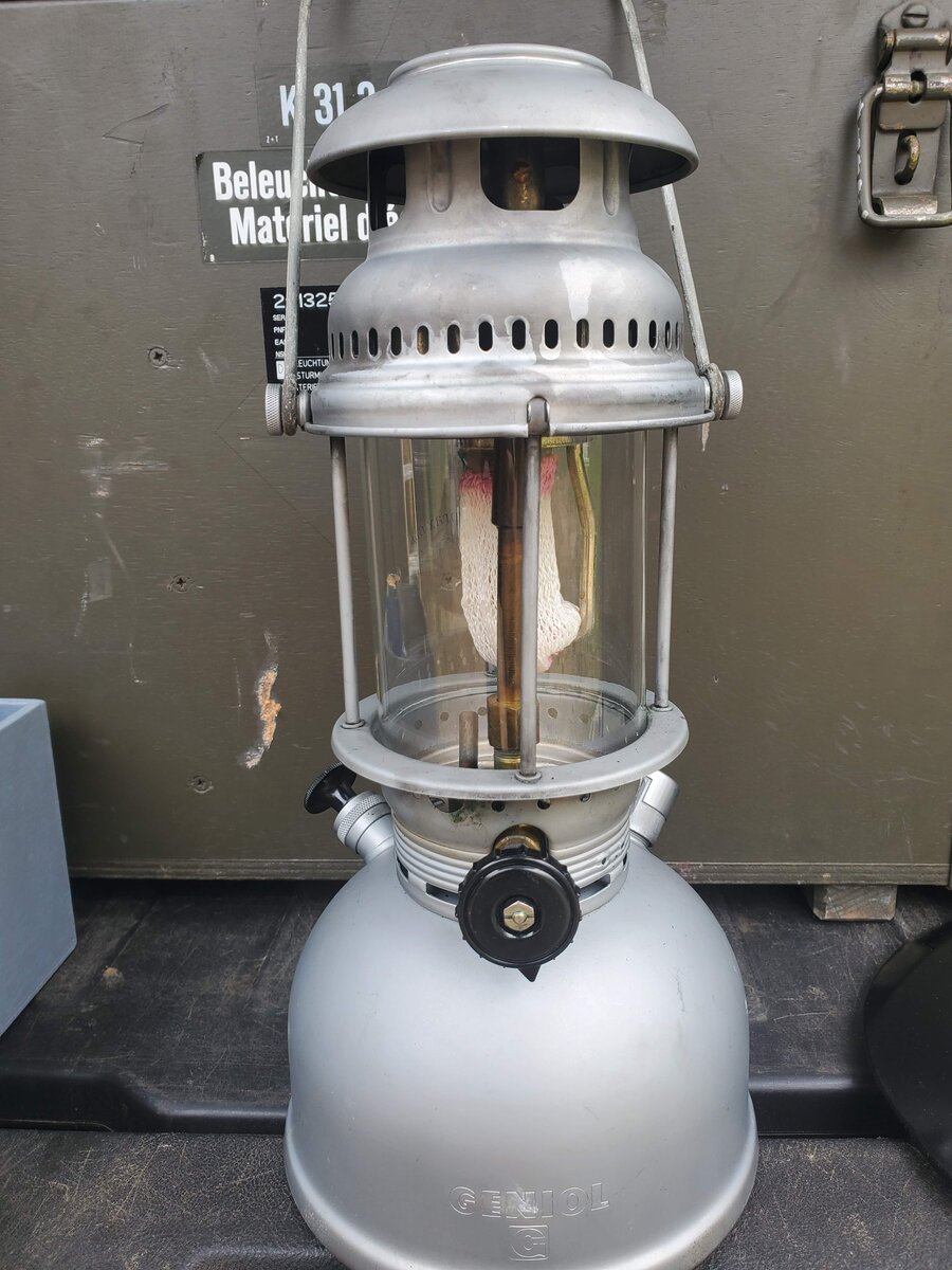

    Greetings,
    Picked up 2 of these and the wooden box they came in, as near as I can tell they are Swiss Army.
    One has a Petromax fount and the other Genoil, both have Genoil on the top of the vent.
    It has new un-brunt double end mantles on both with some sort of plug that goes in the bottom of the mantle.
    Question is are these kerosene of gasoline, no Preston loop style generator 20230506_124220.jpg 20230506_124355.jpg 20230506_124216.jpg 20230506_124044.jpg 20230506_124137.jpg D6-A19-B9-B-F6-E8-4076-91-D4-EDF5-CED54-BE8.jpg

    These are meant to burn (unleaded) gasoline.
    However, you should take care of the pump valves (NRVs), in order to avoid any leakage of highly inflammable fuel through the pump tube.
    Unlike Petromax, these are operated with the arrow with the handwheel to the up direction, when the needle should be retracted from the jet.

    Martin, thanks.
    What's with the double ended mantle and the piece that goes in the bottom of the mantle?
  4. Erik Leger
    Erik Leger Germany Subscriber
    497
    It is just a mantle support for the use of double-tie mantles. You can either get some 250 HK double-tie mantles or just remove the mantle support and use regular mantles.
