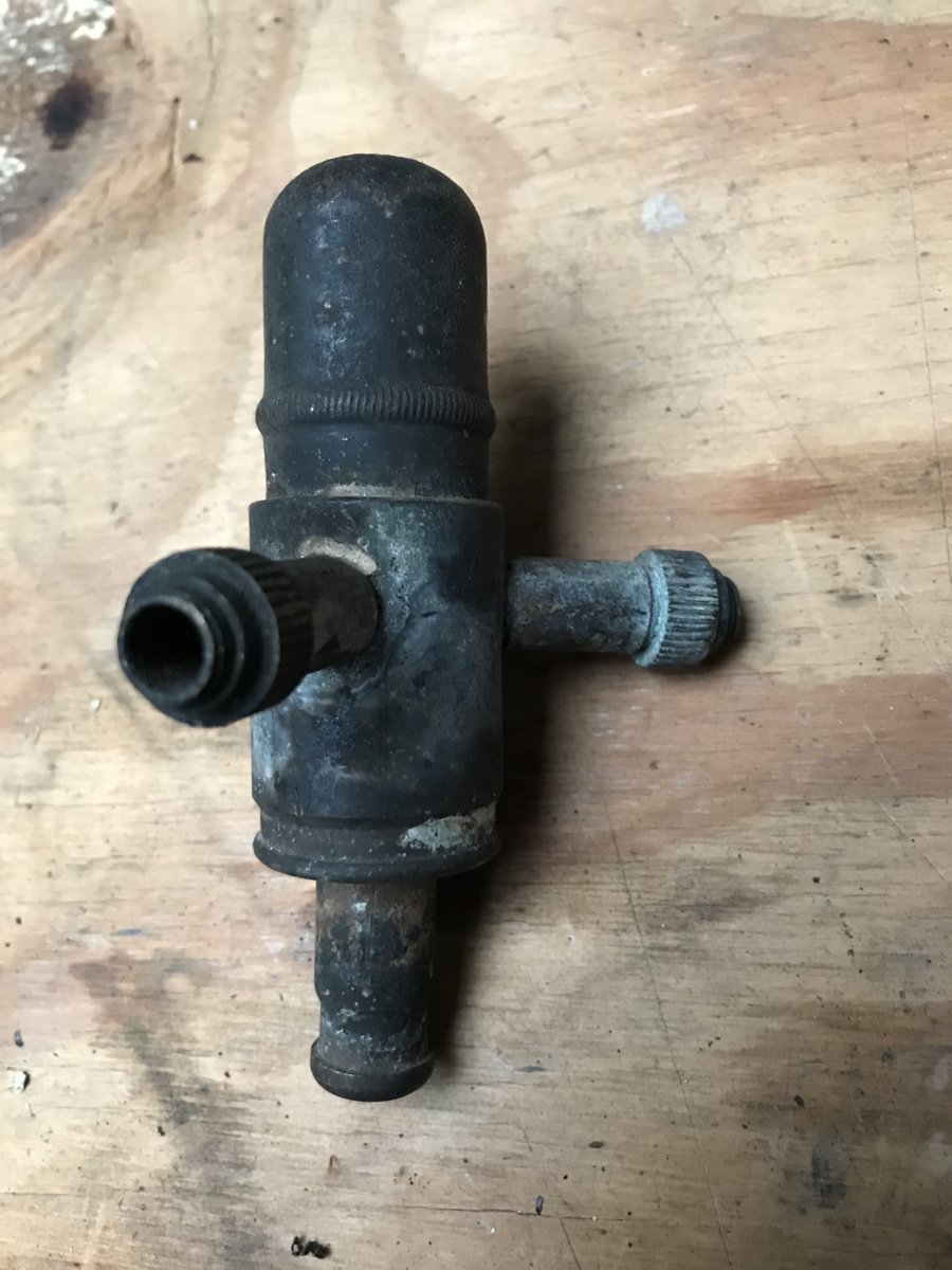

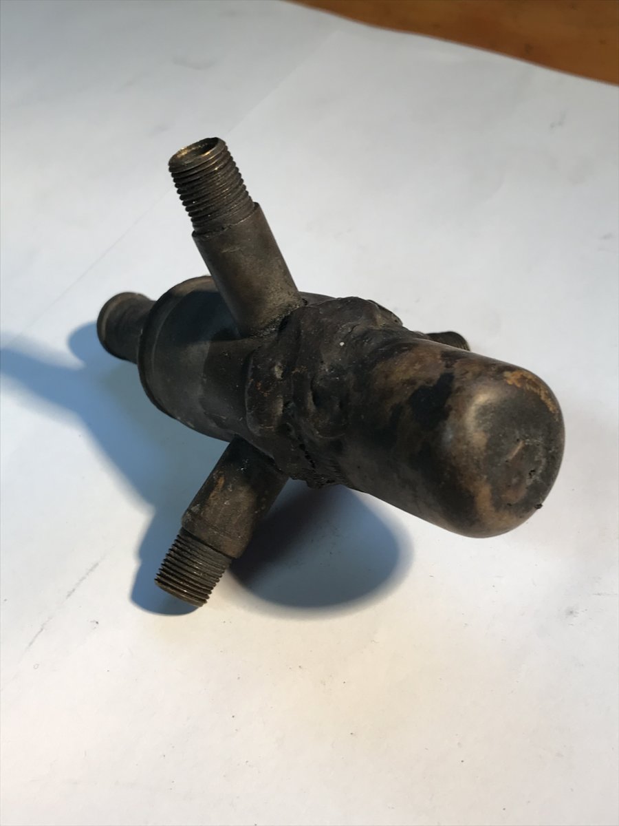

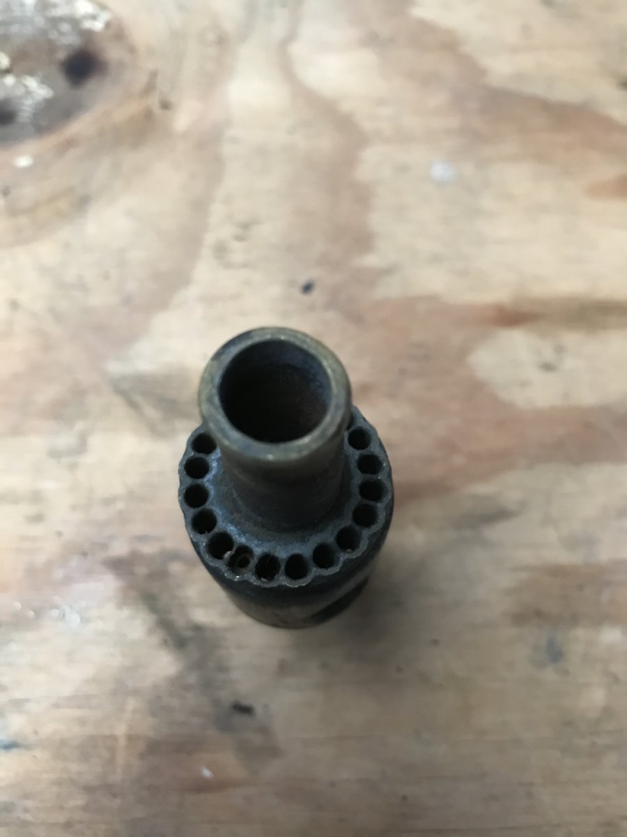

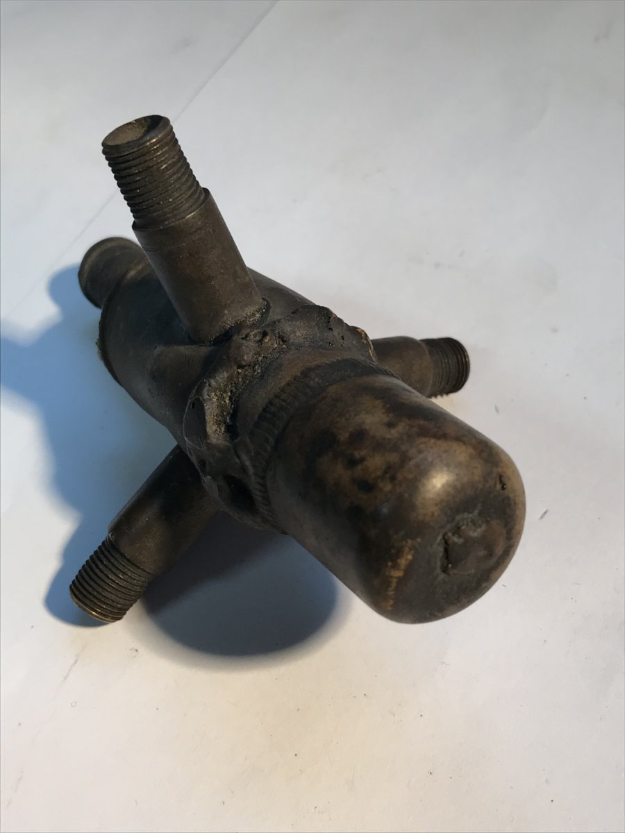

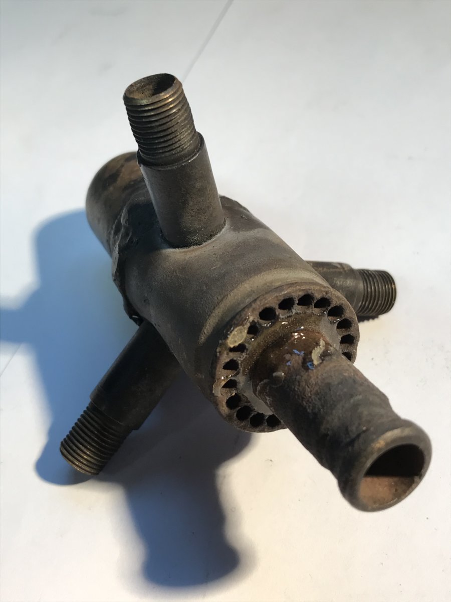

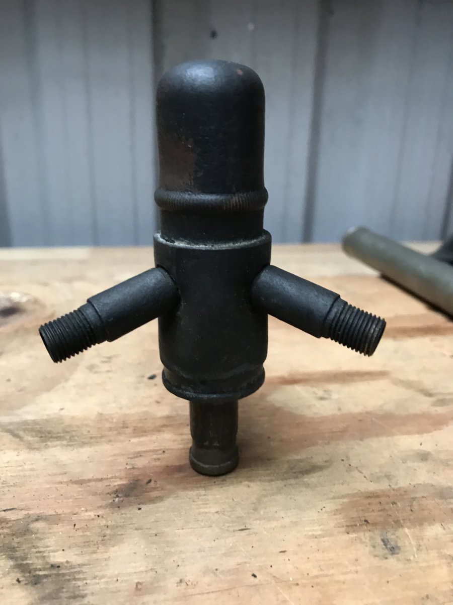

    This burner is from a Tilley X246 Guardsmen found at a Bric a Brac reseller.
    The other side. Note the top of the dome has been eroded and repaired.

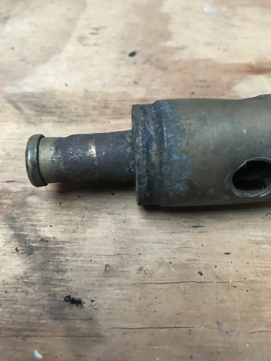

    Now its crowning glory ........
    Epoxy resin to hold in the, no doubt, burnt out thread of the mantle spigot ...... One has to wonder how long it would last if the lantern had been lit, 15 seconds? :shock:

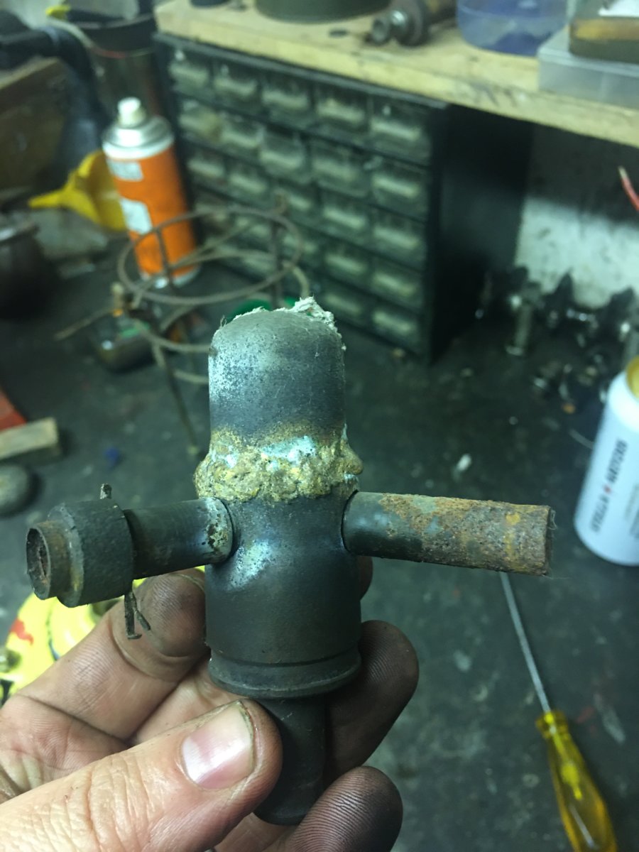

    Here is some exhaust cement on a bowlfire. Still was leaking as you can imagine. A new seal and it is right as rain.

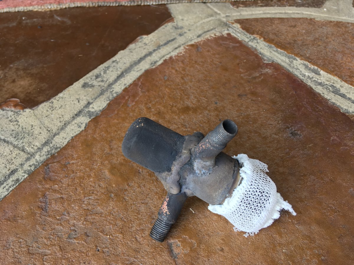

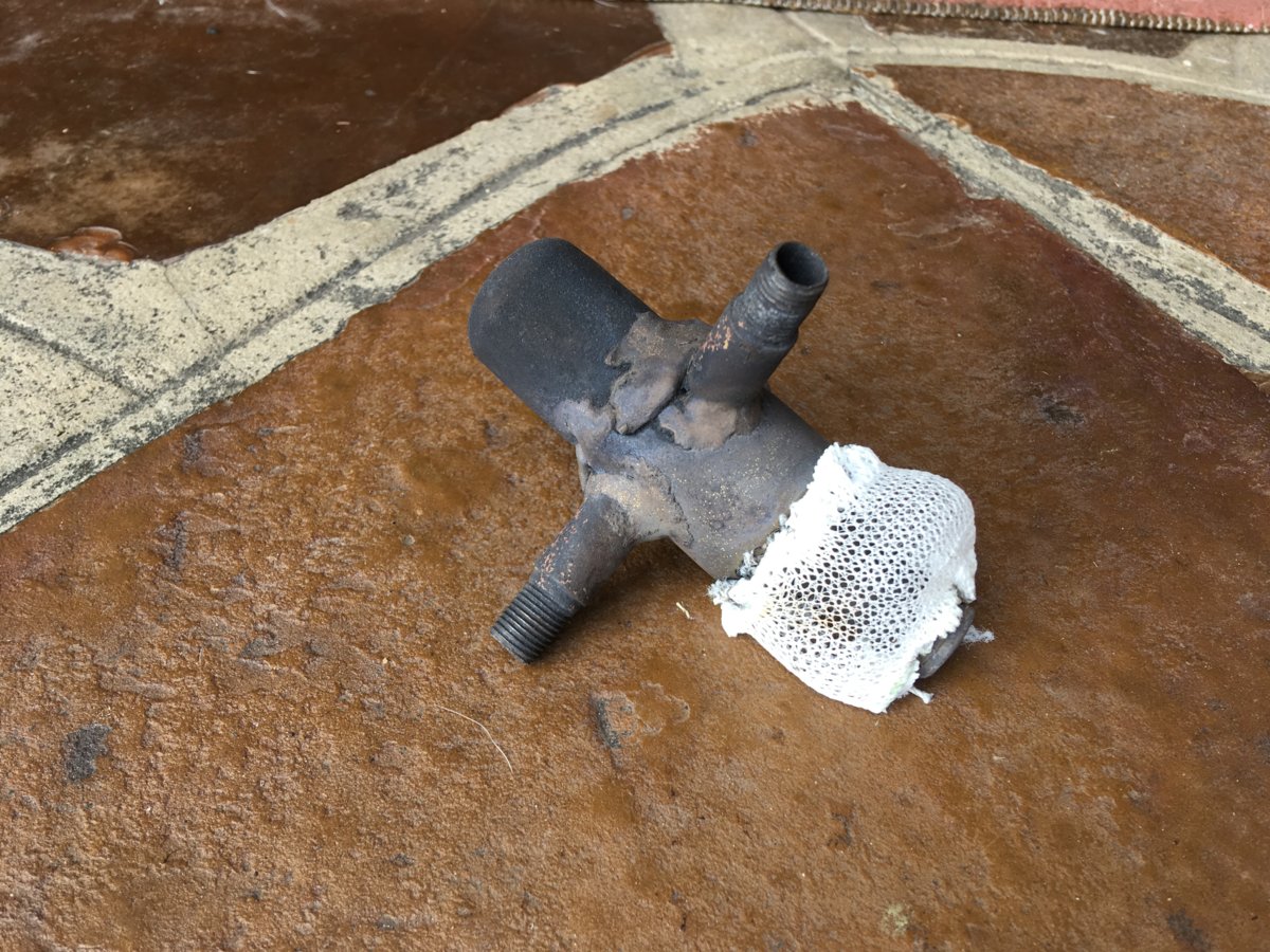

    984B1956-25BD-4D1A-8153-0051B78B1BBC.jpeg EF494289-C6C5-427C-8315-9F571FA4C7A5.jpeg A654B0B9-B163-44BA-A437-BB384644E048.jpeg 9F437030-F556-427F-BC5A-4E20ADA44734.jpeg FBF8003F-8990-424D-95E7-13C2E19DEE9A.jpeg This one works with a halo around the mantle. It was tested without a gallery. The mantle was not top quality.

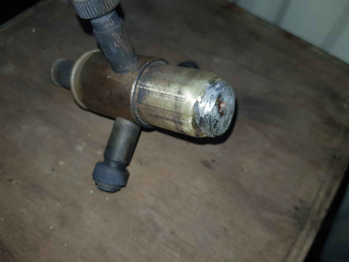

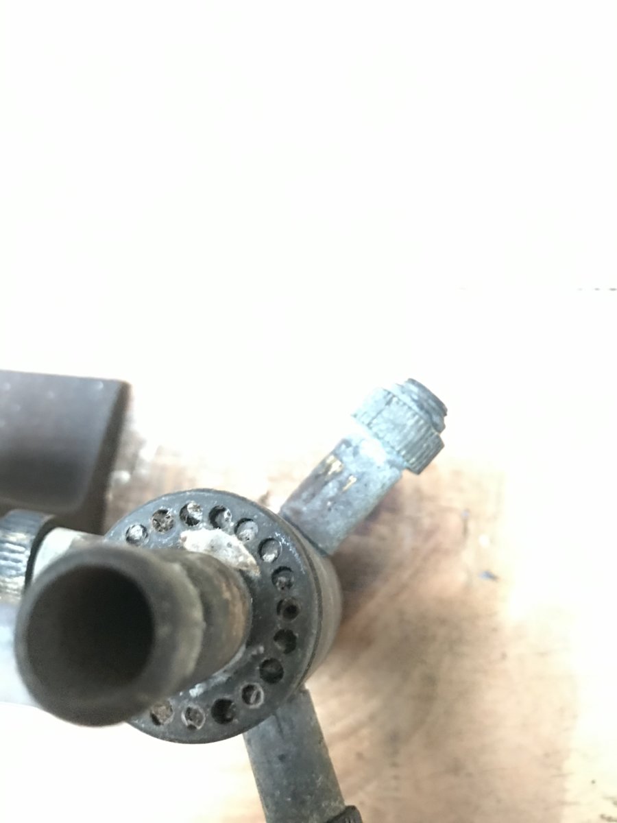

    Pic from the thread that kickstarted thus one. My failed attempt of a burner repair. Soldered a coin over a hole. No success

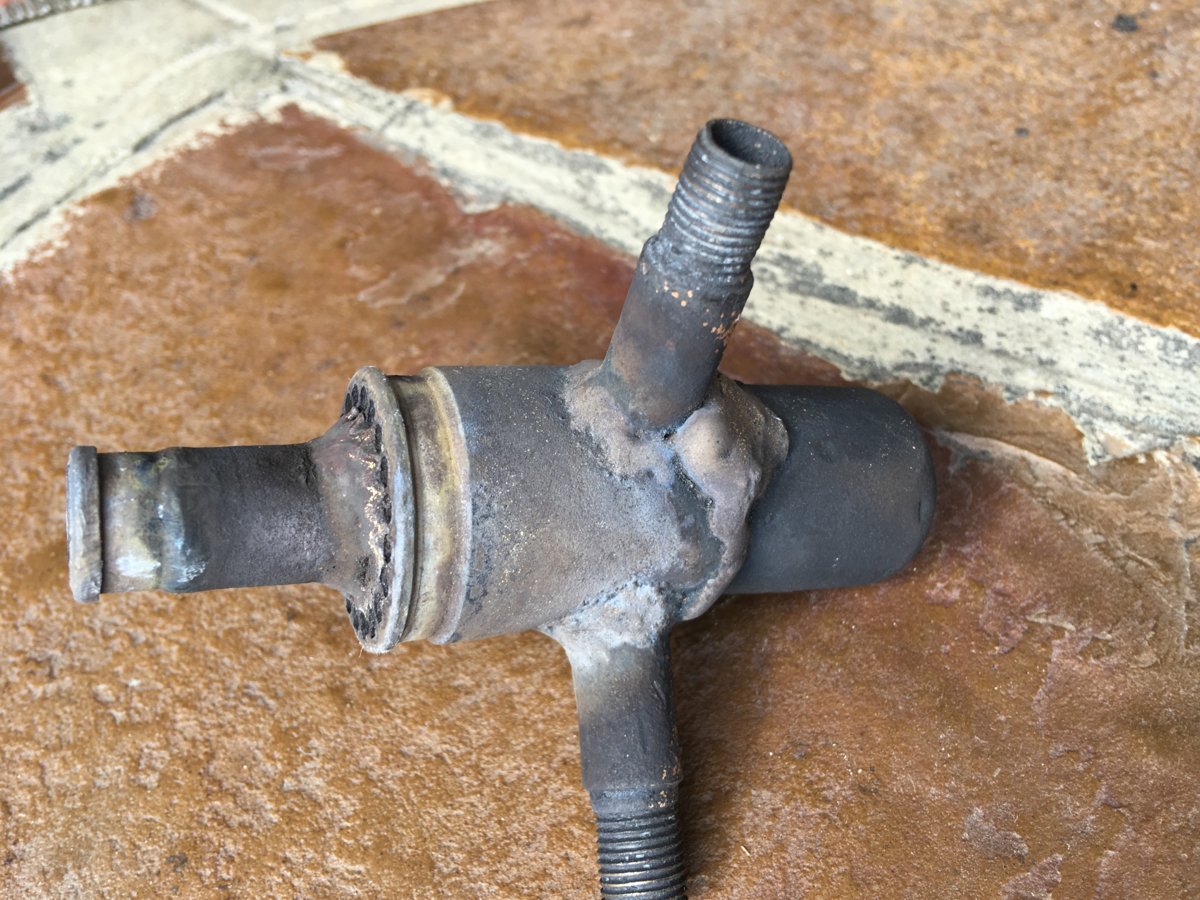

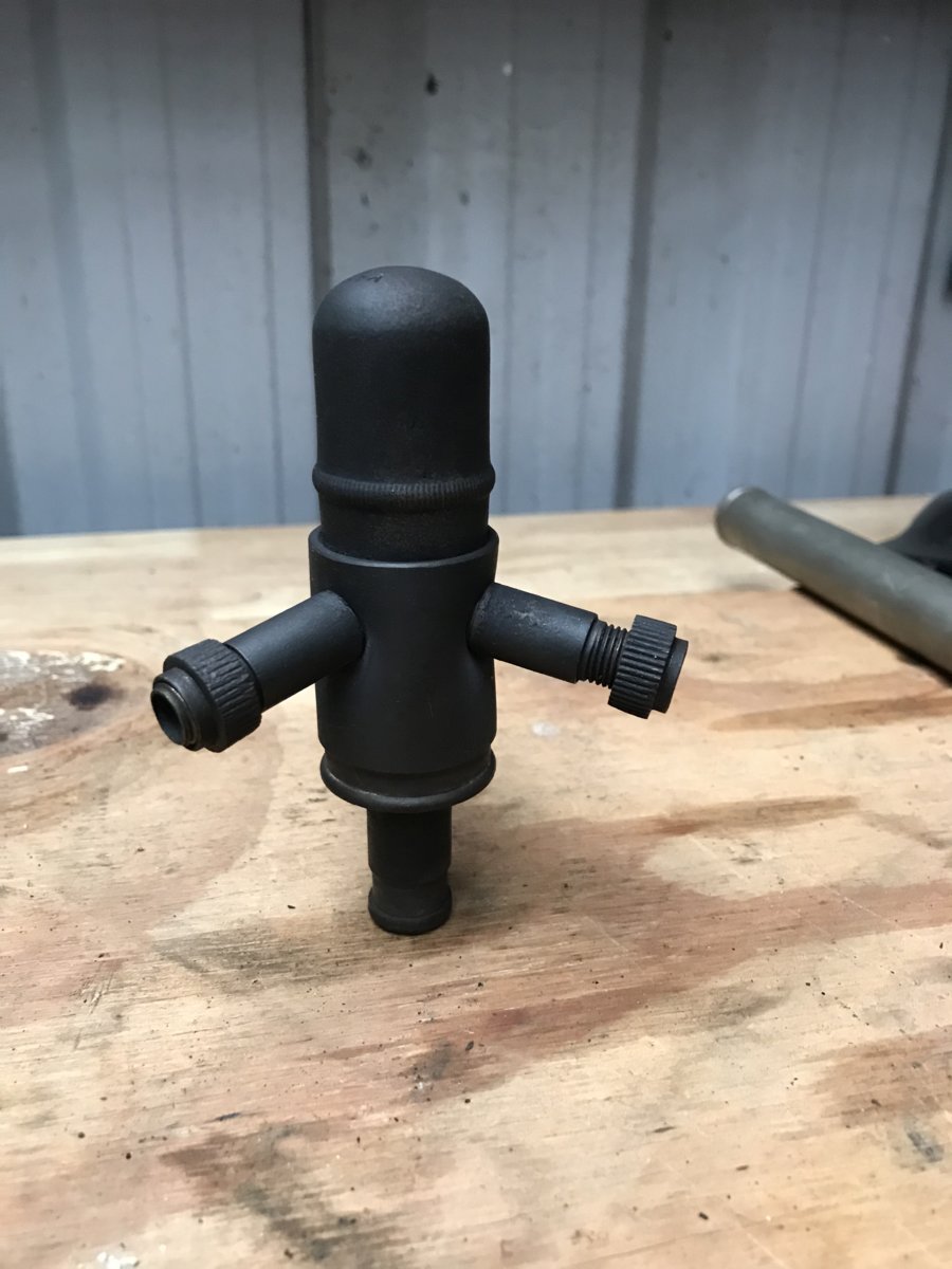

    The main part of the burner body on this burner is almost triangular, and the air tubes have brewer’s droop.
    This example might not be completely wrecked, but it is 85% filled with mud wasp nests.
    This example has severe brewer droop.
    ...as does this one.

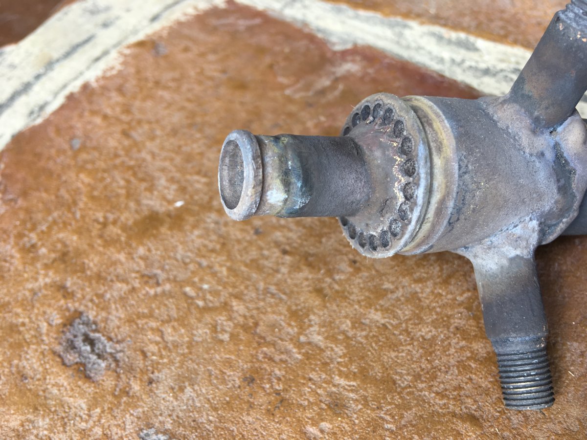

    This burner must have been heavily used in a Tilley heater. There is significant loss of brass on the outside of the bottom of the main body, and the burner holes are very warn and distorted.

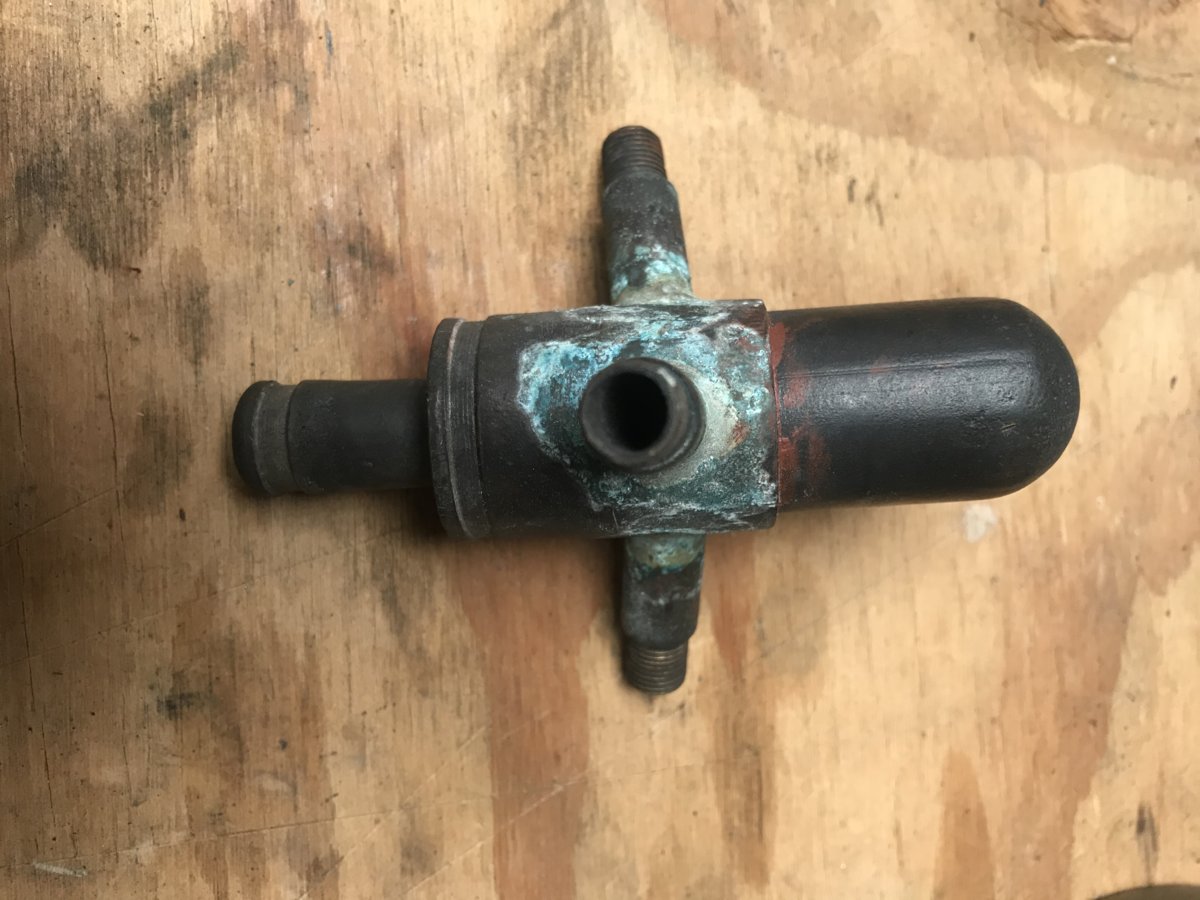

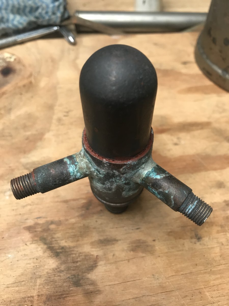

    This one is from Jim Dick’s box of sundry bits. It has been silbrazed at the air tube joints, and the mixing tube is fitted back with muffler sealer.
    When I get the chance I will test this to see how it performs.

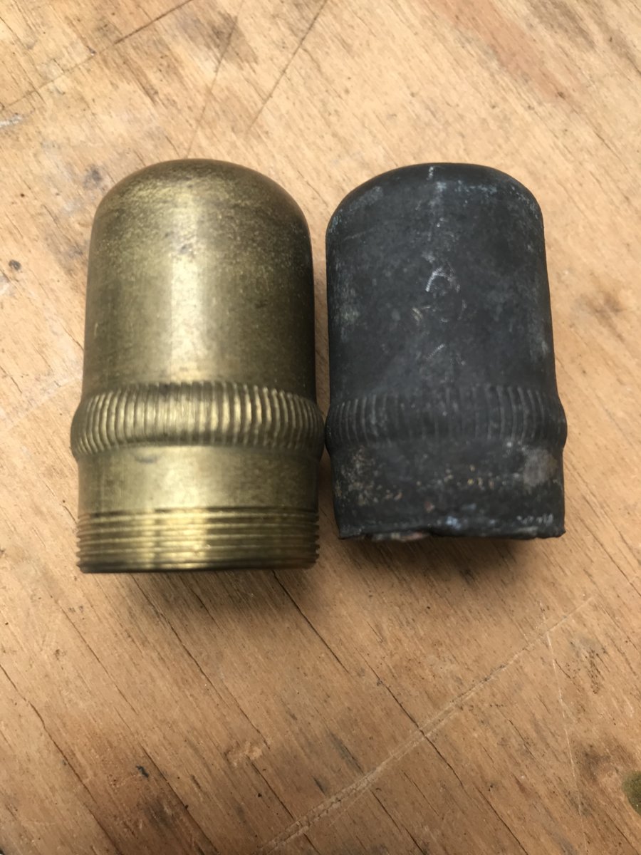

    Here is a mixing tube with its threads burned out next to a NOS mixing tube.

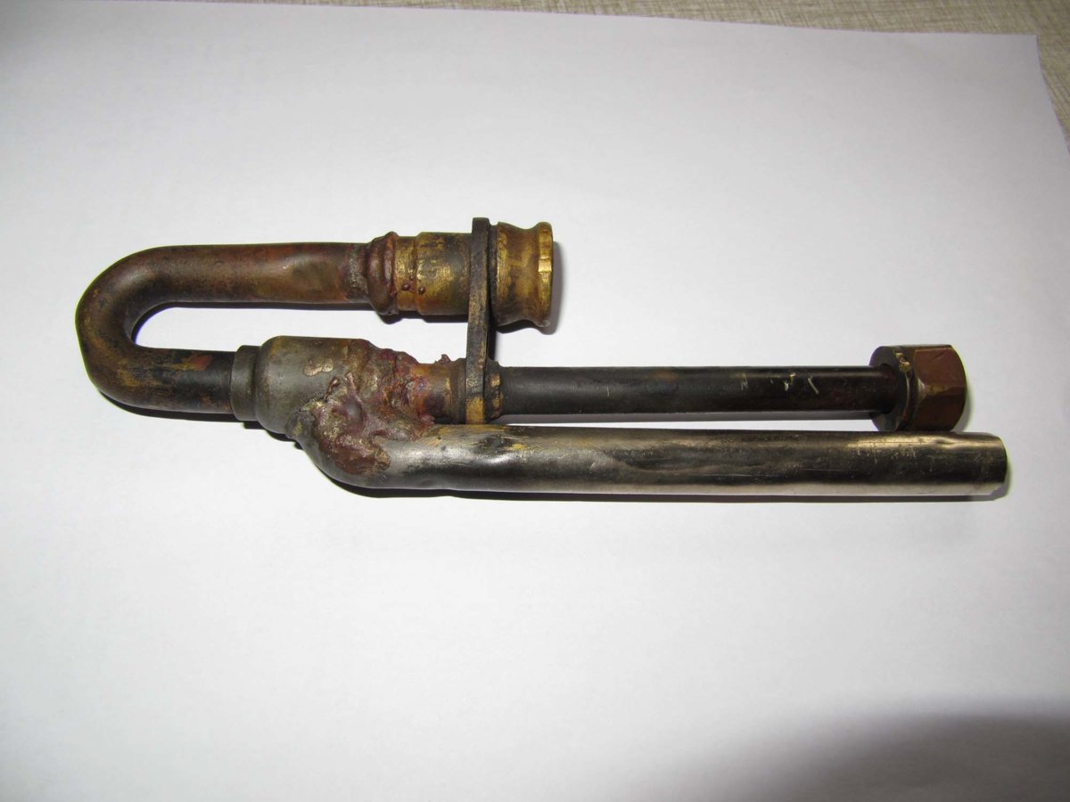

    I don't know what they were trying to achieve, but it has made the burner completely useless. It is from a Primus 991 and has been brazed together. It wasn't just silver soldered, it was actually brazed. If anyone has a complete 991 burner lying around they don't know what to do with, I could give it a good home. :)
  14. Tony Press
    Nils,
    That’s a fine example of extreme fettling.
