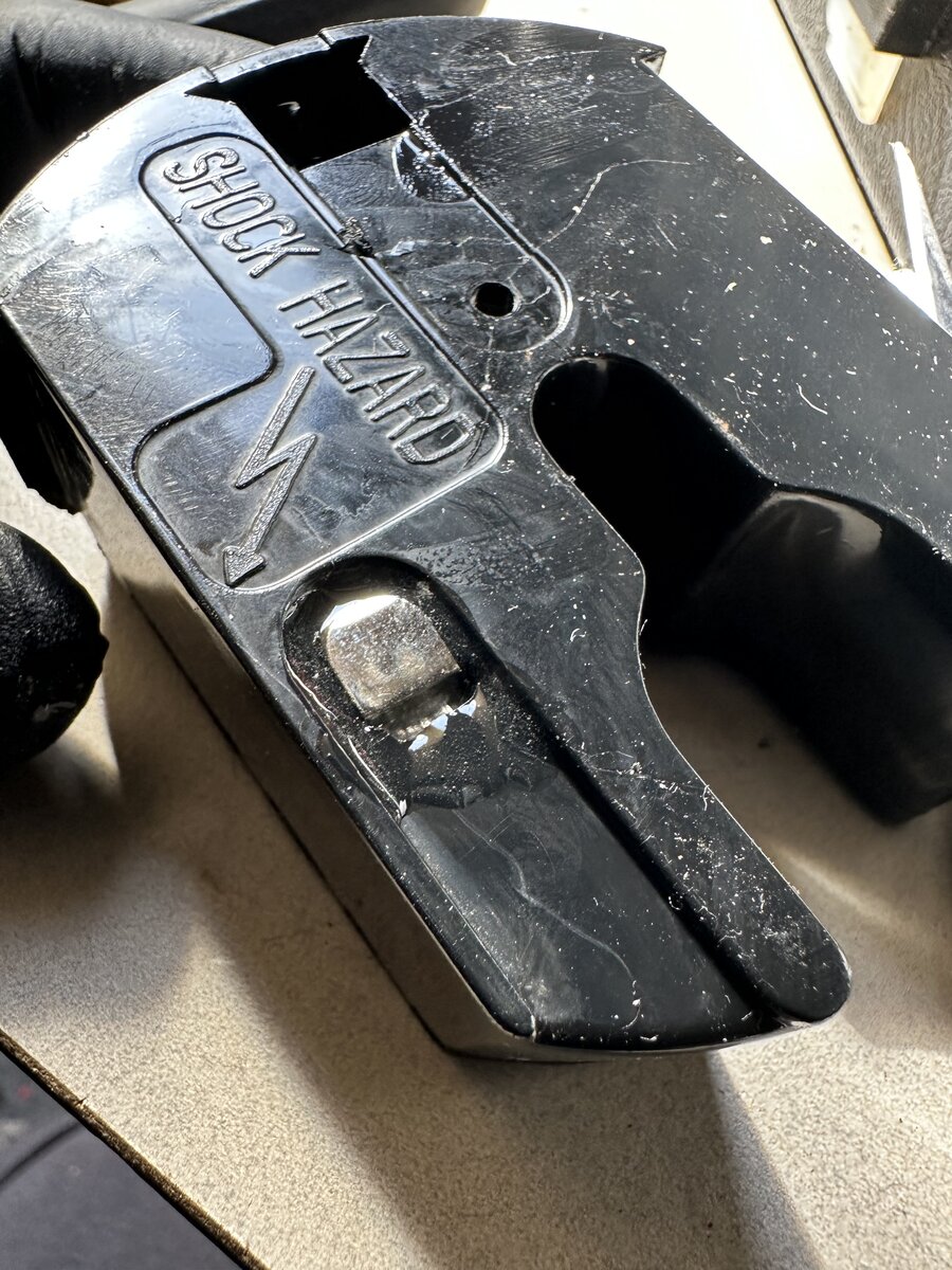

    Got hold of a copy of this very nice condition lamp but later found that the igniter is not working. Took the igniter module apart and studied the hardware and looks like the problem could have been in the design of the igniter module itself that might have been the cause of the faulty ones in the field.

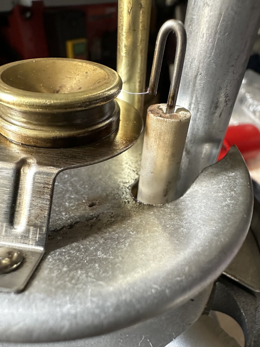

    After taking it apart, I found that the contact from the igniter module is a non-spring contact that was designed for a firm fitting to touch the inner bottom end of the igniter. Any out of tolerance position of the ignition stem to the top will result in a higher force downwards into the igniter module below. Tweaked the bottom end of the igniter to ease off the force.

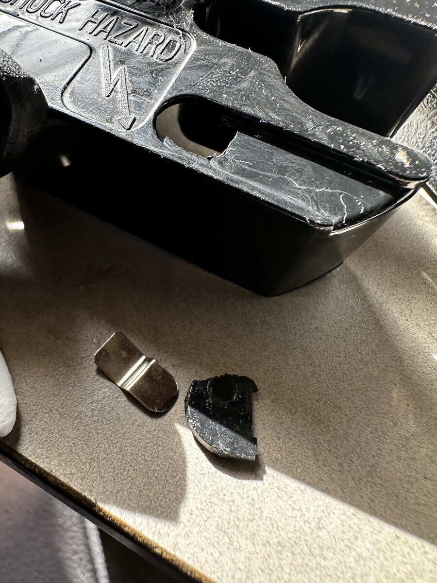

    On this particular unit, the contact point was actually cracked into pieces with the force - probably after some time. The whole shell of the module could also be better if was thicker. Cracks were all around the module - maybe due to the external forces that were subjected to it.
    Manage to pick-up the pieces and put them back together and use superglue and also two-part clear epoxy to fix it back. Reinforced the cracks all around and get them back in shape.

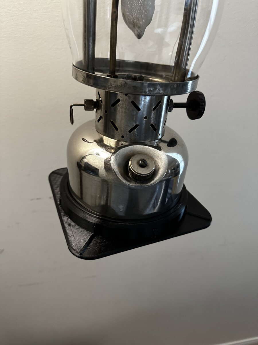

    On the side - I was quite impressed with the rubber base protection on the Coleman Northstar 2000 and rigged up one and 3D printed for the Coleman 236 and was happy with the result. Definitely helps to protect the fount and also avoid hard knocks to the other lamps.
