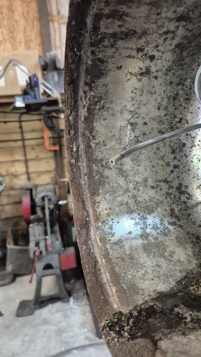

  7. Sploosh33 United Kingdom
    Jan 16, 2026
    53
    Devon
    Proceeded to cut the bottom off and take a look at a proper repair. What started as 2 or 3 pinhole in a seemingly solid tank actually had this inside. As you can see, very very little left of any kind of solder joint!
    A good warning that patching and plastic tank linings don't take away the risk of a blowout. This one was just waiting to be a fireball!

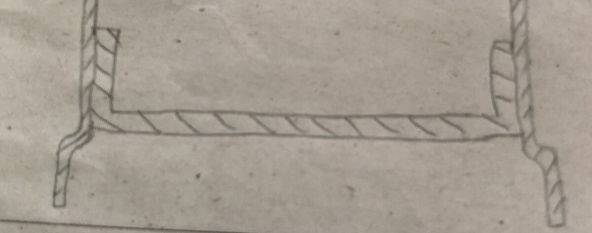

  10. podbros
    4,096
    Was it the later profile with the inverted base plate or the earlier type?
    some of the pig heaters used the same sized tank but quite a bit of alterations needed
    making a new base plate and inserting it like the old ones would get you going while hunting for a spare??
    excuse the sketch
  11. Sploosh33 United Kingdom
    Jan 16, 2026
    53
    Devon
    Hi Podbros, your sketch is exactly what i had planned. The easiest and safest way of having a structurally sound lamp again.
    I don't have any pictures yet, but I'm using a thicker steel plate and have brazed a return around the edge to create the "upstand" part. Hopefully over the next couple of days ill re-tin the inside of the tank and get the new base sweated in. Hoping to put the original rolled section back on the bottom too so it looks correct. A lot of work, but worth it to save another lamp from the scrap/doner bin!
