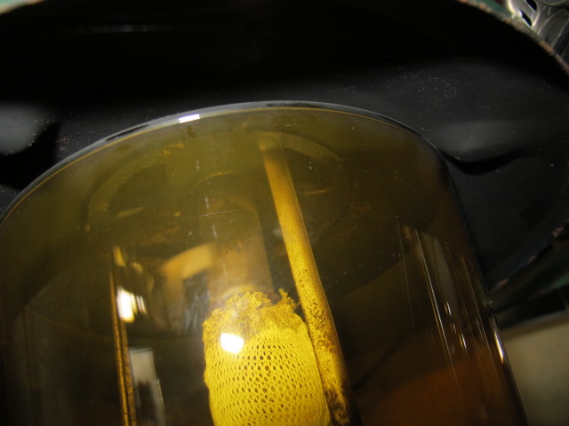

    Here you can see a 275 globe in a Thermos
    Hope that helps
