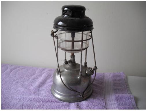

    Saw this on eBay and gave into the minimum offer ($49.99). I guess it's mine now! I've been waiting for one of these "classic" models based on the discussions regarding the more contemporary offerings from Tilley. It sounds like it will need a new globe, but that can happen in time...
    I MUST STOP for a while since the car needs new brakes! :doh:
  2. Carlsson
    3,966
    Don't mind the car! As long as it runs, it's OK. The brakes are secondary, and to spend the money on an old Tilley instead only show good sense of priority. :lol:
    It looks good, that old Guardsman, from what you can see on that image.
    The hood looks like it's unusually well preserved.

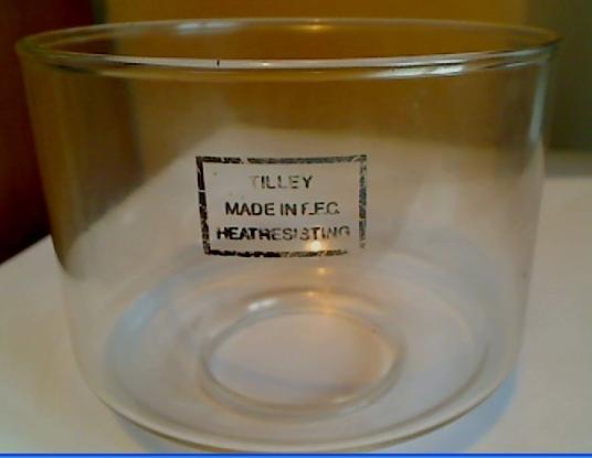

    I just picked up a 171 globe from a seller on ebay.co.uk, so now I just wait for boxes in the mail!
    Can you tell me what the "Made In ???" is about?
  5. Wim
    Wim Subscriber
    926
    Dendermonde, Belgium
    That will most likely be the E.E.C., the European Economic Community.
    Best regards,
    Wim
  6. David Shouksmith
    Made in E.E.C. refers to the European Economic Community.

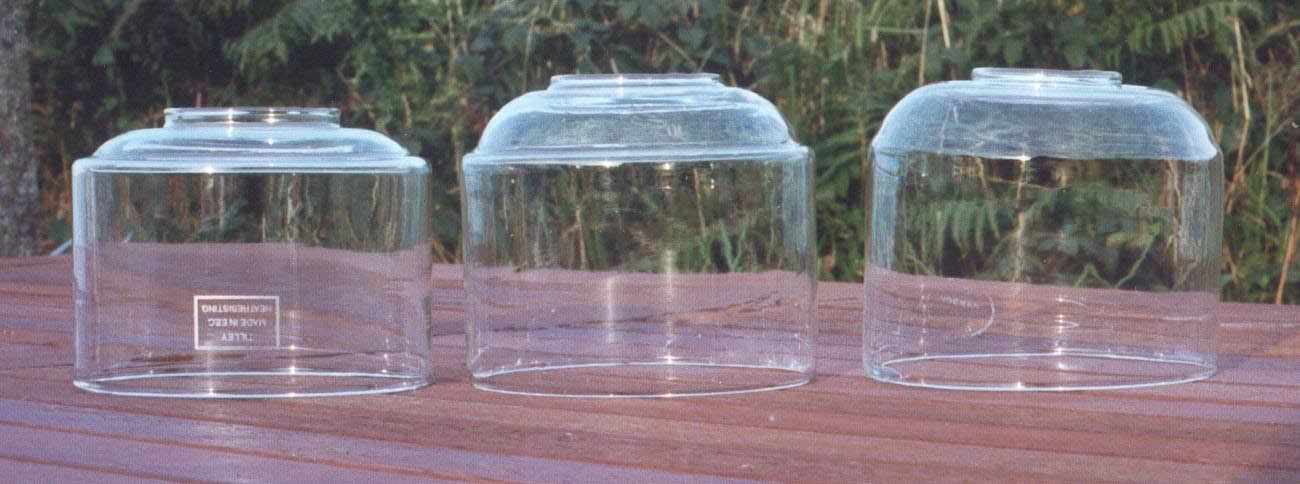

    Although that globe will fit and work perfectly well in your X246 Guardsman, it isn't the correct one for a lantern of that age. There are three different versions of the Tilley 171 globe which have a different depth 'dish' at the bottom. Earlier lanterns such as yours came fitted with a deep-dish globe. Later lanterns came fitted with a shallow dish globe, which your replacement almost certainly will be.
    Neil has shown a nice photograph of the three globes side-by-side and I bet it's on here somewhere. Beyond that, I've no idea of the exact dates of issue of each of the three types or what model(s) they were fitted to...
    Edit - I see I've crossed with Wim's post - I should learn to type quicker..!
  7. Neighbor Al
    Nov 21, 2011
    1,062
    Russell, PA United States
    I noticed that, but decided a functional globe was better than no globe at all for a beginning. I'll be keeping my eye out for a globe that better represents the age of the lantern.

    Here's my version of it:-
    Earliest on the left; latest (EEC) on the right. There's not a huge difference between the one in the middle and the one on the right - you really need to see them together to make the comparison. There is, however, a marked difference between those two and the early one which can be clearly seen in the image.

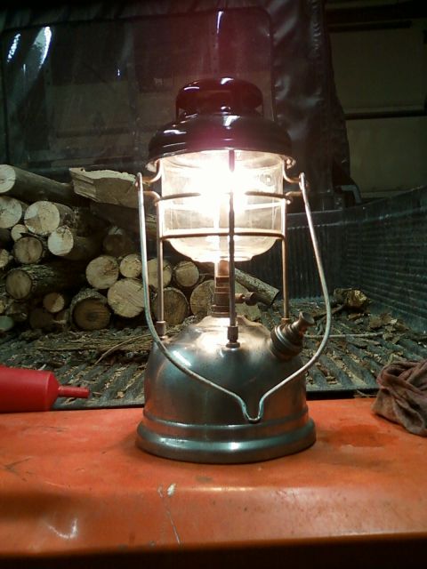

    The X246 Guardsman has been revived! (I can't call it "restored" since there is a lot of polishing to do still.)
    The SP1 gasket kid did the trick with the new pump leather and gaskets to keep the pressure and fuel in the pump. A normal pre-heat, a wiggle or to of the jet cleaner, and FLAME ON!
    Very happy. I'm waiting for the EEU globe to arrive so that I can put the cracked-but-original globe out of harms way.
    Photo of my latest baby:

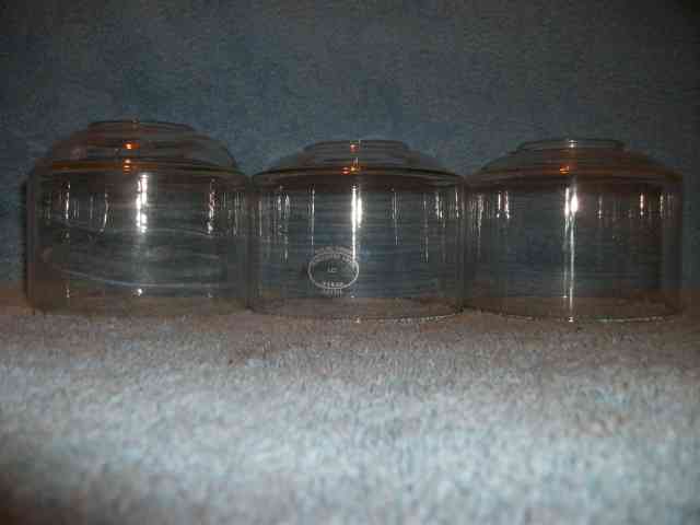

    I have 3 stiles of 171 globes. The one on the right is probably the oldest. About 1946 - 1950. Hope this helps.
