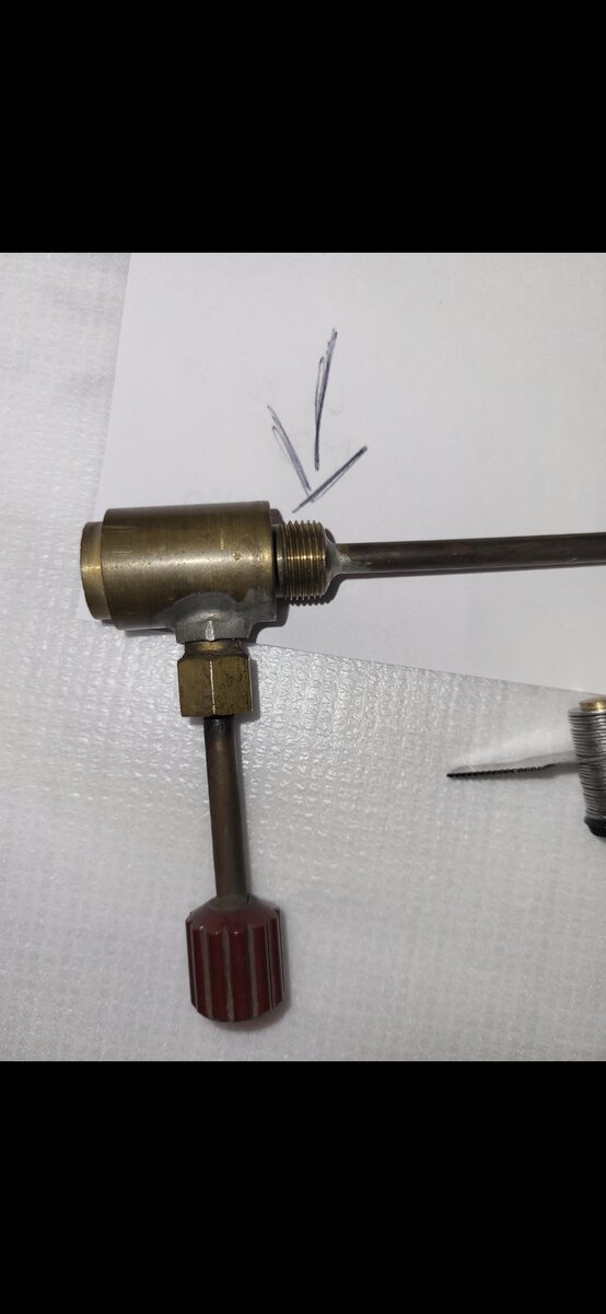

    Hello, my name is Sven and I'm new to this forum. I would like to know what kind of thread this is in the photo.
    Can someone help me
    Thx Sven
  2. Sooty
    Nov 18, 2014
    61
    Horsham, England
    Hi Sven, and welcome. I'm relatively new as well. Sorry I can't help on the thread except that it is unlikely to be a modern metric thread because of the age and origin of the lamp. There were several different UK threads in 'the olden days' with strange names like Whitworth, AF, BA and many others.
    I have seen a fascinating tool called a thread gauge that has a number of blades, each with a series of teeth matched to specific threads, that enables you to find the exact thread for either a nut or a bolt but I don't have one.
    I guess that is a long-winded way of saying "I don't know" in answer to your question, but I'm sure someone here will know exactly.

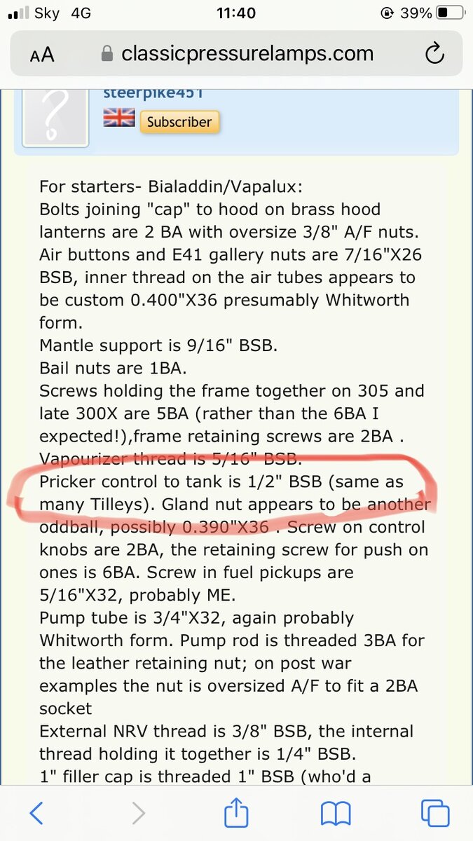

  3. podbros
    3,997
    Hi Sven !
    i found this after a quick search
    hope it helps @Sven
    cheers
    pb
  4. Sven Germany
    Dec 27, 2025
    2
    Perfekt thank you
    Now I need to see if I can find an affordable tap for it in Germany.

  6. Sooty
    Nov 18, 2014
    61
    Horsham, England
    Thank you podbros. I've just printed out the original post and filed it with my other lamp papers for future reference.
